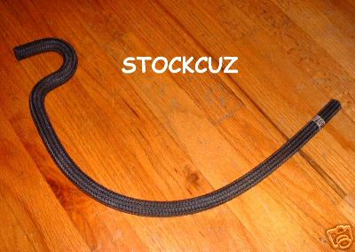

Hey Kent I may be able to shed some light on the fuel leak. There is a vent hose that runs of the back of the tank up behind tail lights into a 't' piece and to the filler neck. The plastic 't' pieces and notorious for getting brittle as are the braided breather hoses.
Mine did this also when filled above half, I replaced the hose straight away. There's something very disturbing about seeing your newly bought Z sitting in it's own fuel puddle after filling it for the first time  :o you'll be able to see it pop up through the floor behind the right tail light, and has cloth braiding. If its rock hard it needs changing.

Gareth, i will check this out first thing on the weekend. Was the hose one that can be replaced easily with generic hose? or is it one of the funny shaped ones i have heard about?
Thanks all once again
Kent
Yep it was one of those funny shaped ones with the cloth braiding, I got mine from nissan but can't remember how much.
I believe this is how it looks (it's on ebay) gas tank breather hose.
