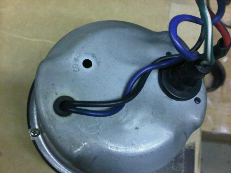

maddos Posted March 15, 2011 Posted March 15, 2011 Think they have a + - adjustment on rear to adjust speed. Can you get at it from below after removing fan vents like the 260's? Quote
Gyra Posted March 15, 2011 Posted March 15, 2011 Easy to adjust, there's a screw in the back under a little plastic cover. A spare clock in my parts box is marked with S and F - slow and fast I guess! You might be able to reach in with a jewelers screwdriver while the clock's still in the dash if you have really small hands! It'll take a few adjustments to get right again though. Gaz Quote
wildy55 Posted March 15, 2011 Author Posted March 15, 2011 Thanks for the pic. Unfortunately, I have hands that could span the harbour bridge so looks like it'll have to wait until all of the things needing the dash removal have their day in the sun. Quote
