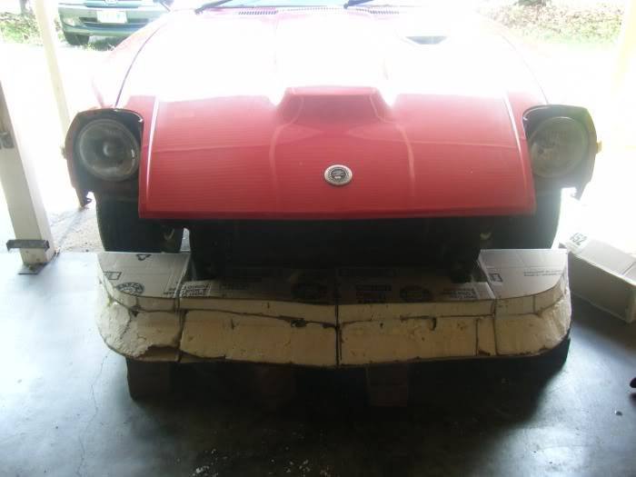

Carved out the bottom lip pretty much completely (now ready for plaster)
Ran into a little problem..

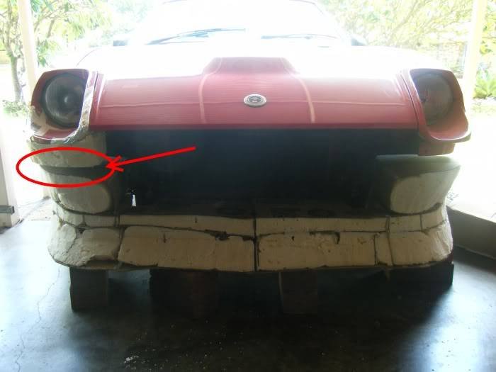

Soo

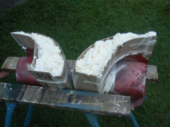

Ended up doing the fillets just under the headlight buckets (should be a more perfect mold of the underside of the buckets. the original that we made back in day one were pretty dodgy, learning experience :) )

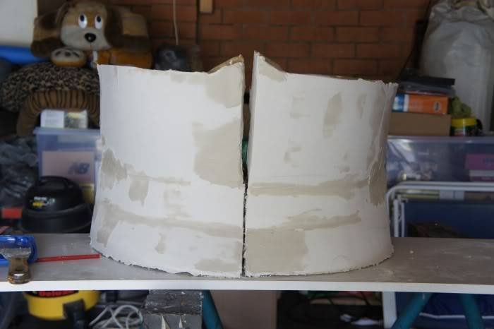

From the last updated picture ^ It's pretty obvious that there are a lot of low spots/high spots/wrong lines. We put a string on the middle crease just to see how we we're going.. We weren't lol.
We decided to split the air dam again.

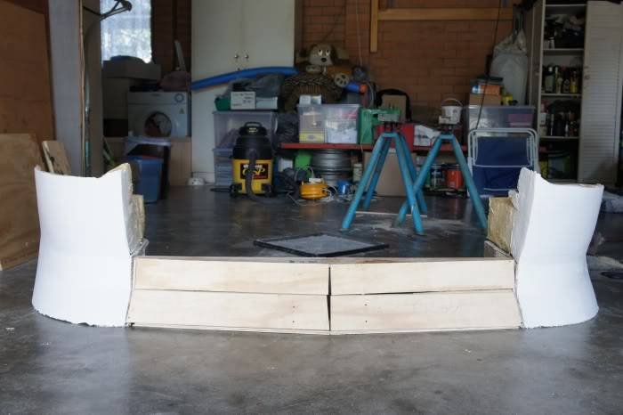

The sections below the headlight buckets were surprisingly similar, after a bit of sanding and some extra plaster they weren't looking to bad

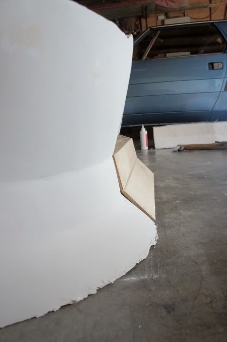

The middle section = preschoolers paper mache project so we axed it and decided to do something sensible and opt for something with more strength and straight lines.

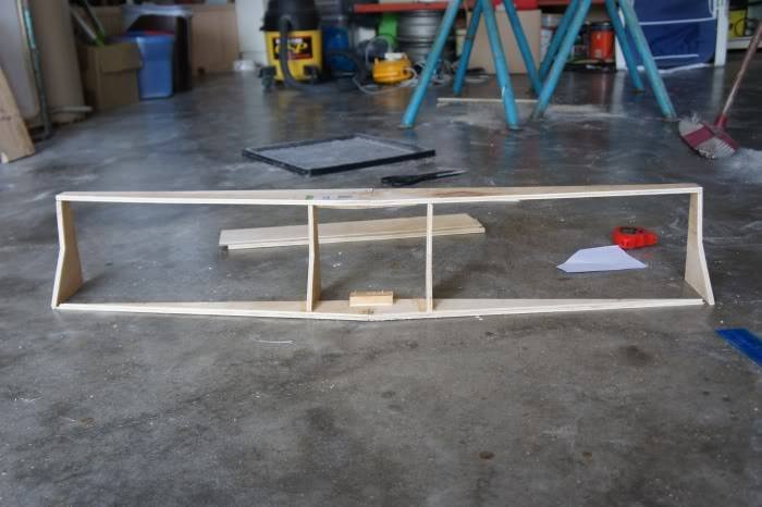

Sexy wooden frame.
Apart from a few bodgy measurements and a the top edges angle of 10 degrees turning to 14 it turned out fairly nicely.
Follows all the lines awesomely

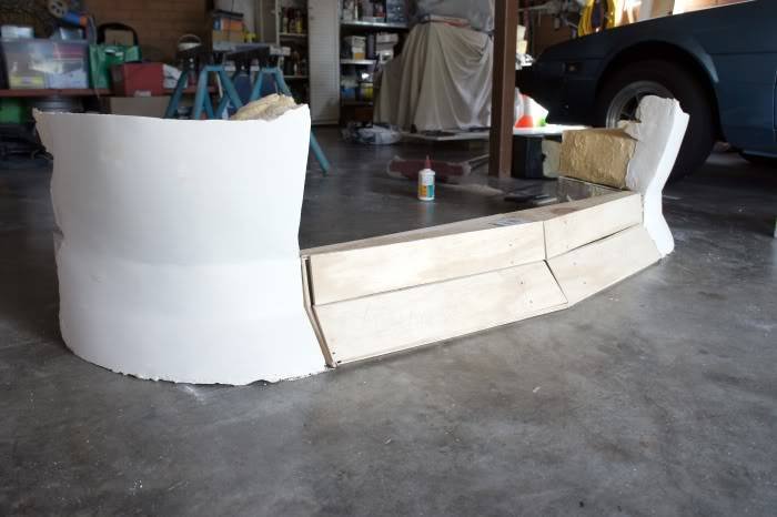

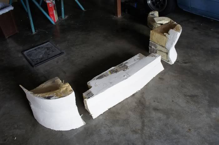

to make it easier to handle/work on the 3 sections are going to be done separate and bolted/bonded together when its all glassed up.
The middle section after a bit of work filling in the gaps and making smooth should be moulded and glassed shortly  8)
Only thing thats missing now is the Z. Hopefully I get that up and running again soon, Driving a kei car isn't the same lol

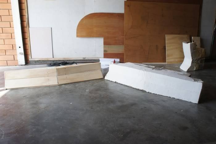

Moral of the story is its easier using something that already has a flat edge then to try and sculpt one yourself.
and it only cost $6 for the wood lol
The new middle section is about a third of the weight of the foam and much more sturdy. Great success
