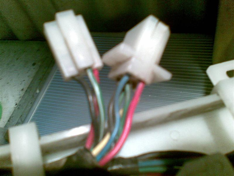

Do you know what color wires the 260z volt gauge runs? Is it big white with red trace(+12v), earth, then light?
I've got the wiring loom right here It has two plugs for that gauge
Three pin plug
Green/ white stripe
Black
Red
Six pin plug
Black
Green
Blue
Green
Yellow
Red/ Blue stripe
Gareth, what I did on Fu's car was when I removed the amp/fuel gauge, the large white/red wires that run through the amp meter I just joined together and at that connection, attached the positive wire for the 260's voltmeter. The negative just find a good earth and bolt it to that. For the loom on the volt/fuel gauge, just swap the one from your 240Z to the 260 fuel gauge. It should be straight forward.
