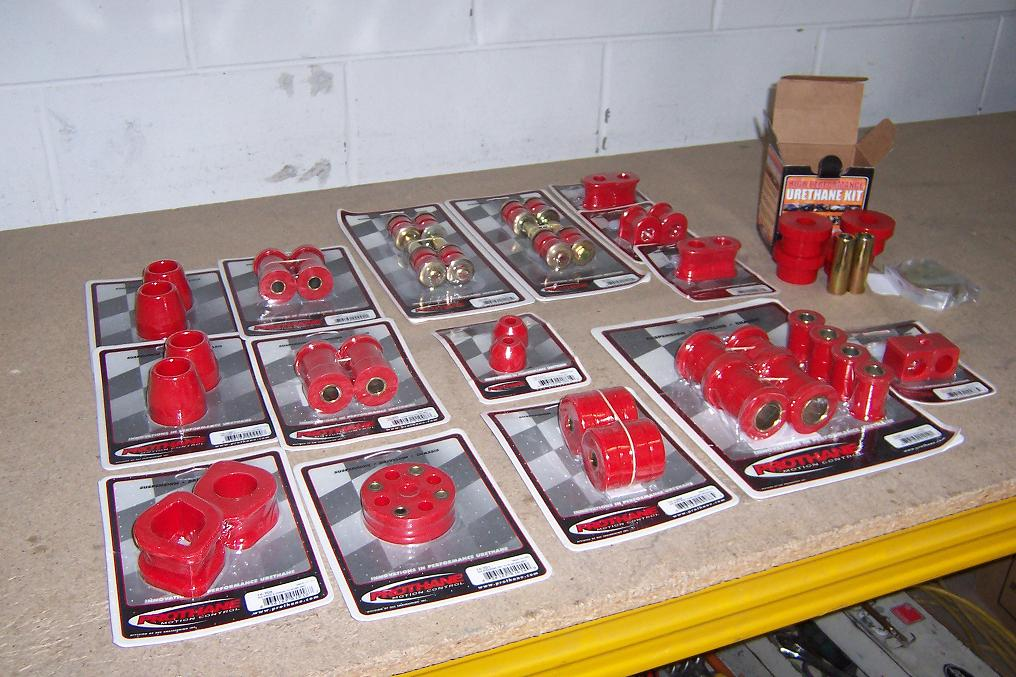

drifta1600 Posted August 10, 2010 Posted August 10, 2010 hi all, just thought id show you all the bush kit i got from USA for 260au including postage. took 7 days to get here. very good quality, and the fit in awesome! here's the guy i got them off - http://motors.shop.ebay.com/zpartshouse/m.html?_nkw=&_armrs=1&_from=&_ipg= ZPARTSHOUSE great fella, help me save on postage, just ask! Quote

drifta1600 Posted August 12, 2010 Author Posted August 12, 2010 Is that the Nothalane kit I was looking at that for later down the track meant to be awesome let us know how the car feels after you have it in. will do, its gona be stiff thats for sure! even with out driving it, the steering feels a hell of alot stiffer from the steering rack and the steering rod/shaft bushes! i look farward to driving it, got to get the motor in tomorow :-) Quote
