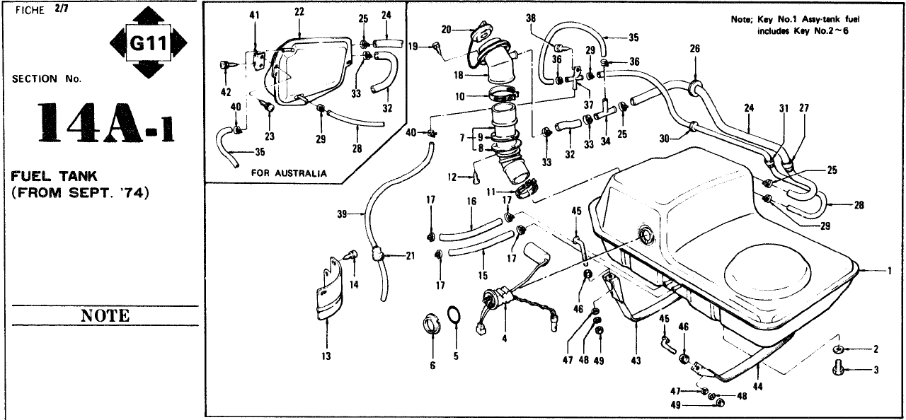

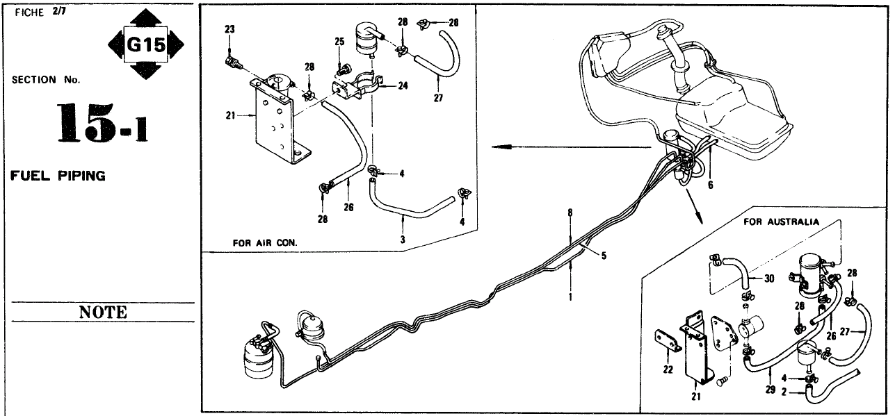

Ok I am a pic type of guy. So this is from the factory parts manual.
Number 1 = fuel feed line
Number 5 = fuel return line
Number 8 = Tube Evapo (Australian spec model only)
So are you talking about number 8 and then I also assume your car is a 260z and has the evapo unit on the size next to the fuel filler - again Australian spec model only
If it is number 5 - some people just block of the return when running triples - pump the fuel up and leave it there until you use it all :)
If there is no RWC issues then removing it should be good but as I am not based in Australia and don't understand your local laws about pollution regs just make sure you can remove it from your zed and keep it legal (I understand someone has removed some of it already, but Nissan has added this stuff to the Australian specs cars for a legal reason I assume)
I hope these pics help a little and if you like (as I am still off sick) I could colour all the bits that are on the Australian Spec so you can see what can be removed (if legally allowed that is)
Cheers drugged up Mike

I am quite sure that would number 8 the evapro line (runs into what would have been the charcoal canister?)
So I guess I will remove it and let the tank breathe. Yeah, it would have had it form factory (I assume), but was removed a few owners ago...
