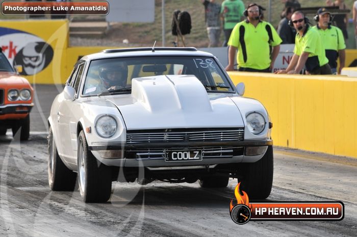

Raced the car at calder easter sat and couldnt get it to launch off the line,had heaps of fun with a best time of 11.7 at 118mph.After getting home and refitting exhaust took it for a spin and noticed the dredded rear end clunk.Put the car on stands and looking under the car while running in gear noticed the front of the diff pushing up, I broke the front diff mount.Now I wish to change the whole settup moustache bar,front mount etc.I have noticed some discussion on this topic and wondered the best and easiest solution.Looked at arizona z car bar and solid front mount and a kit by modern motorsport.The mod motor kit looks better saying it is used on 10sec zeds and I beleive is steel at a cost of $500us plus freight.The arizona is alum and dont really want to run a solid front mount,but looks awesome.Is anyone using either or is there anyone in melbourne who can help with this problem.
