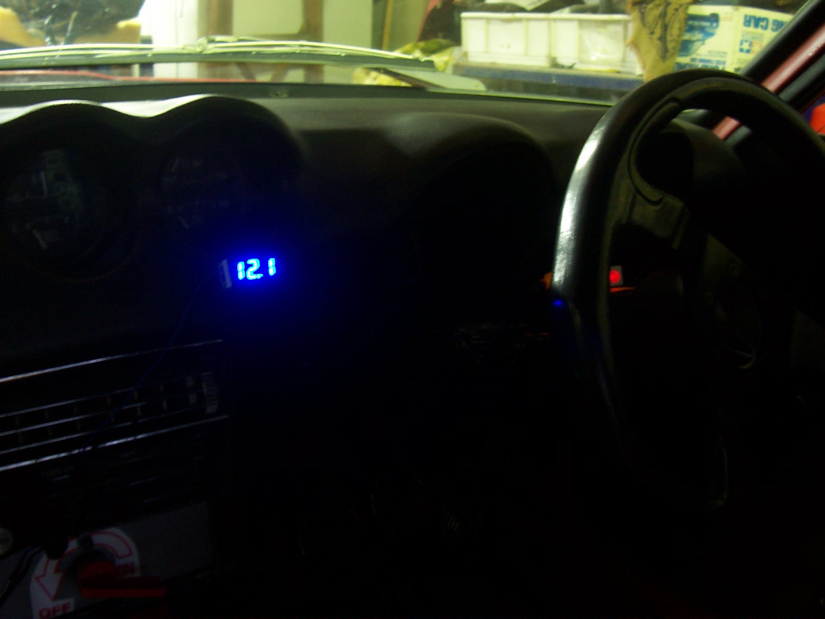

Moderators Zedman240® Posted February 21, 2010 Moderators Posted February 21, 2010 If you have a 240Z with just an ammeter, a display of volts would be nice to tell you how good the alternator is. You know how healthy it is by the volts. Anything under 13.8 or so and you should start having a good look at it. Also, anything above 15 volts should get you panicking! I remember a while back wanting to fit a digital voltmeter into the zed and after some searching, cheapest one I came across was from Jaycar at about $65 (in kit form). On one of my searches through epray, did a search for "LED Voltmeter" and I found some nice blue coloured LED 2 wire voltmeters for only $15. After another search, found some LCD ones for about $10 from Honkers. I bought one, installed it and took a pic at night of mine, it didn't turn out the best but it gives you a good idea. It really needs a small jiffy box and a front tinted lens to look real nice. Or even install it in a gauge and mount it. Anyway, just in case anyone was thinking of where to get one... Quote

RB30X Posted March 6, 2010 Posted March 6, 2010 Do you have a pic without the light on, or a day time shot to see where its mounted and what it looks like? cheers Quote

620Z Posted March 8, 2010 Posted March 8, 2010 I have asked if they have one with a Red Led display. If so I will get one. Quote
Moderators Zedman240® Posted March 8, 2010 Author Moderators Posted March 8, 2010 If the red is not available, you can replace the LED display to a red one sourced locally. Just a matter of de-soldering the blue display and soldering on the red one. Quote
620Z Posted March 9, 2010 Posted March 9, 2010 Ahhh glad you told me Dimitri as they only have blue. (He got back to me) So it doesn't have a blue panel then? Just lit up by the light? If so I might have to order one and give you a yell when it comes in. I am still waiting for my push button start. Should be a couple of days now. Cheers Quote
Moderators Zedman240® Posted March 9, 2010 Author Moderators Posted March 9, 2010 These things are the same as normal LED's but grouped together in a housing. You can get red, green, amber (with some difficulty) and blue. I may have a green display, as they used to use them in old PC cases to display the cpu speed in the 90's. Quote
