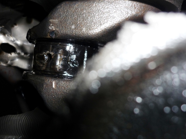

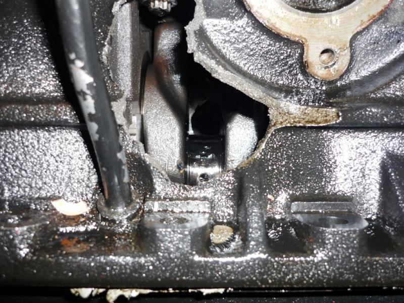

Finally got motivated to do some work on the car, started pulling the engine apart and took some pics.
Spoke with my engine builder about what happened and says it's not uncommon
on an RB26 track car that has over 300kW atw.
Apparently the main bearing spins cutting off oil flow to the conrod and it seizes.
Anyway, new engine build starting mid Jan.

A lubrication problem has likely caused the bearing to spin in the first place. Those engines have some lubrication issues when they are raced but there are fixes available.
Would that have been an early (R32 vintage) RB26DETT?
The oil pump was upgraded in the later engines. Tomei etc also do aftermarket ones which address the issue (the specifics of which I can't remember).
Either way - that sucks!
Yeah they tend to pump alot of oil into the head not leaving enough in the sump. Oil restrictors are your friend in these when raced, as you probably know :)
