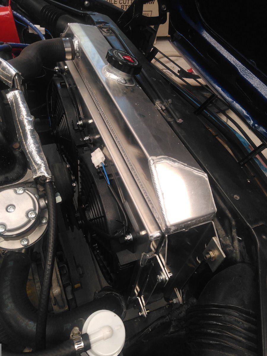

Is the vibration present when the fans are switched off or only when they turn on. Supply a picture of the fans as mounted and the water pump where the fan was removed. When the fan was removed, did you just take it off or replace anything to the water pump.

Hi Enzo, Thanks for the response, sorry delay in responding, lost access for a few days. Vibration not there when fans are off, took viscous fan off and removed studs from water pump and bolted pulley on to water pump with short stainless bolts. 4 core radiator with shroud and fans bought on the net via ebay from a company based in sydney. Came with relay, temp sensor etc. all works fine. Only about 1cm gap between pump pulley bolts and electric fans, but not touching.
Had a hard time adding photos, hope ok
