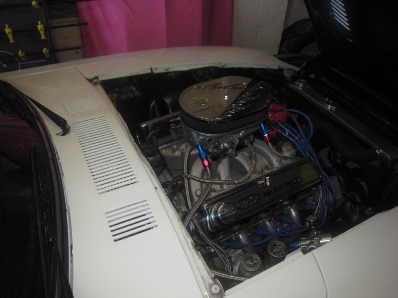

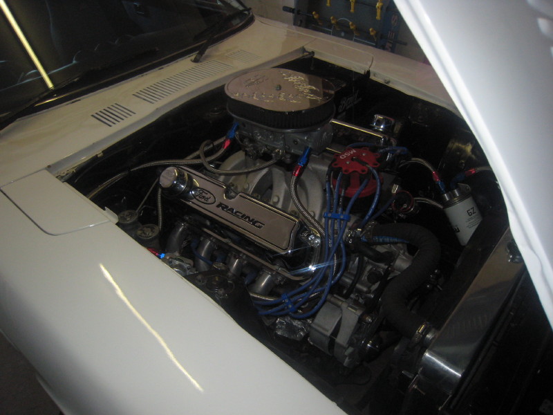

DAT392 Posted July 22, 2009 Posted July 22, 2009 Here is some more pics.Where would be the right place to get seal section [under door ] for the 260z 2+2 in melbourne as drivers side is starting to bubble and I beleive rob crichton does a diff brace of sorts has anybody used one.Im probably in the wrong part of the forum so sorry Lurch! Quote

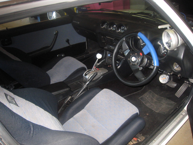

stewk240 Posted July 22, 2009 Posted July 22, 2009 A lot of power for little saftey equipment...i.e. race harness with bucket seats, rollcage etc. Quote
RBZ 260 Posted July 22, 2009 Posted July 22, 2009 sweet engine bay. hihi that will look good in my mustang how much did the rocker covers set you back? Quote
DAT392 Posted July 22, 2009 Author Posted July 22, 2009 Rbz the rocker covers came from the states with engine,but I bought some from eagle spares in melb for my uncle who has a mach 1 1970 and they were around $300 for memory.Also in reply about safety a rollcage is on my list any advice guys?I have harness"s but took them out due to being a 4 seater and my 9 year old sitting in the back seat.I am trying not to make this car a race car, just a semi quick streetcar but as you change things more its getting closer and closer.My car handles pretty well but most of your cars look like they would handle on rails getting out on a circuit track.If I was doing that I would have put a roll cage in first before anything,but your point is very valid. Quote
