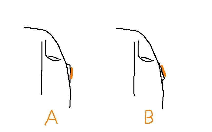

ozy Posted July 12, 2009 Posted July 12, 2009 didnt want to start a new thread. i also have a side indicator question. picture attached below my zed seems to have the front side indicators installed backwards (pic B). i may keep them as is because i like the look. but then i found a mate with a 260 2+2 (english car originally) and he also has them backwards. mines a japanese restored car, the mates 260 is awaiting restoration. from the pics i looked at on the net, ours deffo seemto be the wrong way, the pics show the side indicator parallel with the line of travel of the car (pic A), whereas our 2 "splay out". is it also true that these indicators were used on other datsun models, but with different rubbers. the zed rubbers being more wedge shaped to account for the shape of the body and trying to build out the indicator so it would be parallel. ill try to get a photo too! so i guess, were there differences in any markets or have we 2 zeds that 2 different people installed the lights either accidentally or on purpose backwards? Quote
RB30X Posted July 12, 2009 Posted July 12, 2009 For a quick scribble in paintbox, that it the most accurate drawing to describe your question I have ever seen. Congrats I have been asked the same thing about mine which were already installed. Mine are currently like exibit A and I thought thats how they were supposed to be? Quote
ozy Posted July 12, 2009 Posted July 12, 2009 yeah, it seems to me that A is correct. I could accept mine being wrong (like in B), but a friend with an english 260 has them the same way. mine is restored, his isnt. just thought it was weird to find another, especially in ireland and as there arent a million zeds here. For a quick scribble in paintbox, that it the most accurate drawing to describe your question I have ever seen. Congrats schucks, should have gone to art scholl.... geddit? Quote
Moderators Zedman240® Posted July 13, 2009 Moderators Posted July 13, 2009 "A" is the correct way for mounting, because of that indicator being a reflector as well, it won't work being on an angle as in "B". It has to be at 90' at traffic approaching you (as in a T intersection). People mount it the other way I think for lower wind resistance...may affect it by approx .0000000001 % Quote
ozy Posted July 13, 2009 Posted July 13, 2009 "A" is the correct way for mounting, because of that indicator being a reflector as well, it won't work being on an angle as in "B". It has to be at 90' at traffic approaching you (as in a T intersection). People mount it the other way I think for lower wind resistance...may affect it by approx .0000000001 % yeah, that makes more sense. wind resistance would be minimal on that. i do prefer the look of it. it seems to follow the lines of the car nicely....like an arrow head. so ill probably leave it alone. it just struck me strange when i saw another like it here, where we only have a small pool of Z cars. thanks zedman and rb30x! Quote
Lynton Posted July 13, 2009 Posted July 13, 2009 Funny but modern logic I think reins supreme, my 260Z coupe car was supplied new to me was with tapered guard indicators as was my unblemished 260Z 2+2 but the majority of people in latter years have told me they should be the other way? From so much peer group pressure I eventually turned the lenses around but no body believes me when I tell them that is how the cars were supplied new?? Lynton Quote
ozy Posted July 13, 2009 Posted July 13, 2009 @lynton, do you mean back in the day? i could understand mine being restored and flipped around, but my friend has an english one, very unrestored, rusty and the lights as picture B. i take it your in australia and these were aussie cars? both of them were like this? what years were they? mines 78 Quote
