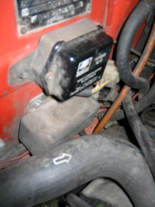

Toecutter Posted March 20, 2006 Posted March 20, 2006 I've recently had a problem with my car not starting. I mean nothing, like the battery is not even connected. I've checked the battery and it is fully charged however I tried to start it directly from the starter motor across a screw driver, nothing once aqain!? I've heard that these cars have problems with regulators and these symptoms point to it. Any comments? How does the regulator work and where is it? [/img] Quote
lambs Posted March 20, 2006 Posted March 20, 2006 The black box in that photo is the regulator. It's an aftermarket, solid-state unit which has replaced the original mechnical type. They are very reliable and I doubt that's the source of your problem. From your description it sounds more like the starter motor, and possibly the starter solenoid which is faulty. It's easy to check whether the charging systems is OK....assuming you have access to a voltmeter. With a fully charged battery and the engine running, the voltage across the battery terminals should be around 14V (lights off). Switching lights on the voltage should drop slightly, but recover with increased revs. If this is the case the charging system is fine. Quote

lambs Posted March 21, 2006 Posted March 21, 2006 i only have 11.5volts at the battery until i'm reving over 2000rpm :shock: hence my questions about upgrading the alternater... i need to fix up the ground connector on my battery' date=' it often doesn't make a connection and screws all the power in my car, not good while i'm driving! make the lights stobe though which freaks out oncoming cars![/quote'] 11.5 volts@2000rpm is also not good, but if that reading is from the factory dash gauge I'd be double checking with an accurate voltmeter. The factory gauges aren't the most accurate in the world. Stock alternator is Ok for standard car, but if you have stronger lights + a sound system, an alternator upgrade is a good idea. Also turf the standard regulator if you still have it and either get a solid-state one (pic above) or an internal reg alternator. Quote

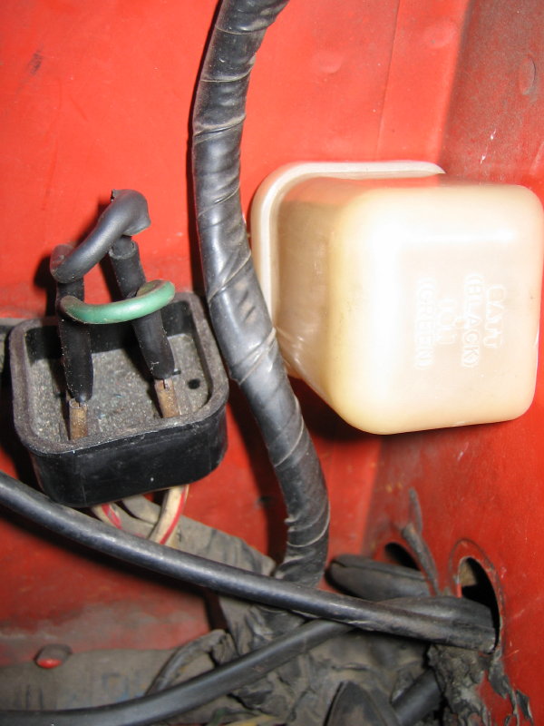

Toecutter Posted March 21, 2006 Author Posted March 21, 2006 i was told to check on a "fusable link". Tinkered with a small box on drivers side that seemed to have a freyed wire, car started on first go after that. Gotta have a better look during daylight hours tmrw! THanx Fellas Quote
Enzo Posted March 21, 2006 Posted March 21, 2006 fusable links can be ordered from Nissan or made cheaper by an auto electrician. If your car has the originals still connected they should be replaced. David. Quote
Toecutter Posted March 21, 2006 Author Posted March 21, 2006 Got home just as it was getting dark and had a quick play around with what I think is the fusable link. Results are good seeing the car kicked over and started first turn of the key and kept starting reliably. I'll take a better look tmrw but just to be sure I've taken a photo of what I think is the fusable link. Any comments guys? Is this the fusable link? Quote
Enzo Posted March 21, 2006 Posted March 21, 2006 Hi, looks like your on the money. Different from the one on my 1976 260z but i would say that's it. Check for corrosion on the connections and when the motor is running put your finger on it to check for heat. if too hot it means the connection is faulty. Good luck. Quote
lambs Posted March 21, 2006 Posted March 21, 2006 Got home just as it was getting dark and had a quick play around with what I think is the fusable link. Results are good seeing the car kicked over and started first turn of the key and kept starting reliably. I'll take a better look tmrw but just to be sure I've taken a photo of what I think is the fusable link.Any comments guys? Is this the fusable link? They are the fusible links - early 260Z's are the same. A fault here might cause power supply problems to the start cct, but I'd have to check the wiring diagram. Worth checking for corrosion, etc, but the low battery voltage should still be investigated. Quote
