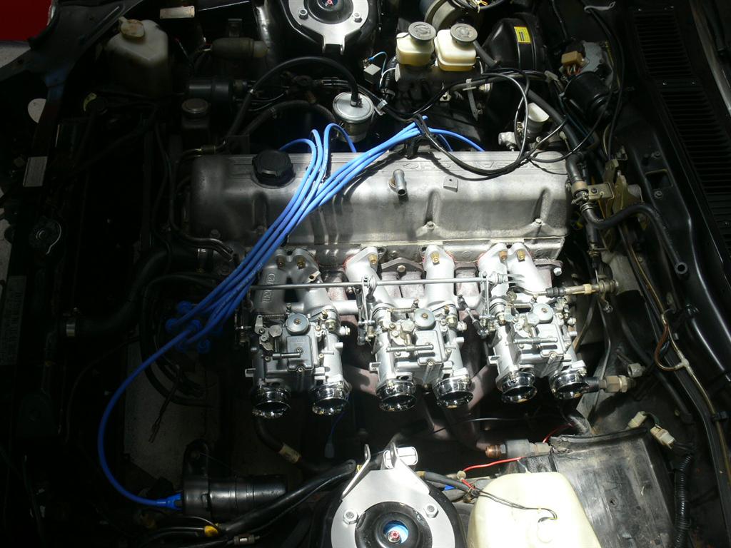

Yes, I know its a little optimistic.
After having these carbies for months I have finally done something with them.
After a few weeks of bolting bits on, then realising that I need more bits. Buying bits and bolting on a week later. Noticing that I need more bits.
etc etc
Anyway, tonight was the big night. Everything is on.  ;D
Turn the key........battery is dead.
Charge her up for a few hours, turn the key..........turns over...............no start.
Took a carby off for a look.
Jets are gummed up.....Why didn't I just check when I first got them.  :-[

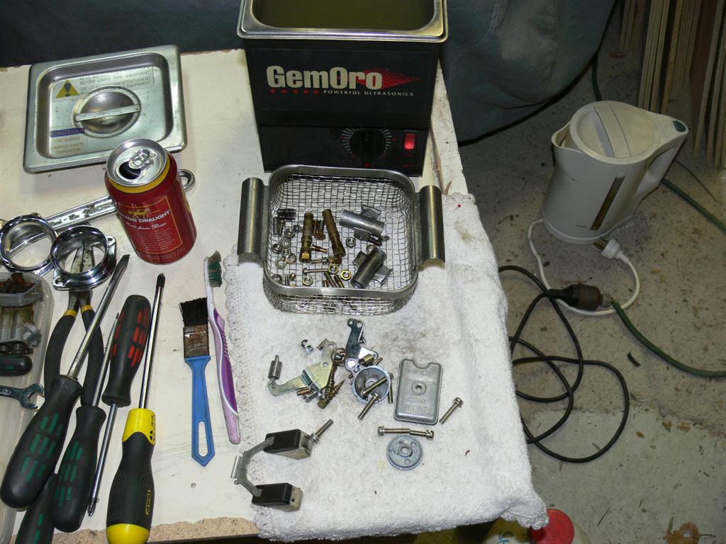

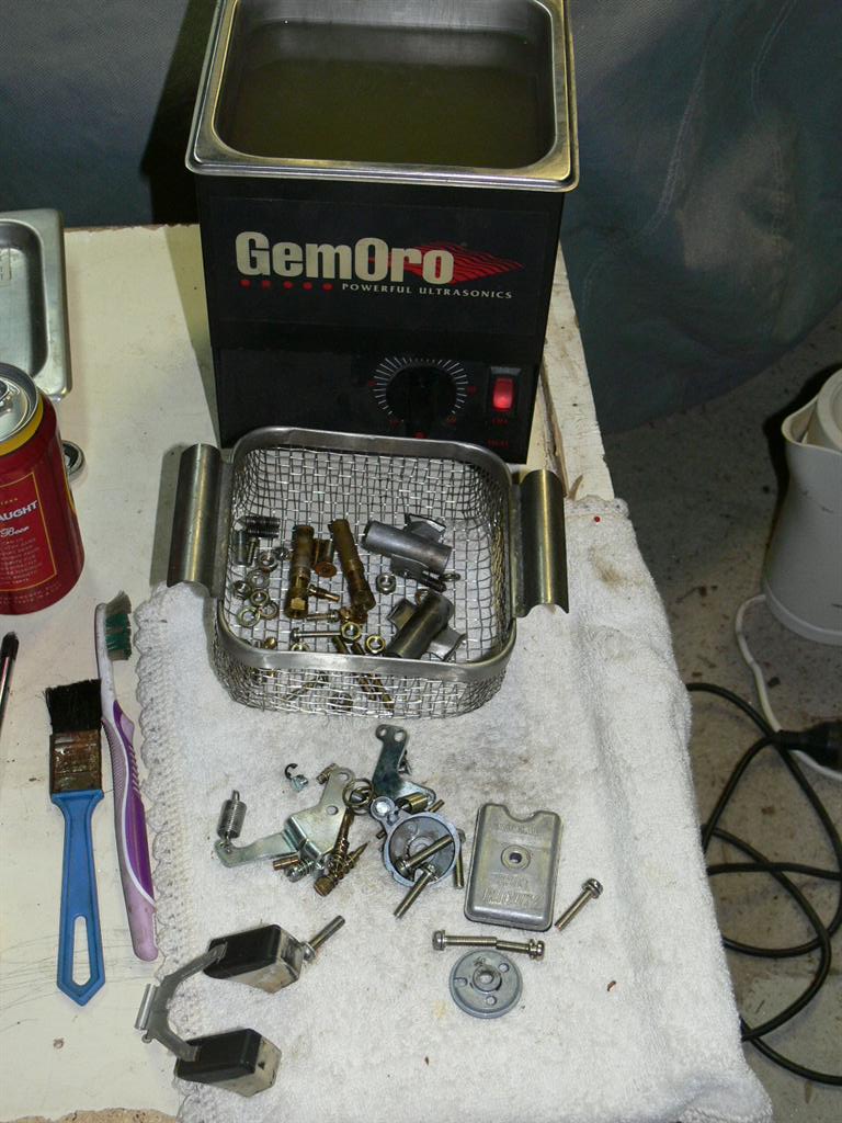

I borrowed an ultrasonic from my sister inlaw (she's a jeweller) to rebuild the carbies.
I was amazed as to how well it worked, I told her that I was going to keep it. She replied that if I gave her $700 I could keep it  :o
Friday night I sat up in the garage till 1:20am working on the first Carby, start to finish in one go gave me less chance of stuffing it up.
Note to self, do not turn on the air compressor after midnight in the future if you want to avoid being killed by wife.

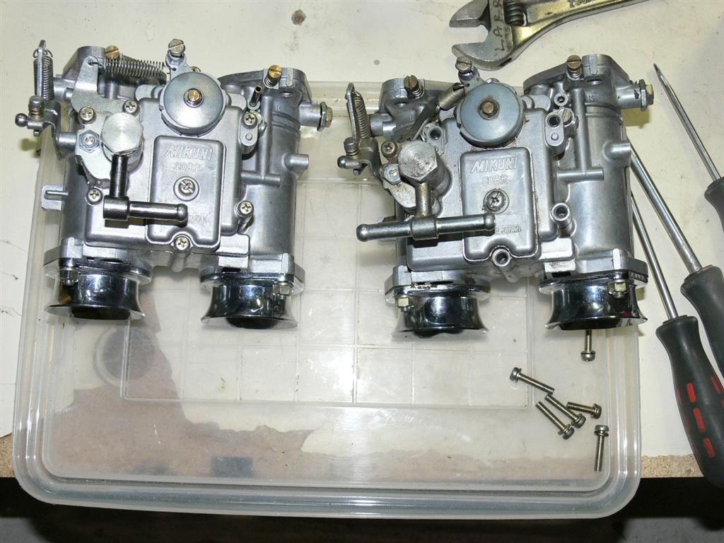

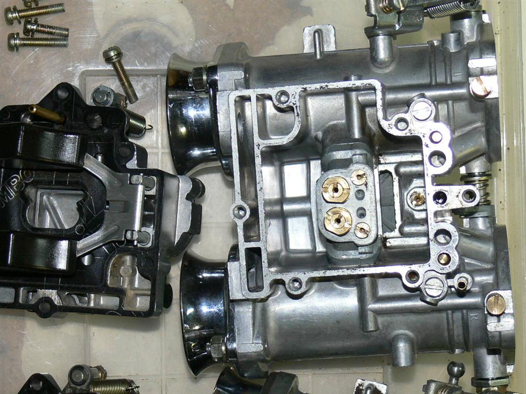

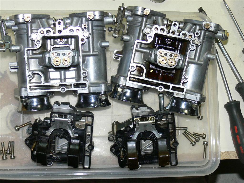

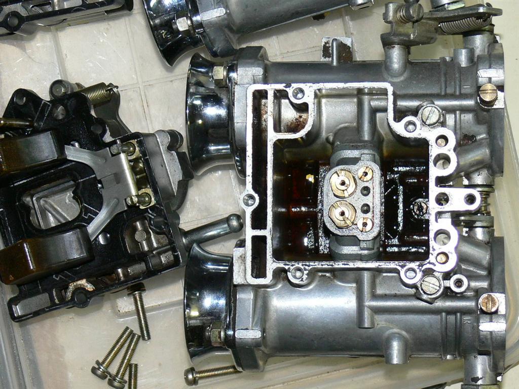

Here are some pics of a rebuilt and non rebuilt carby. They don't look too bad, till you open it up.
Here's the setup that I was using.
I also took notes on jet sizes to make sure that they are matched. Also cleaned up spare jets that came with them.

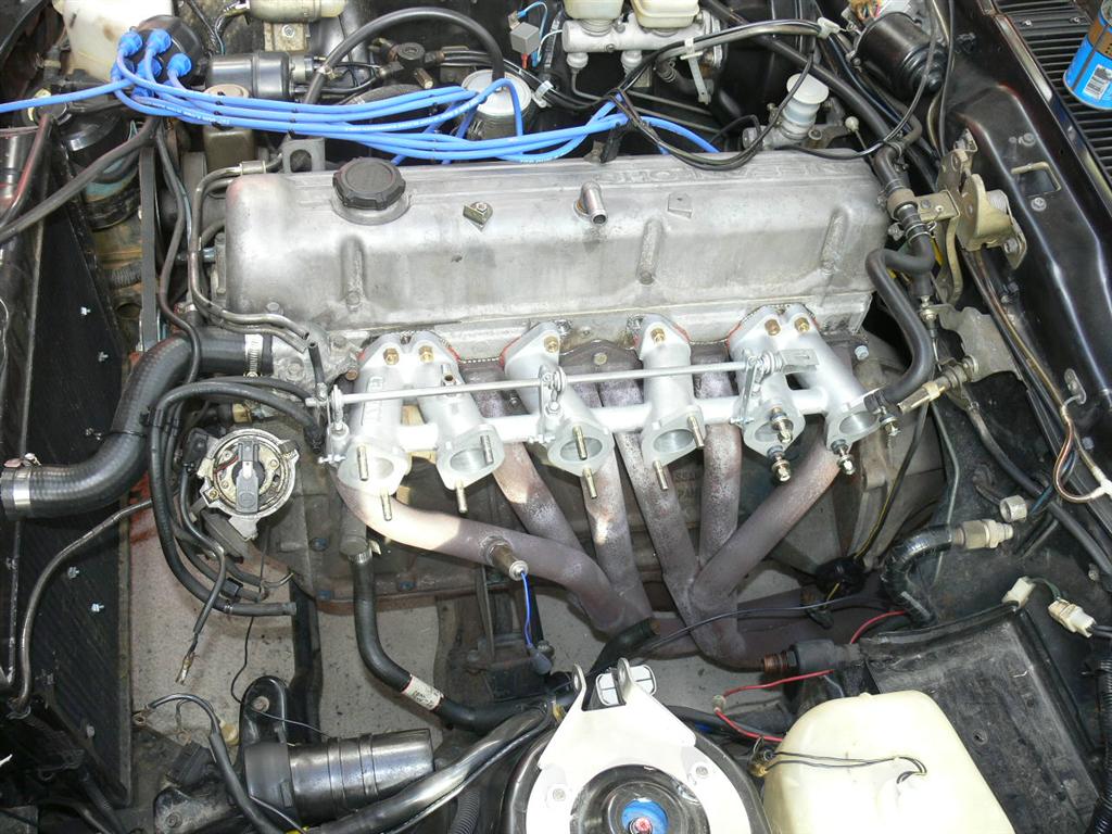

Any experts able to tell me how these will go in a stock L28 with extractors?
No wonder that it wouldn't run, all the insides were like they had tar in them. Jets and holes blocked.
Overall I'm pretty happy, now to check that they work.......
Very nice,
How did you get the insides so clean, even the corners are clean? Throttle body cleaner?
Or did you wack the whole thing into the ultrasonic  :o
