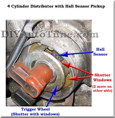

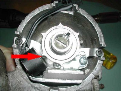

what exactly do you mean by ignition module within the dizzy?
do you mean the reluctor coil pickups?
like in this pic?
or is it a hall sensor?
If its a reluctor, you can check to see if you have continuity through the pickups, there should be some resistance, as it is a coil of wire, but if there is no continuity, thats bad.
The reluctor pickups generally go into a module, that cant be tested easily, unless you knwo what each pin is, and what you should normally read at each pin.
the majority of the time, out of the 2 its the module that packs it it.
If its a hall sensor, its the same, you can measure the sensor itself to see if its broken. It should have a 5v reverence on one of the three wires, ground on the other, and a changing output signal on the 3rd.
you really need proper equipment to test it.
But you say your triton is a carbie model? so its unlikely it'll have a hall sensor, usually used for EFI setups.
