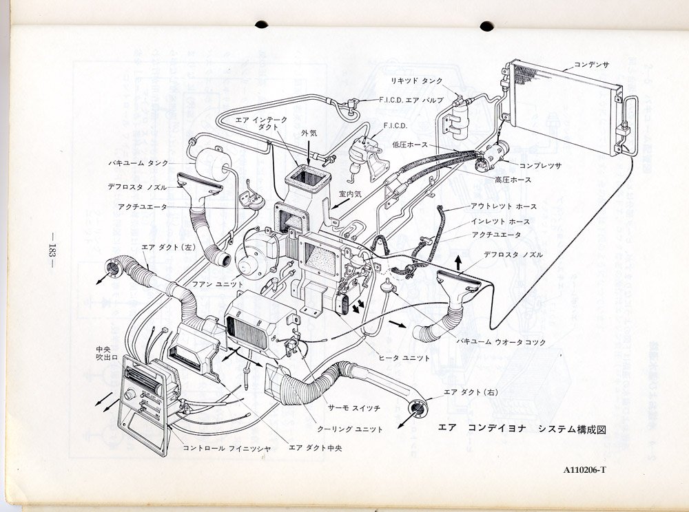

as i've seen discussed may times on the forum, there are no aus delivered 240s with the factory air
since i'm making an in-dash system, i'd like to know if anyone knows where and how the drain pipe should work?
the evap box sits directly above the tunnel and i can find any photos or drawing

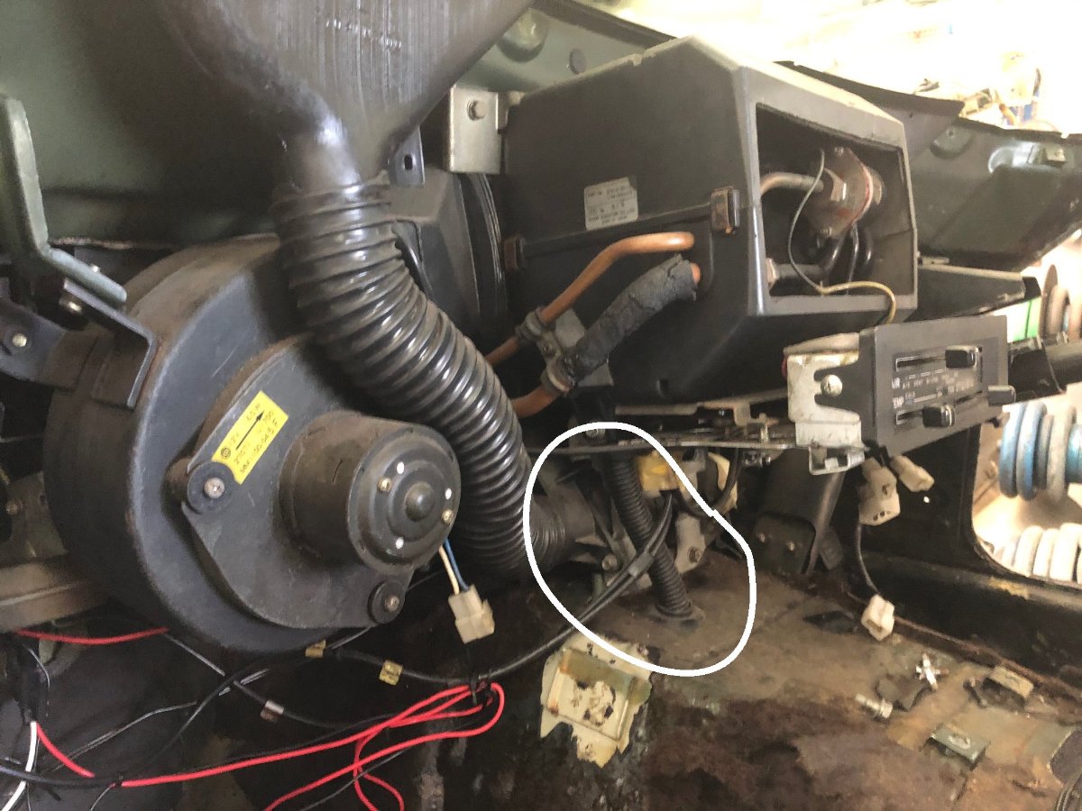

And it appears the drain tube goes straight down through the top of the tunnel.
