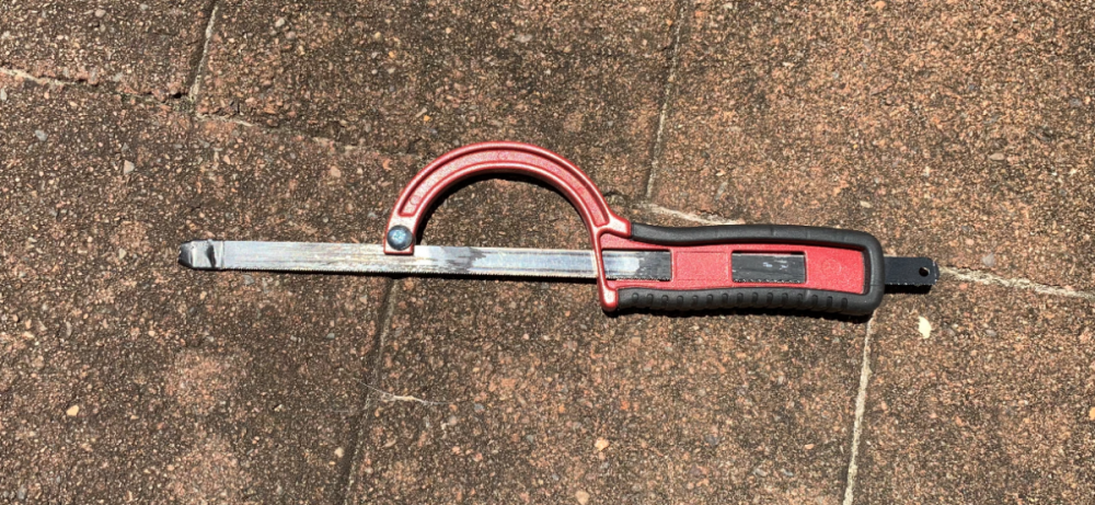

My advice thus far is try and see what type of brass bushes you have. One of these I presume had been replaced before and was one solid brass piece, used a hacksaw blade with tape on the end in the rack to prevent it cutting the metal frame, then just tapped it out by hand.

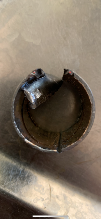

The other, and I think original actually has a split in it - I got this one out by hacksawing (as above) near the split, then used a punch to peel the bushing up at the split then just pulled it out. (Photo below)
Disregard the other cut I’ve made in it, I didn’t see the split in it at first so was doing things the hard way, as always haha.
