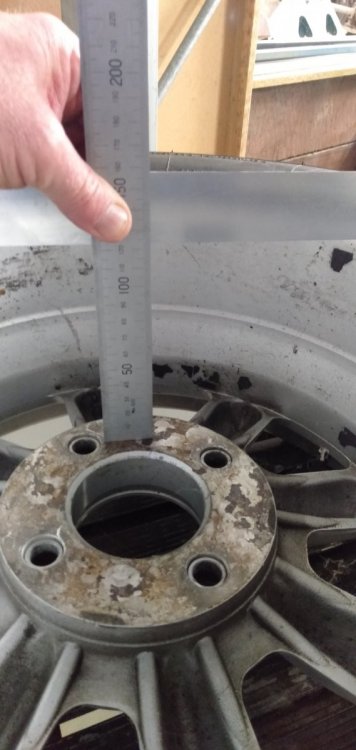

Not Rota's , Superlite's running R spec tyre's .
The +10 brings the rim  towards the strut , mine clear  using standard Diameter spring.
The back space is 123mm
Best to try before you buy if you can find one to test fit
