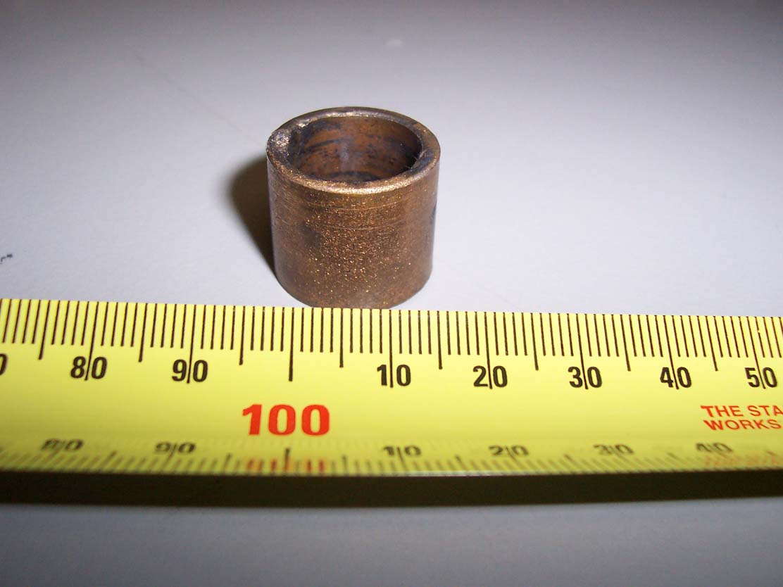

benny Posted June 11, 2008 Author Posted June 11, 2008 can somebody post a picture of the spigot bearing?? Quote
Moderators Zedman240® Posted June 11, 2008 Moderators Posted June 11, 2008 Sorry, I cant find the part number; I looked in the garage for the box. Hopefully someone on the forum might have it handy..Heres a pic of the original bronze/brass spigot bush.. Quote
Toecutter Posted June 11, 2008 Posted June 11, 2008 You can get them at Nissan either $10 or $20 last time I bought one if you dont want to make yourself. Just explain what part your after they will know! Sulio Quote
