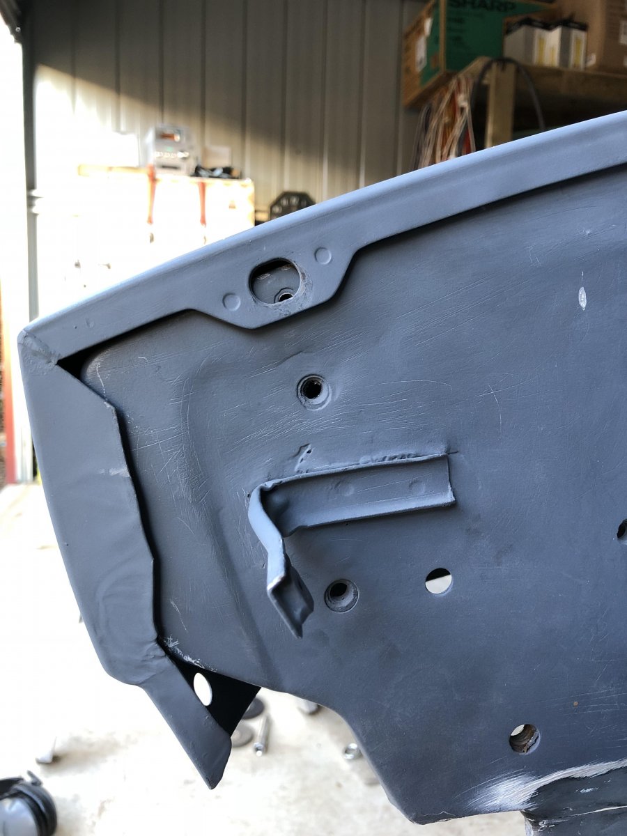

My query is; when I fit the front guard and headlight bucket, I have to push down on the front of the headlight cone in order for the hole in the bucket to line up with the correct bolt hole, this causes the guard to flex. As we used the front sections from my other Z, I can't be sure of how well they're supposed to fit. Would I be correct in assuming that the bolt hole should line up pretty well without having to be pushed down too much?
Photo below shows the hole that I'm taking about. It's a bit more out than the photo suggests as I haven't finished realigning it to be straight.

Yeah I've had the same problem on #150..The only solutions are modify the support section so it sits higher or file the headlight bucket hole (elongate it) to allow you to put the bolt through it.
The other thing you can do is check squareness of the front of the car and compare the non-hit side with the side you repaired.
Basically there is no easy solution here that I've found. Other than a lot of messing about. :)
Thanks Gav. I was wondering whether it was just how they were, given that the headlight bolt closest to the radiator support was spot on where it was supposed to be... But perhaps not.
We chopped both sides off (both were damaged). Both do have the same amount of drop though, which is why I thought it could be somewhat correct.
Looks like I'm messing about some more then :)
