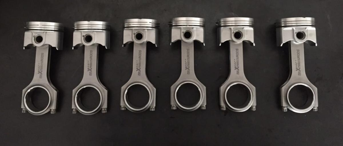

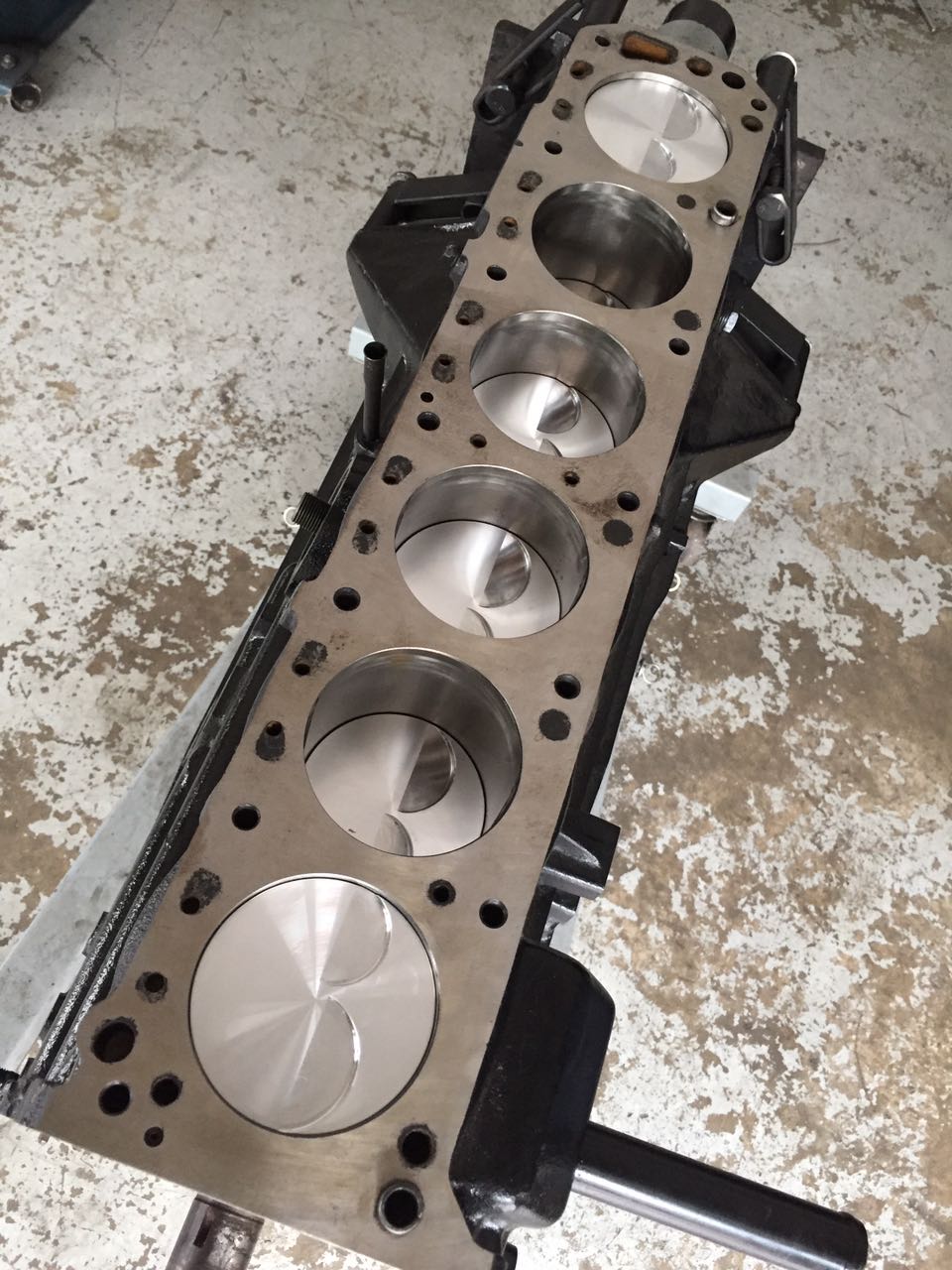

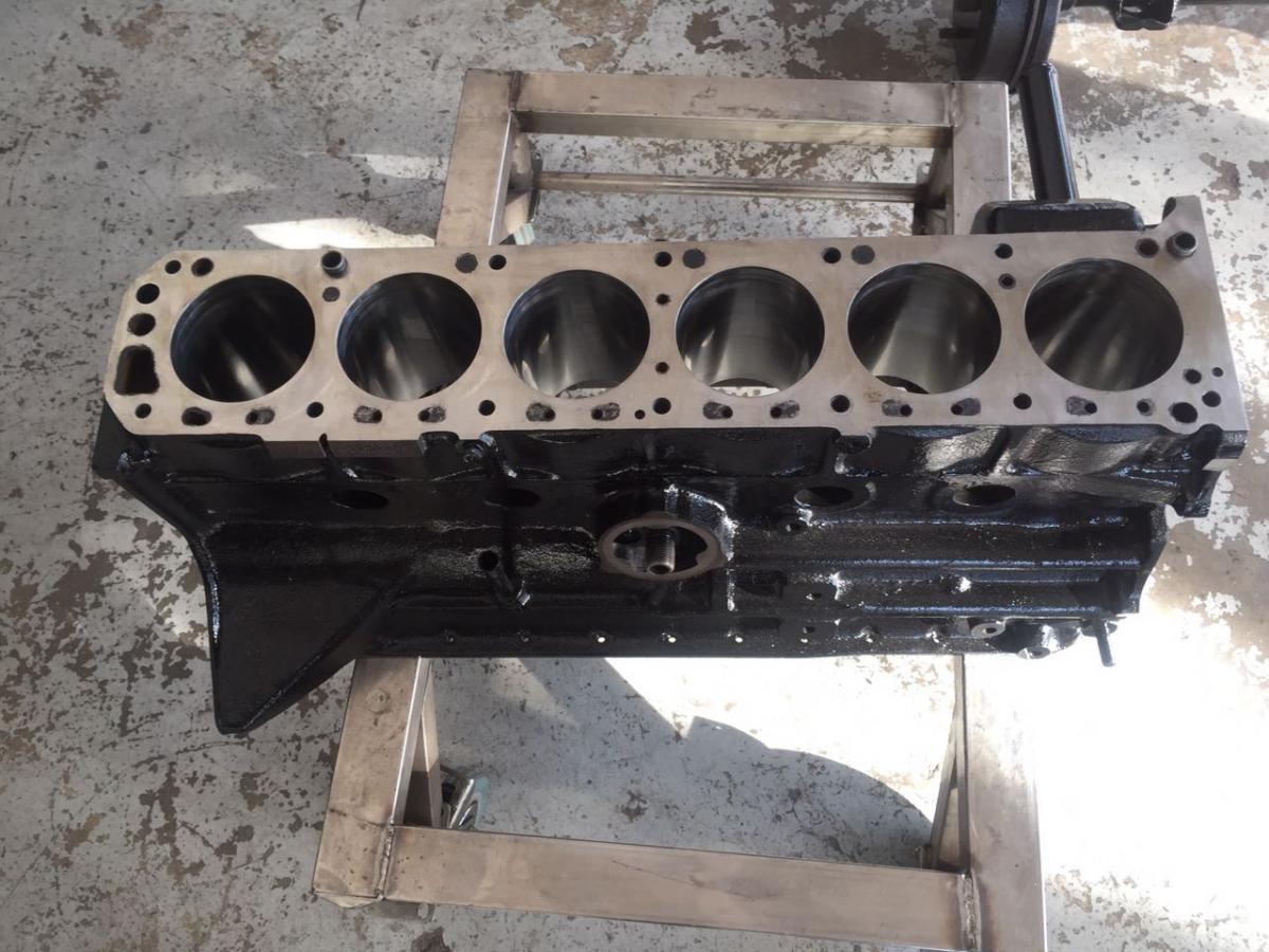

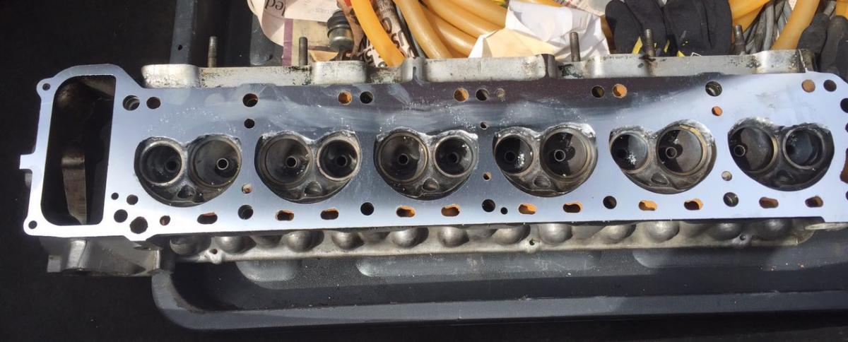

Finally got my car back.
Thank you everyone for the advice on modifying the car especially lurch for the detailed tips!
The car has a very good pull at higher range rpm,but im not sure about the exact rpm as i forgotten to get the msd tach to make the rpm to work with the msd ignition.

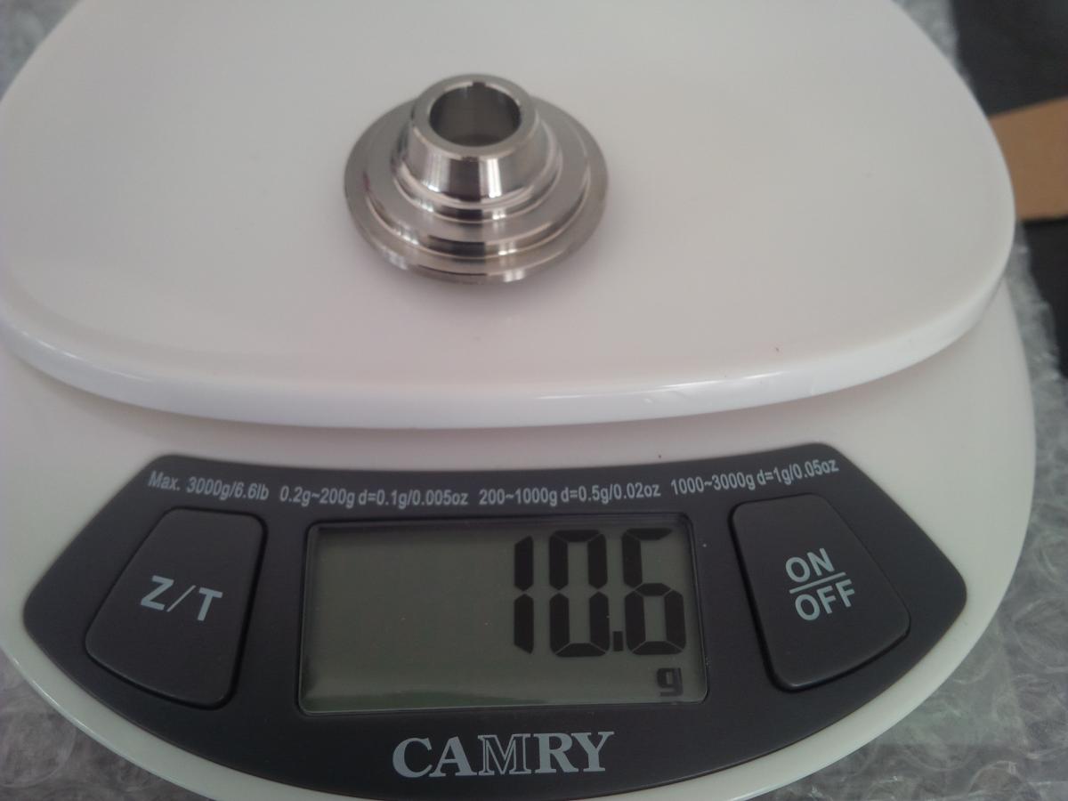

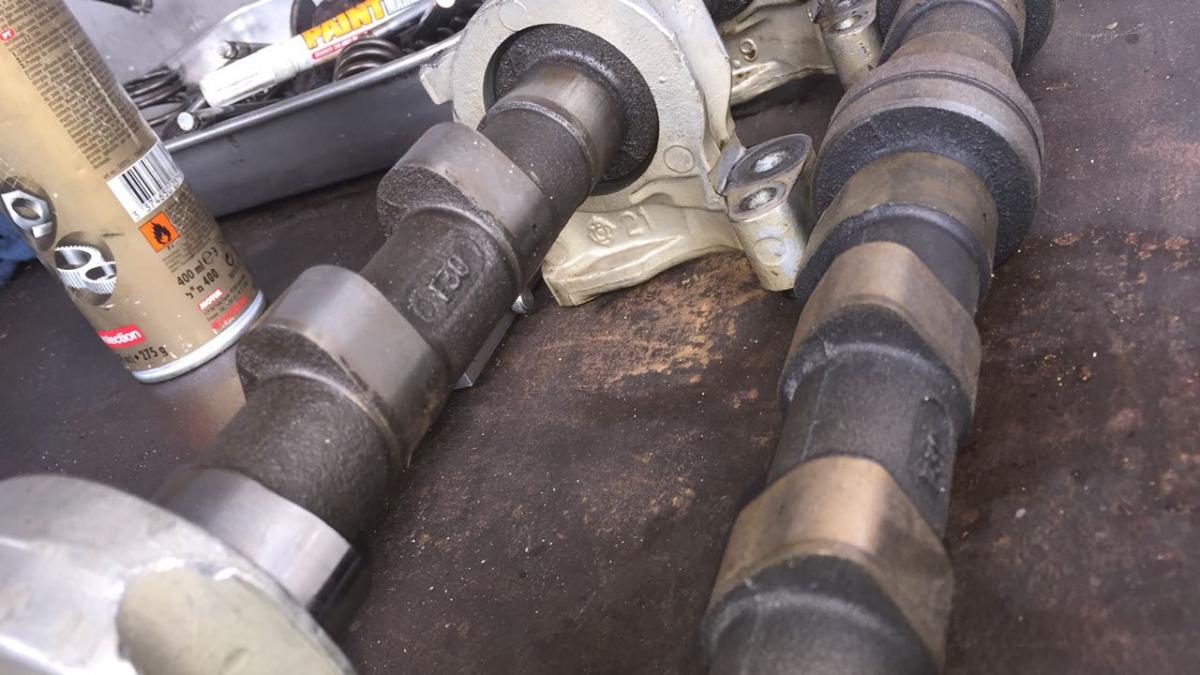

Its has titanium retainers, 9000rpm springs, bronze valve guides, lumpy cam i dont know whats the specs.
While cruising on 110kmh, 5th gear the engine is noisy, i guess its sitting on higher rpm, my questions is would changing the differential to 4.44 helps? Or do i need to change the gearbox too?
Or can i keep the gearbox and just change the gearing from kameari? Currently is stock gearbox with a lighten flywheel.
Edited by locklock
Posted (edited)
If you currently have a 3.9 diff, changing to a 4.44 will cause the engine to rev higher at the same road speed.
To reduce revs, you want a 3.7 or 3.54r diff. But then performance will suffer.
