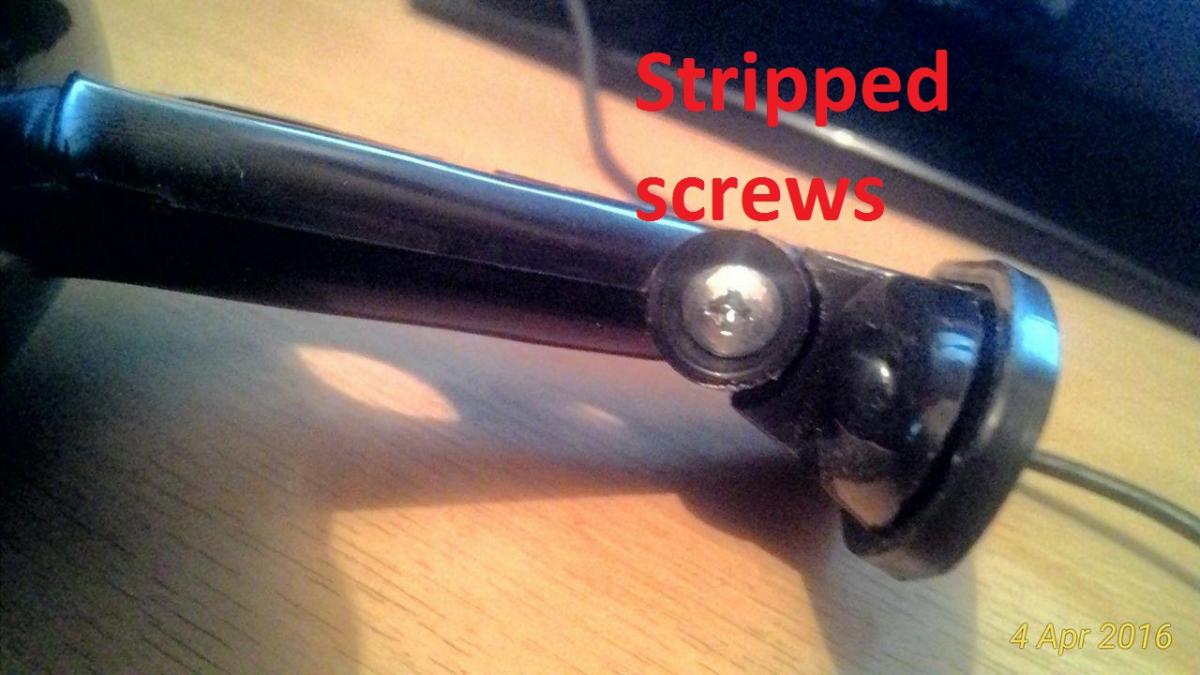

Some of the issues I spotted:

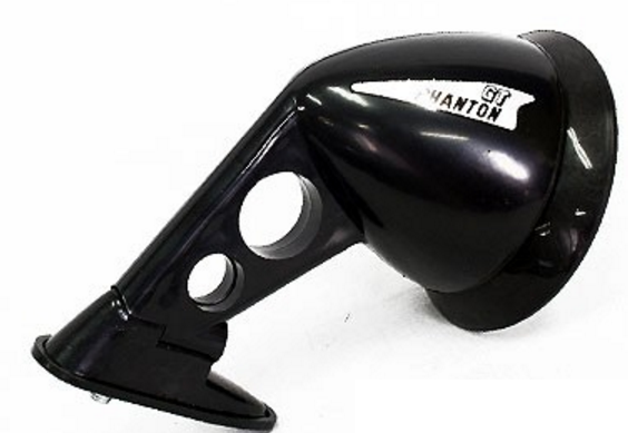

The mirror was disassembled and holes sanded to promote adhesion. Excess dust was cleaned with wax and grease remover.
The holes were filled with fibreglass filler. Once this had dried they were sanded flat and each side was filled with body filler to make it flat.

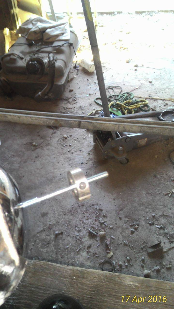

To fit the chrome mirror housing from the bullet mirror to the black frames the stud needs to be shortened around 10mm.
I wound the die in and cut the end off the stud. Could probably get away with using a bolt to do this.

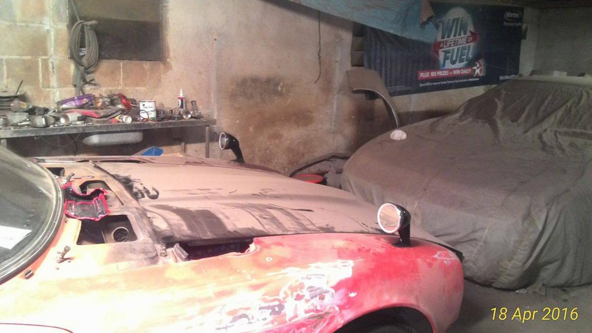

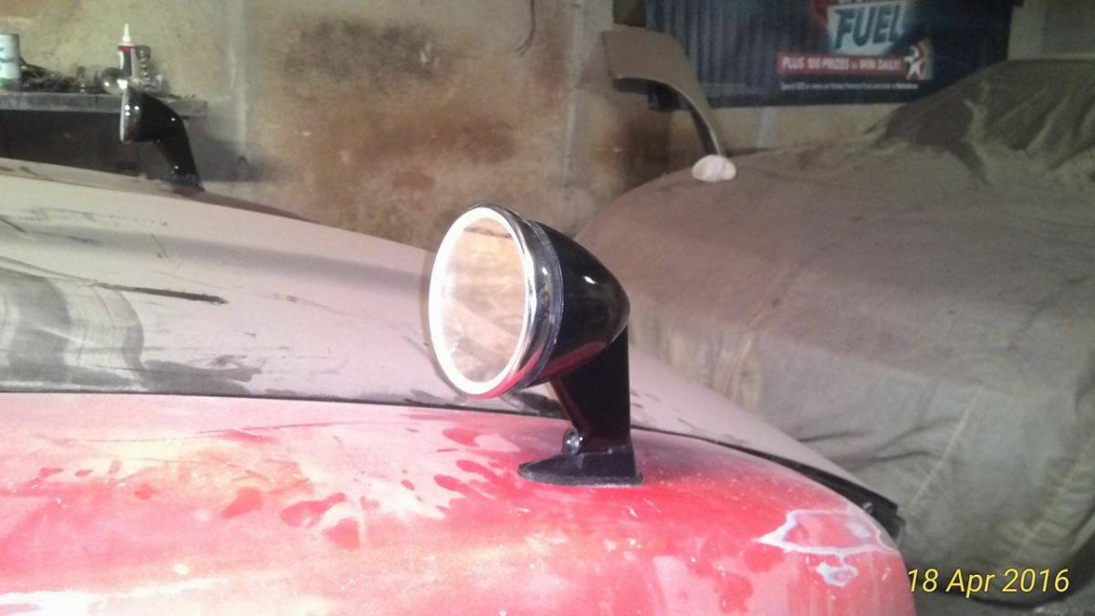

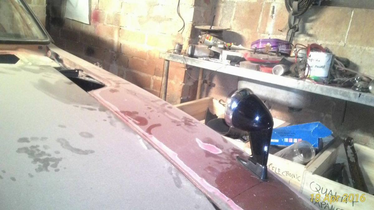

All fitted up together. Will probably paint the mirror bases as well as they are a slightly different shade.
