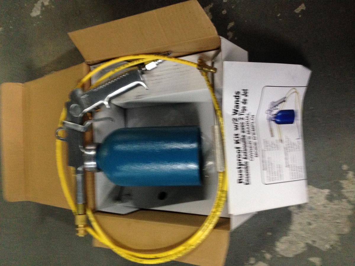

My RA60 has been done with TECTYL from brand new and not a bit of rust can be found. One thing I did notice the holes where the wand has been inserted has been punched not drilled which makes sense as it leaves no little bits of steel inside panels. Also I have this rather great little spray gun for spraying Tectyl and lanolin everywhere.
