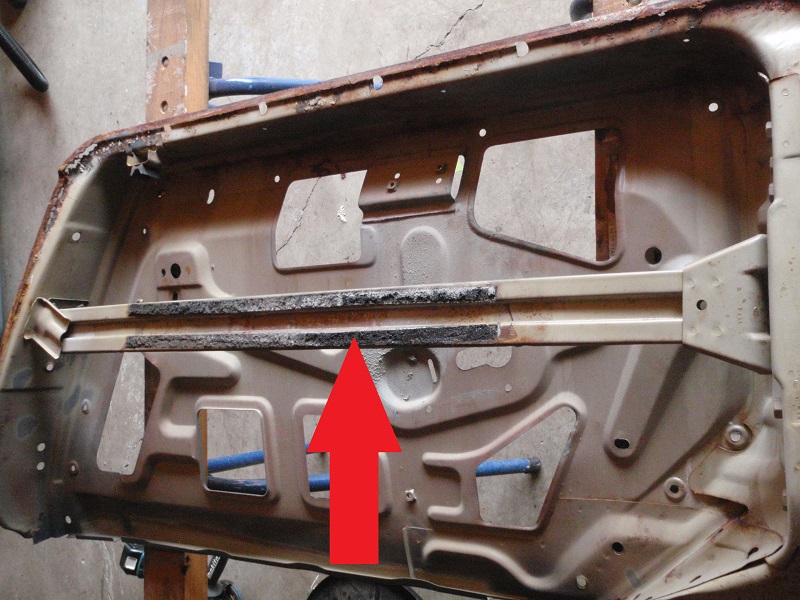

On the door frame there's a cross bar / side intrusion support / structural member – whatever – that has a foam bit on it. This:
When I had my door skins replaced, the piece of foam that goes on the side intrusion / support bar was not replaced – i.e. it’s not there now.  I presume it’s there to keep the skin from rattling on the cross bar. Does this matter?  Should I try and fit something in there now or not be fussed?
If I was you I would just get some window sealing tape from your local hardware store (or some sort of adhesive foam tape)
It's probably not important but you might as well spend the 4$ to get some foam tape now then get your skin on, the car together and find out your door skin is rattling

You want stuff called Anti Flutter Foam.
http://www.viczcar.com/forum/topic/3202-tutorial-door-skin-removal-for-dummies/?p=147970
https://lh4.googleusercontent.com/yK_3eNEvEybJqvejIV9gVFitS8r152G_nPF0nyboUBuG=w596-h795-no
I'm pretty sure it goes "off" so you may need to ask for it to be ordered in...Limited shelf life and all that.
