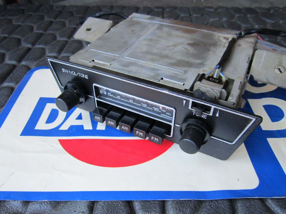

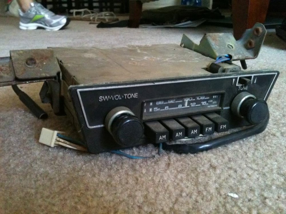

sydney mike Posted September 7, 2015 Posted September 7, 2015 (edited) Hope this helps, you can see in this first 2 pics the bracket that holds the centre console to the tranny tunnel is still attached to the radio. Edited September 7, 2015 by sydney mike Quote
gilltech Posted September 7, 2015 Posted September 7, 2015 Yep, in other words you need to have that saddle shaped bracket that holds the two front ends of the console apart. If you've got that, then you're good to go as per Sydney Mike's pictures. Quote
