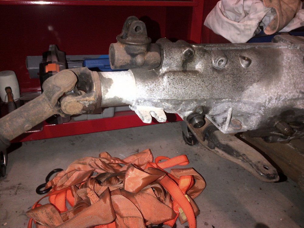

It's looks like a 280ZX unit.
Put it in first & count the output shaft rotations - if it's 3.3 it's a 280ZX box or similar.
