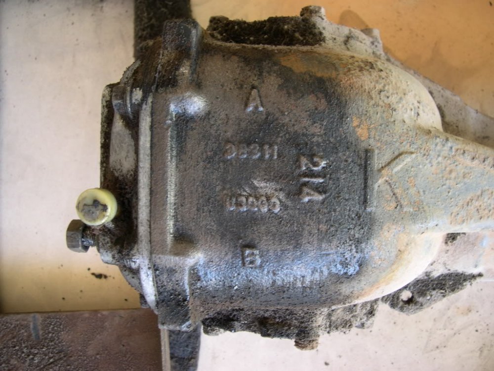

V8Datto Posted January 14, 2008 Posted January 14, 2008 Wanted to know if someone could give me some incite as to what diff this is, (as is r180?) I have goggled it and found heaps of info but nothing about old diff's with the BIG K in the casting. Diff is out of a 1970-71 240z and has 3.54 ratio Is it original or has some swapped it out of something else? Quote
maddos Posted January 15, 2008 Posted January 15, 2008 That is an R180. I've read that R180's marked with a K are from later model 200sx or something. My 73 240 had a K on it's R180 as well.Out of my 3 R180's, I think only one doesn't have the K Quote
C.A.R. Posted January 15, 2008 Posted January 15, 2008 The very early R180's didn't have the 'K' stamped on them. The 3.54 came out of various car's - possibly out of the auto 240K's? Quote
maddos Posted January 29, 2008 Posted January 29, 2008 Ah ha. This is where I read about the K. Maybe I'm not losing my mind after all. http://forums.hybridz.org/showthread.php?t=114798 Quote
V8Datto Posted January 29, 2008 Author Posted January 29, 2008 Yeah I found that, That why I posted here, it says nothing about early K stamped diffs. Quote
maddos Posted January 29, 2008 Posted January 29, 2008 "Newer R180s are availabe from the 84-88 200SX and have a[glow=red,2,300] large K [/glow] cast into the top of the housing. They can be used in the Z with some modifications. The newer diffs use a stub shaft that plugs into the diff and is retained by a circlip, and the older diffs used a bolt in stub shaft." About 7th paragraph down, then goes on to explain "Modification procedures to convert new K R180 to bolt in stub shafts" Posted the link for other peoples sake as well, it's a good read. Quote
