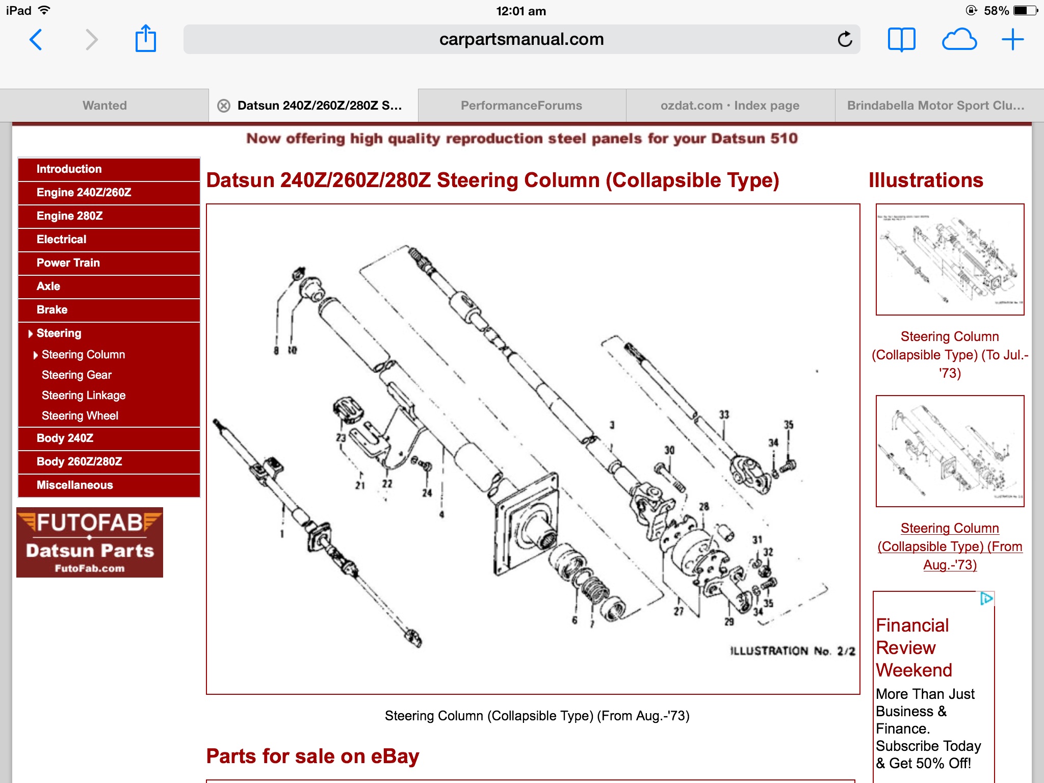

Wtd---the Shaft between steering rack and bottom end of column
Chasing the cardan shaft ( fixed unversal joint at bottom where it clamps onto rack)
The top is a fine spline on end of shaft.
There were two versions,
Up to july 1073
And from August 1973.
Heres my problem, i dont know whoch one i need! ( custom application)
If you have one, can you measure its o/all length and post up, and what month/year is car
Possibly 2+2's could be a third variant?
Brisbane area.
Up to july 1073

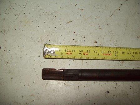

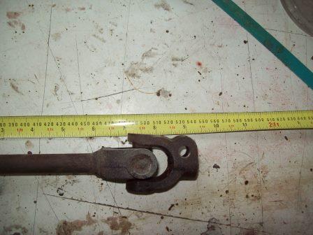

Here is mine - 3/72 = 530mm
Thanks Peter.
Turns out what I have is a Z shaft that has been cut down to 385mm o/all length and replined, with a milled flat for the bolt.
