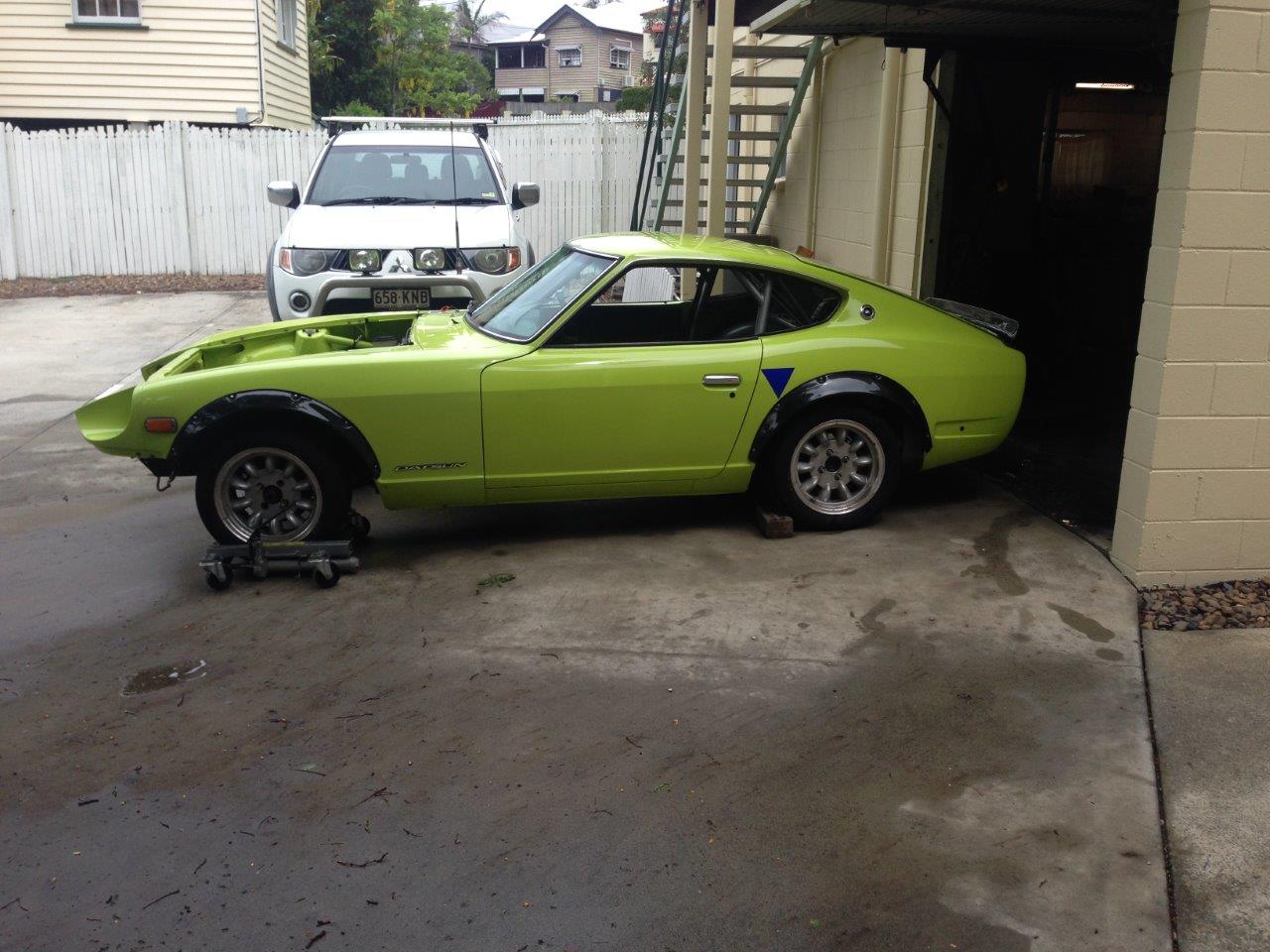

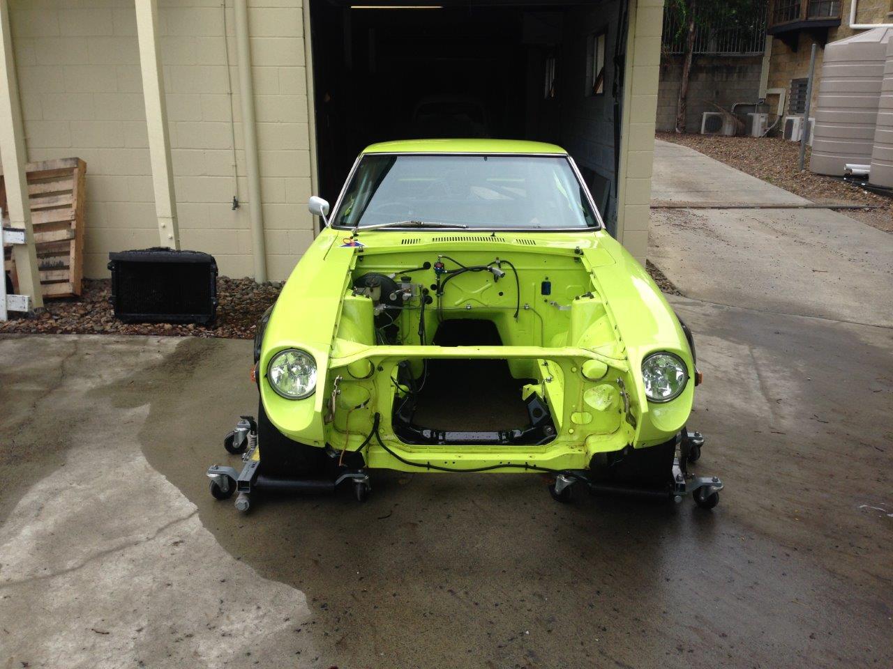

zed74 Posted December 30, 2014 Posted December 30, 2014 Hi ALL, Plan to have this second zed ready for NDN15. Will enter my Blue Tarmac zed anyway - but nothing like a deadline to get things moving on a "stalled project". Brief history: Car bodywork fully restored back in 2007 with fibreglass ZG nose installed...... until someone (not me) put it into Macadamia nuts at Mt Cotton & destroyed the ZG nose! Body was taken back to bare metal via sandblasting (garnet) to reveal a "lightweight shell " Extensive repairs undertaken & ZG flares fitted which also addressed some corrosion around rear wheel aches..... my excuse anyway! Initially setup to be a dedicated track car. Car ran a Supercharger from a Toyota 2 litre on an L28 - but quite frankly it was a "dog" & barely beat my Blue Tarmac zed at FOSC Bathurst event in 2010 despite being 170 kg lighter & supposedly more power . Engine & driveline (incl. suspension/brakes) returned in late 2010/early 2011 to the person "who used to setup my cars" - thankfully no longer doing so... Upgrades to my Tarmac zed have enabled a few parts (incl. a motor) to become available to get this car functional again. I will update with photos as things progress. BTW: I have a 17 yo son (soon to turn 18) who is pressuring the turbo route - but for now that can be one of his dreams... His Grand dad has just retired recently from Morgan Park sprinting his RB powered 260z - who knows what he can negotiate down the track Quote

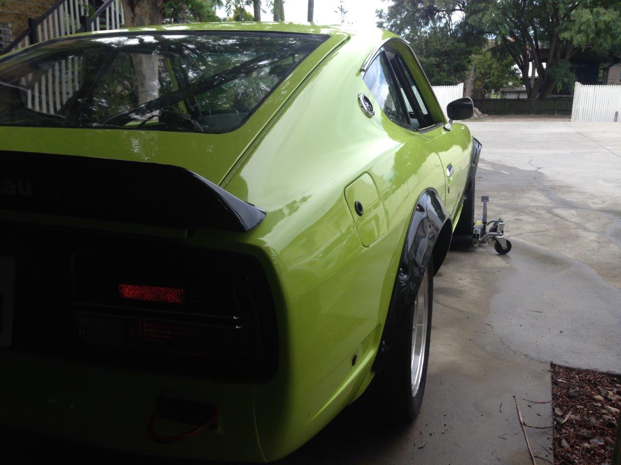

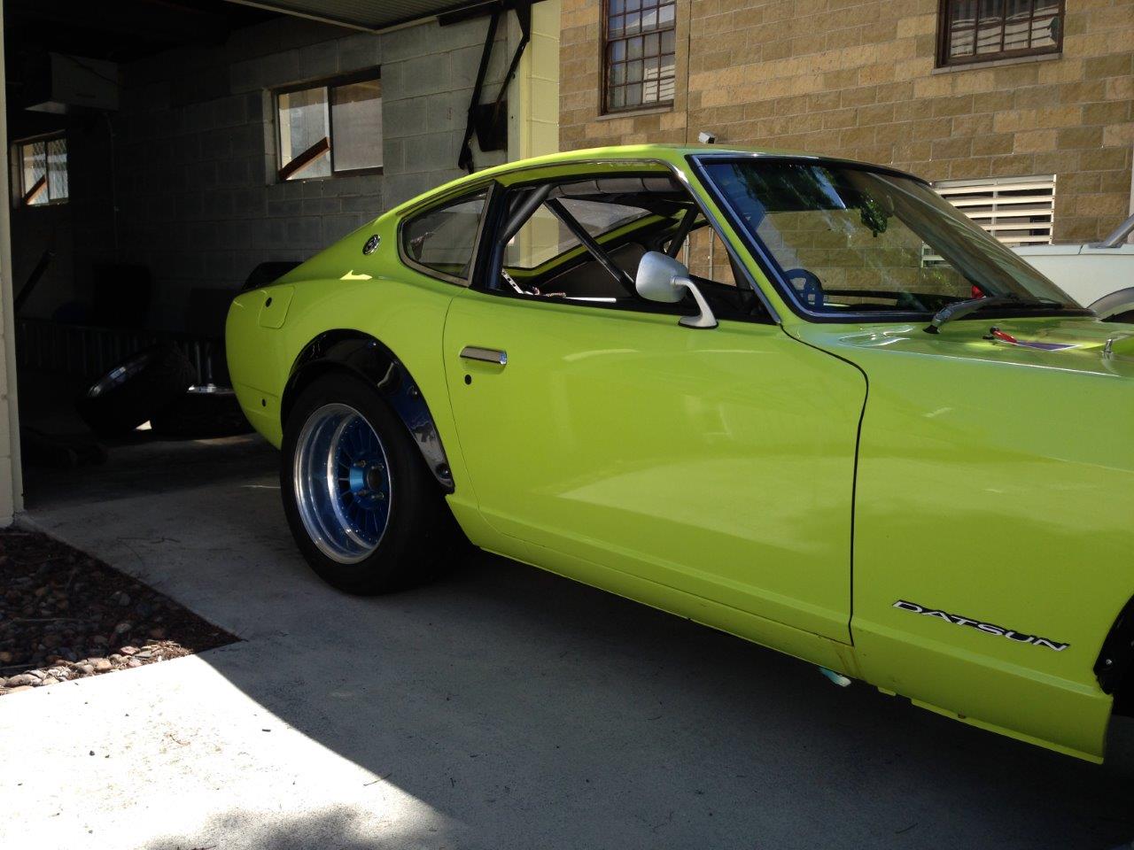

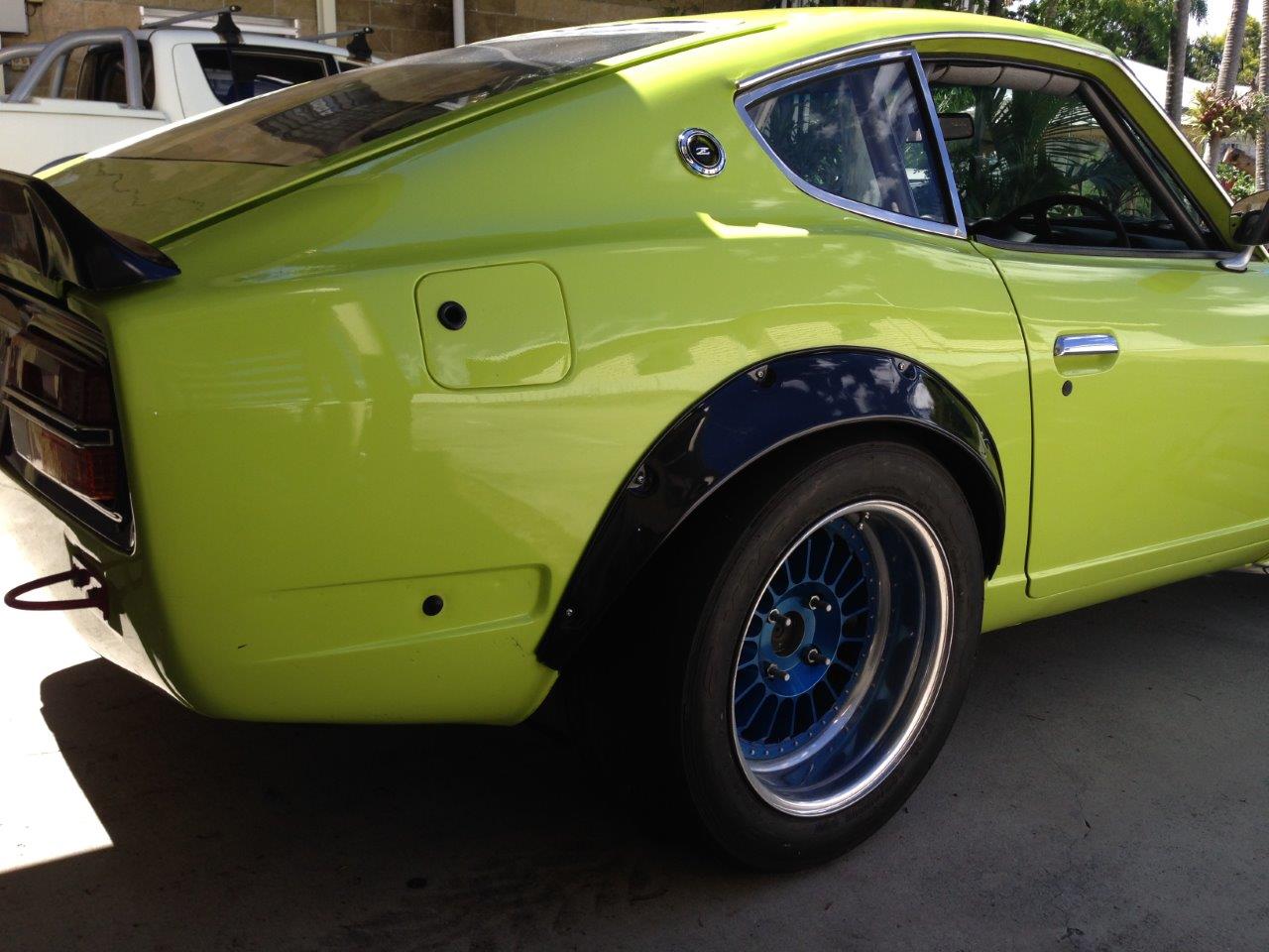

zed74 Posted December 30, 2014 Author Posted December 30, 2014 Car looks better with Race rims fitted Jongbloed 16 x 10 rears (front 16 x 9 yet to be fitted) ALL 0 offset. Quote
