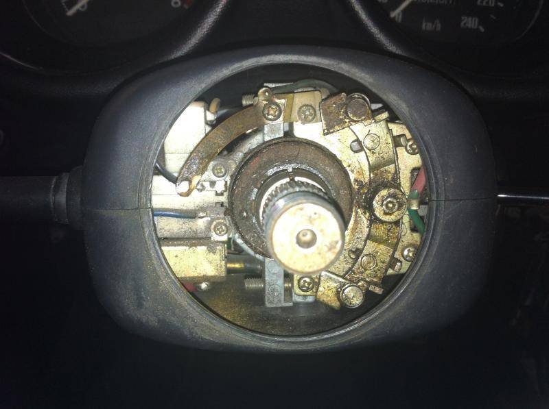

Datsun260z Posted December 26, 2014 Author Posted December 26, 2014 Hi guys although this has gotten the better of me I know I am not the only one here totally stumped by this problem so I am posting pic of my steering column internals in case this helps in anyway.Once again my profound thanks to the awesome Mr Camo for his patient and gracious help here....As can be seen the spring arm on the 260 appears to be attatched to opposite position of 240 spring arm Quote
Mr Camouflage Posted December 26, 2014 Posted December 26, 2014 The previous photos were from LHD cars - they were all I could find on the net. RHD are mirrored, so the same as yours. Its a basic switch design. +ve voltage comes from the spring arm, to the track on the back of the wheel (isolated from ground), The wire carries the +ve to the top isolation ring. When the isolation ring is depressed it makes contact with the second ring which is earthed via the steering wheel/column completing a circuit, closing the horn relay that sends 12 volts through the horns to ground. Make sure the track and the spring arm contact are clean (use a bit of emery cloth or other suitable abrasive paper to clean them up), and maybe apply a bit of electrical grease or vasoline to stop them oxidising. Some tests you can do: With steering wheel off, use bit of wire to earth the spring arm to the steering column centre : horn should sound (If it doesn't you may have a problem with a fuse or the horn relay) If horn sounds, With steering wheel on, use a bit of wire to earth the top ring to the steering column centre : horn should sound If not, then there is a problem with the spring arm not contacting the track on the back of the wheel, or the wire is not conducting voltage to the top ring. Some gentle bending of the spring arm may be required so it makes good contact. Try pressing the horn ring directly, without the centre button trim thing on. Horn should sound. If your horn button is cracked it may not allow the ring to depress properly. Some test you can do with the wheel itself: If you have a multimeter, set it to measure resistance. With the steering wheel off test that there is an open circuit between the track and the centre splines. Have someone press the horn ring, resistance should drop to about 0 ohms. If it doesn't there is a problem with the horn assembly and should should take it apart and inspect it. With the steering wheel on, test that you have voltage between the horn ring (+ve lead) and the steering column (not horn should sound) and meter should read around 12 volts I'd guess. Thats about all I can think of. Quote

Datsun260z Posted December 28, 2014 Author Posted December 28, 2014 Hello again Mr Camouflage--just noticed an obvious difference in the internals with my 260z pic showing black wire attatched to rear of spring arm and your earlier post of the 240z not showing any wire attatched. Also note that spring arm of 240 is much closer to edge of column than my 260.Surely then it must be either of /or combination of both ,that that is creating the problem? What do you think ?? Quote

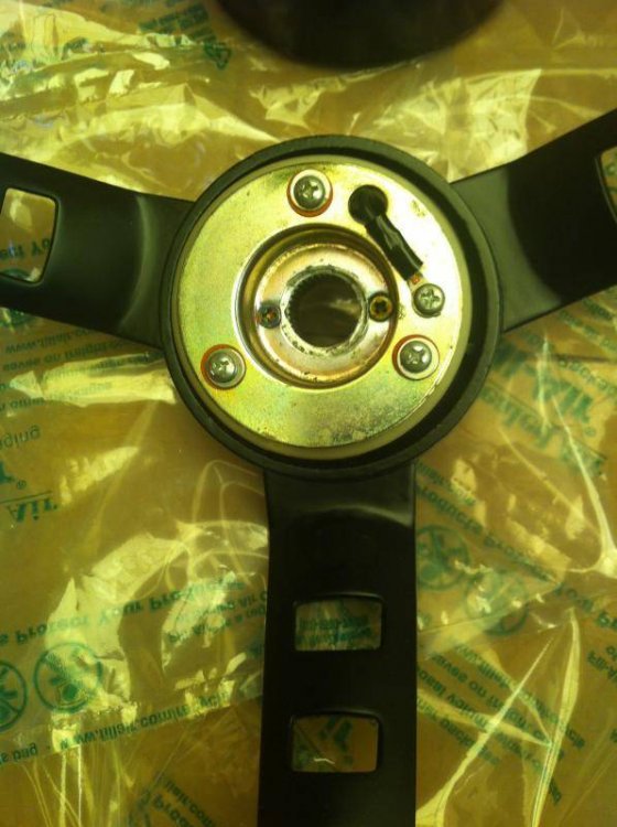

gilltech Posted December 30, 2014 Posted December 30, 2014 Well further to this, I've just compared the back faces of the 240 & 260 steering wheels, & they look identical. From looking at the 240 wheel pic one of you posted, the bit I'm missing is whatever the little black wire attaches to on the front face - on the 240 wheel I bought there's just a hole, whereas there must be meant to be a little captive nut, to screw into, maybe with an insulation collar around it? Can someone please advise? Quote
Mr Camouflage Posted December 30, 2014 Posted December 30, 2014 Well further to this, I've just compared the back faces of the 240 & 260 steering wheels, & they look identical. From looking at the 240 wheel pic one of you posted, the bit I'm missing is whatever the little black wire attaches to on the front face - on the 240 wheel I bought there's just a hole, whereas there must be meant to be a little captive nut, to screw into, maybe with an insulation collar around it? Can someone please advise? Can you post a picture of your wheel centre. From what I've seen in your other thread, it looks like you might be missing the upper ring. See exploded diagram below. From memory, the upper ring had a threaded punch hole that the screw screws into, and the ring directly below it has a cut out for clearance. Quote
gilltech Posted December 30, 2014 Posted December 30, 2014 Thankyou!!! for all your help. That explains it, I'm missing that upper ring #18 & whatever little bolts/nuts/washers #24-28 come with it; I have two push-on padded horn caps but they're both 'empty'. I'm also missing the spring #21; the 260 one is too large in diameter. Oh well, at least I finally know what I'm missing & will just have to keep my eyes peeled. PS. my metal ring part #22 floats up & down on screws atop the nylon ring #19. I presume that the missing ring #18 is also supposed to be secured by those same screws. Not the sort of odd part anyone's likely to have lying around, I'll try advertising but suspect I'll just have to replicate it. Quote
