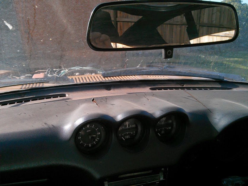

Administrators gav240z Posted November 1, 2014 Administrators Posted November 1, 2014 If this is for your early 240z, there are some minor differences in the early gauges vs later ones. Oil and temp gauges have an extra center delimiter that was removed in later versions. The speedo starts at 20mph and I think there is a couple of other minor changes. Quote
Administrators gav240z Posted November 1, 2014 Administrators Posted November 1, 2014 Best photo I have at the moment of the early gauge with additional delimiters in the center. Quote
GK510 Posted November 1, 2014 Author Posted November 1, 2014 They are for the early 240. I've managed to source a full set of gauges that are supposedly out of another early model so should be all good. They seem to be the same as what is currently in the car and also match the pic you posted. Not that I really needed a full set of gauges but it can't hurt to grab some early spares while they're available. Quote
