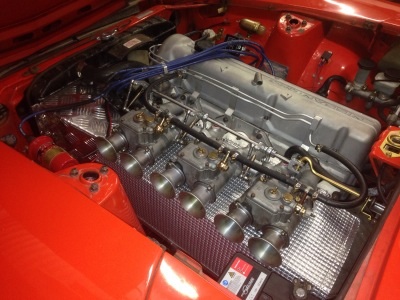

Cozza Posted September 4, 2014 Posted September 4, 2014 I'm happy with my kit from Pierce Manifolds. http://www.piercemanifolds.com/product_p/pm3701-l.htm Quote

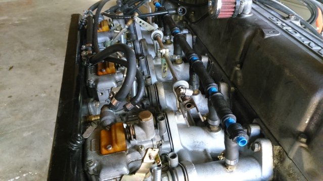

Retro Z Posted September 4, 2014 Author Posted September 4, 2014 Thanks Cozza. Looks heaps better than what i have. Has it held tune over time? Here's mine although it looks ok, it could look much better. Quote

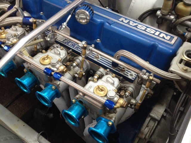

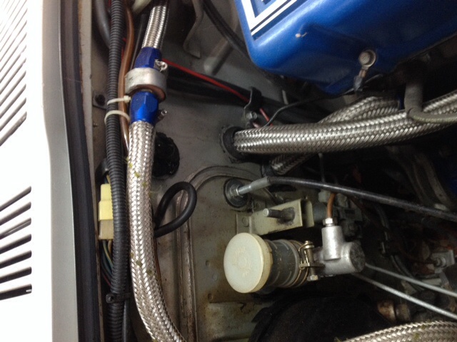

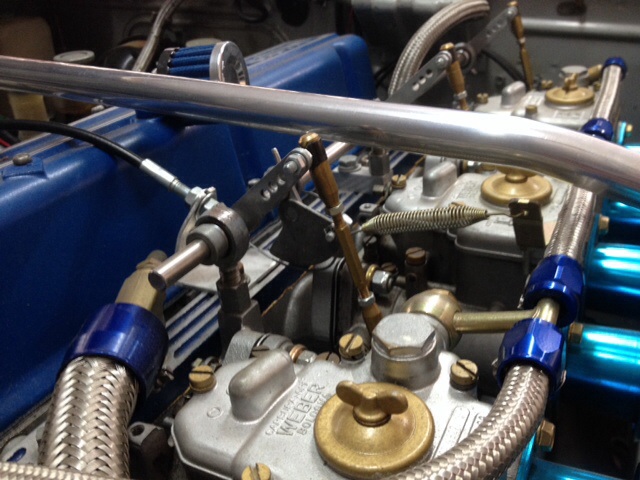

chris240 Posted September 5, 2014 Posted September 5, 2014 On my tripples, my carb guys eliminated all the linkages along the firewall, and the rose joints, and did a neat cable conversion where the cable runs thru a central bracket on the middle of the rocker.. The guys at dyno tune canberra have done this on all the race zeds they have prepped, Lurch saw it a few years back and commented on how simple and neat it was.. If it wasnt so cold outside Id take a pic . Quote
Retro Z Posted September 5, 2014 Author Posted September 5, 2014 Sounds tempting. If you can get a pic (when you can) that would be great. I am trying to eliminate clutter in my engine bay so this cable setup sounds good. Quote
chris240 Posted September 6, 2014 Posted September 6, 2014 The bracket is fixed onto the manifold not the rocker...my memory is getting worse. 3rd pic shows peno thru the firewall and the redundant linkage bracket.. Quote
Retro Z Posted September 6, 2014 Author Posted September 6, 2014 Thanks for the pics. Your engine's a work of art.. Quote
