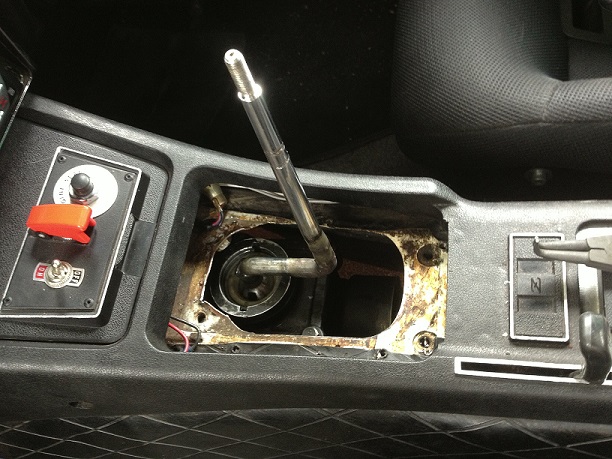

Have you re-fitted the centre console to see if the gearstick fouls when selecting 1st, 3rd, 5th?

What gearbox did you install? I put a r31 skyline box in my 260z 2 seater and only had to take less than 1cm from the front of tunnel but it was still fouling the console so then had to bend the stick slightly back and problem solved. I suspect if I had just done that in the first place maybe we would not have needed to cut anything. I used the OEM inner rubber boot & metal retainer from a 240z and it fit no probs. In hindsight I would have stuck with a 260z box and not the skyline. If you cut alot you may have to just go to your local parts shop and get a universal boot:
cheers, Mike

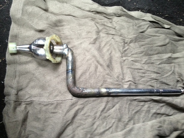

My car was originally an auto. With the console out just measure back from the shifter 'ears' on the gearbox and stop when you are in the centre of the trans tunnel opening. You'll end up with something like the pic below. It's easily done with an oxy torch, or cut and weld. You can use the stock Nissan rubber inner boot and the pleather outer boot
I liked it so much I used the same stick on my RB box, but I had to weld the RB ball onto the bottom of the Z stick.
EDIT: The trans tunnel was shaved a tiny bit when fitting the RB20det box.
