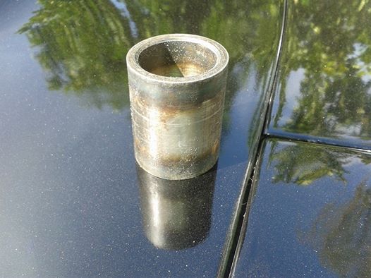

Scoota G Posted February 24, 2014 Posted February 24, 2014 Here's a question. Is the spacer the same as 260Z? Quote
Scoota G Posted February 24, 2014 Posted February 24, 2014 On this spacer you can see how heat has effected each side near the bearing. Must have some pressure on it!! Quote
lampy Posted February 25, 2014 Posted February 25, 2014 I know on a 1600/180b trailing arms which is nearly identical to a 240z/260z there is a letter A, B or C stamped on the top on the bearing housing. This corresponds to a A, B or C on the spacer. Different letters are not interchangeable. Some spacers are larger to adjust the crush on the bearings. It may be the same on the Z rear hubs. I think it talks about it in the manual Quote
