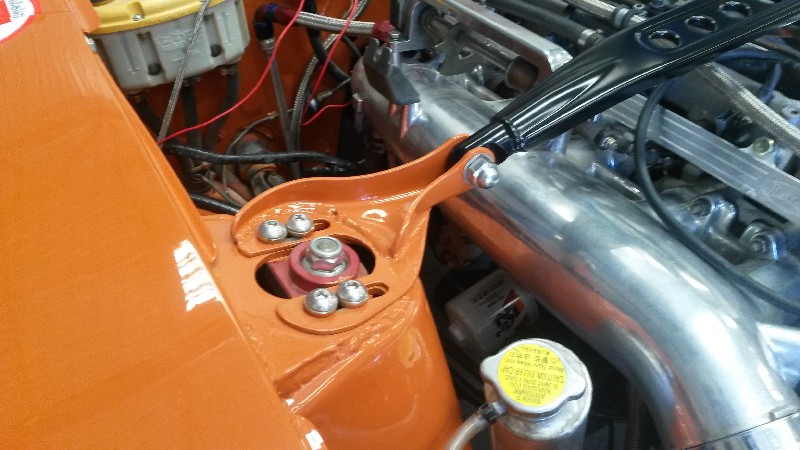

Gee260 Posted February 22, 2014 Posted February 22, 2014 Hi installing my coil over tops from arizona and looking at strut braces and want a triangle front just wondering if anyone has any pictures of how the have done it with azc or simiular coil overs cheers guys. Quote

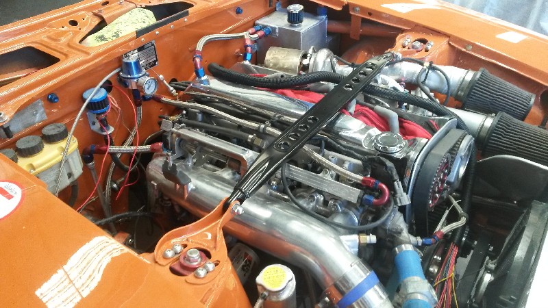

Ledge Posted February 23, 2014 Posted February 23, 2014 Hi Mate I used a Mazda RX7 strut brace. Just modified the ends and welded to a fabricated plate Hope this helps Cheers Paul Quote
Gee260 Posted February 23, 2014 Author Posted February 23, 2014 Yea looks awesome exactly what I'm looking for. What year rx7 and what engine u got there?? Can't quite see on my cracked phone hahaha Quote
d3c0y Posted February 23, 2014 Posted February 23, 2014 A lot of people just weld tabs to the strut tower. You just run a conventional bar with rod ends then. Quote
Gee260 Posted February 24, 2014 Author Posted February 24, 2014 That is also dry helpful thank you Quote
