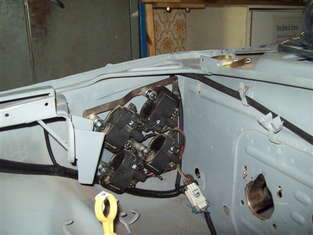

Scott - While you're at it you should relocate the coils, I might be old-fashioned but in my opinion they really detract from the appearance of the engine bay. I relocated mine to the inner guards but you can please yourself where they mount.
