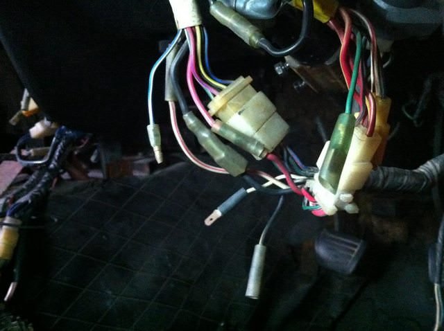

Magnet Posted January 9, 2014 Posted January 9, 2014 Trying to get my electrics up an running, need help identifying some homeless plugs. Especially need to know which wires are for the hazard switch/relay Green, blue w/white, black w/white, white I know the plug on the right and the green and blue next to it are for a little box and relay that I need to find, but not sure about others Stuff around the stereo Any help much appreciated! - Ryan Quote

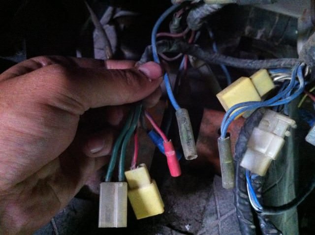

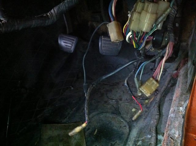

Moderators Zedman240® Posted January 9, 2014 Moderators Posted January 9, 2014 In the top pic, that black plug with the insulated cover is for high beam and I think plugs into that other bullet plug.. just trace that male bullet plug wire and see if that goes to the high beam switch. Have to check the rest in that 1st pic. In the second, the blue and green wires look like they are for the flasher can. Bottom pic, plug with the larger green wires is for the electric fuel pump and isn't used, single blue I think is for the blower and not sure on the others...its hard to do without being there in person. Hope that helps! Quote
Magnet Posted January 9, 2014 Author Posted January 9, 2014 Everything helps! Yeah it's hard just from pictures, forgot to say car is a '71 The high-beam/low-beams are working so it's not that wire(there ARE two black wires you have to connect from stalk to stalk though for high-beam). I have tail lights, basically just need indicators, brake lights and reverse for rego. Hazard switch/relay and flasher can should sort it if I can find where they go Quote

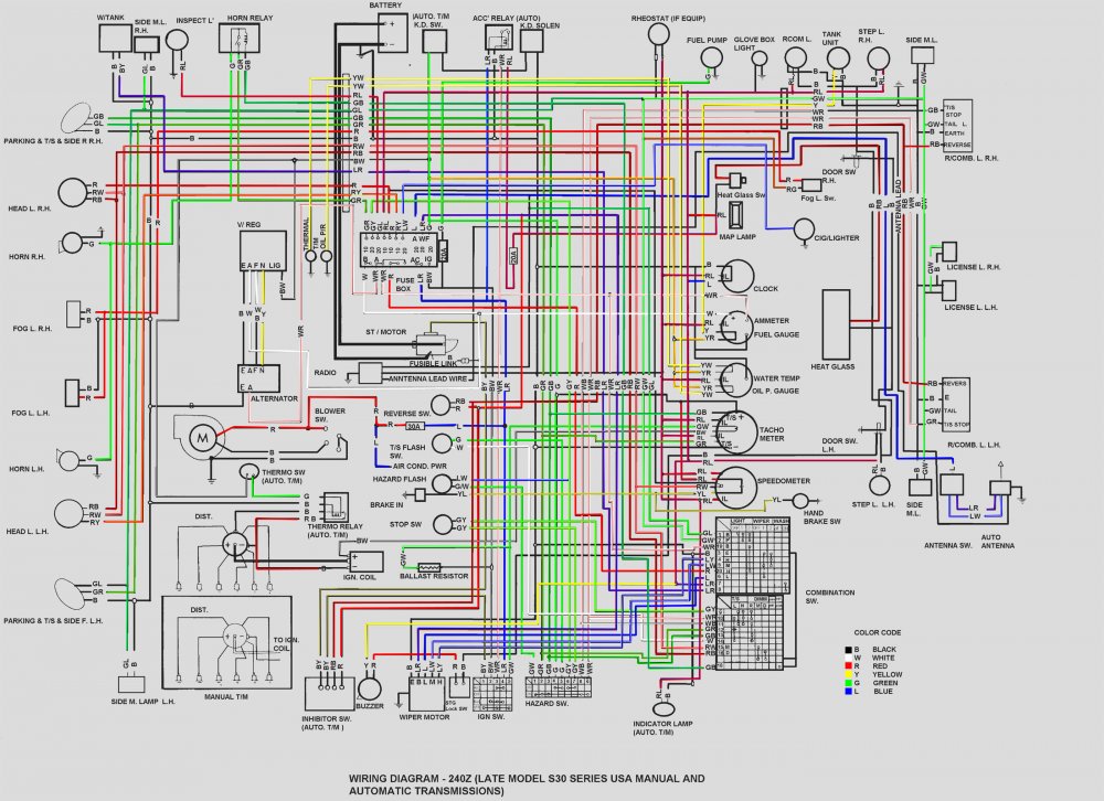

Six_Shooter Posted January 9, 2014 Posted January 9, 2014 Download the FSM here: http://xenons30.com/ Quote
NZeder Posted January 9, 2014 Posted January 9, 2014 This might help a little too - I know it is for the LHD model but I have found Nissan did not change the looms much so the colours should be the same. http://www.airmayer.com/images/240z/earlywire.JPG Quote
