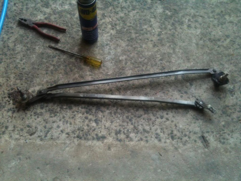

The far left piece is really all I need but am willing to take the entire unit.
                      By that you mean the pivot unit that the Wiper blade unit connects to. I can cut the unit down for you & send both ends if you wish.
You can free these up with Penetrene or WD40 I have previously pulled my cars unit completely apart cleaned & used wet n dry to clean back to bright metal then re assembled with marine grease on rotating parts & it works fine.
                                                                        Regards: Alan.
All sorted, thanks, Alan.
Soaked it in penetrating oil overnight and it's broken free.
