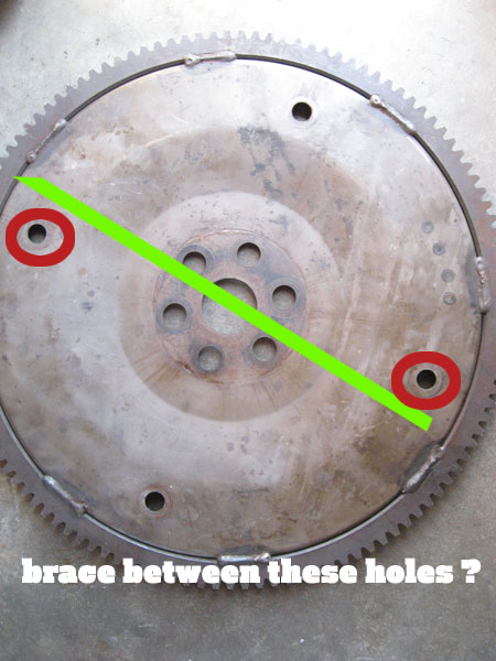

modular9 Posted January 7, 2009 Posted January 7, 2009 zeddophile : I think he already has the gearbox apart from the engine but i dont know how he parted the flexplate from the crank. I used your method on my rebuild and it works superbly. Chris240 : How the heck did you part the flexplate from the crankshaft ? that was harder for me than the four wittle eensy bolts!! 1. If you are junking the torque converter then you could slide a long handled screwdriver between the mounting areas on the converter and use that to brace against. They are square little raised sections where the bolts bolt into. ( see image of my flexplate when it came off. ) 2 . drill into the converter on one side so you can insert a bar or something into it. Then insert bar and brace against it. OR even better pierce it right through so you could 3 . Put the ring spacer and the bolts ( find some nuts to fit ) back onto the flex plate and then slide a bar between the bolts to use as a brace. Warning : Flex plate is really really really easy to bend. and also I didnt need to do anything of the above as zeddophiles works if your engine and gearbox are still together. Quote
