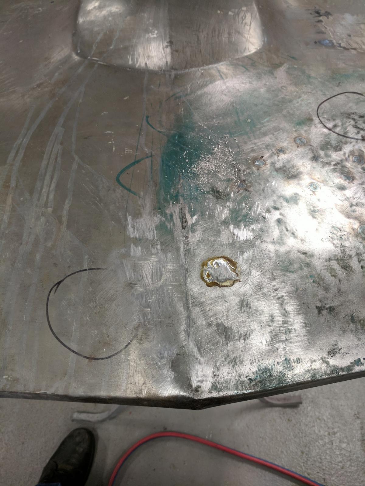

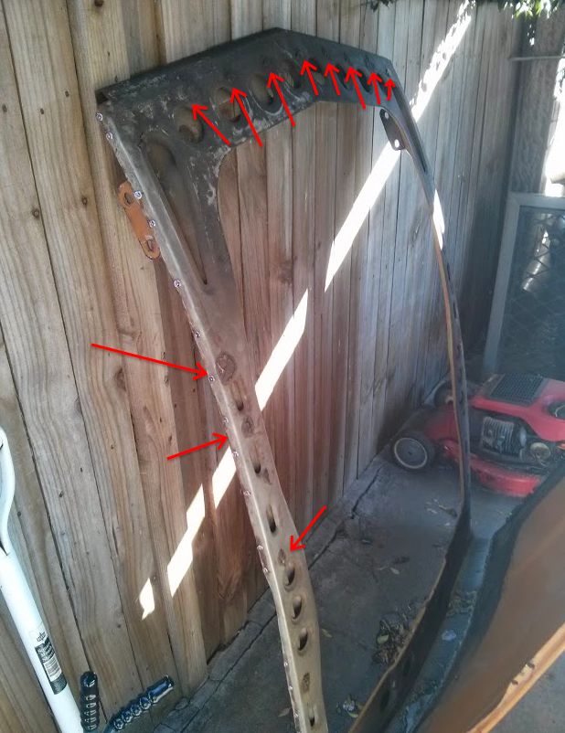

Administrators gav240z Posted September 1, 2017 Author Administrators Share Posted September 1, 2017 The shrinking disc did more damage than it fixed I'm afraid. So had to do a whole lot of heat shrinking to re-work the panel. Chalk that up as another mistake while working on this part. LOL... So only minor updates.. 1. I filled in the holes where the badge was, because someone had elongated them too large. So we used body solder - which is much like using a soldering iron with flux/lead. Video here shows the process. Although instead of a butane torch, we used a soldering iron (electric) to melt it onto the bonnet. A bit tricky with a larger hole, but managed to fill it, then file it down. In the photo below you can see 1 side has been filed and the other not yet. 2. Next step is to get some kind of panel adhesive to bond between the frame and skin. I might actually weld it into place first, then squirt the adhesive in afterwards to prevent the chance of creating a high spot (if the adhesive is too thick) or low spot if the adhesive pulls the panel "in" too much. I'm not sure what material the factory used, but I'll likely use something like this Lord Fusor stuff. https://www.lord.com/products-and-solutions/adhesives/fusor-121124-flexible-foam-(super-fast) 3. How it's sitting at the moment (photo before the holes were soldered up). Rickers 1 Quote Link to comment Share on other sites More sharing options...

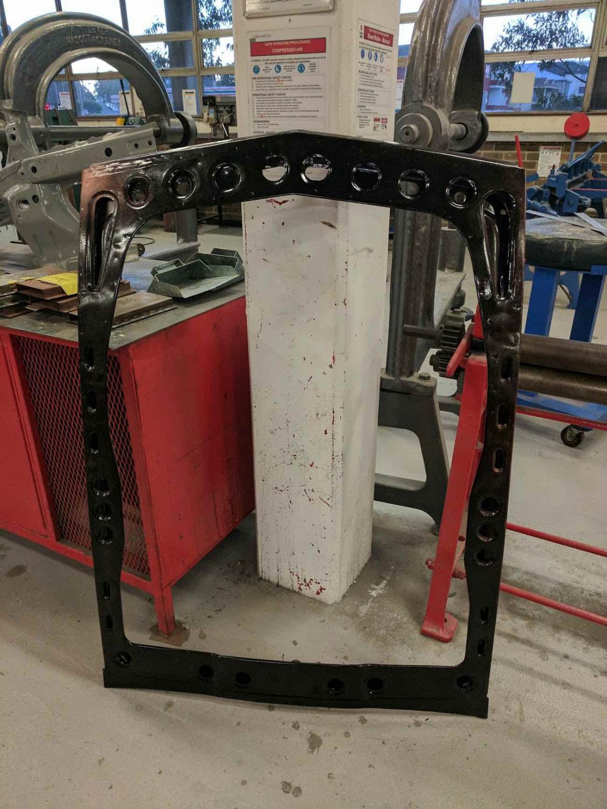

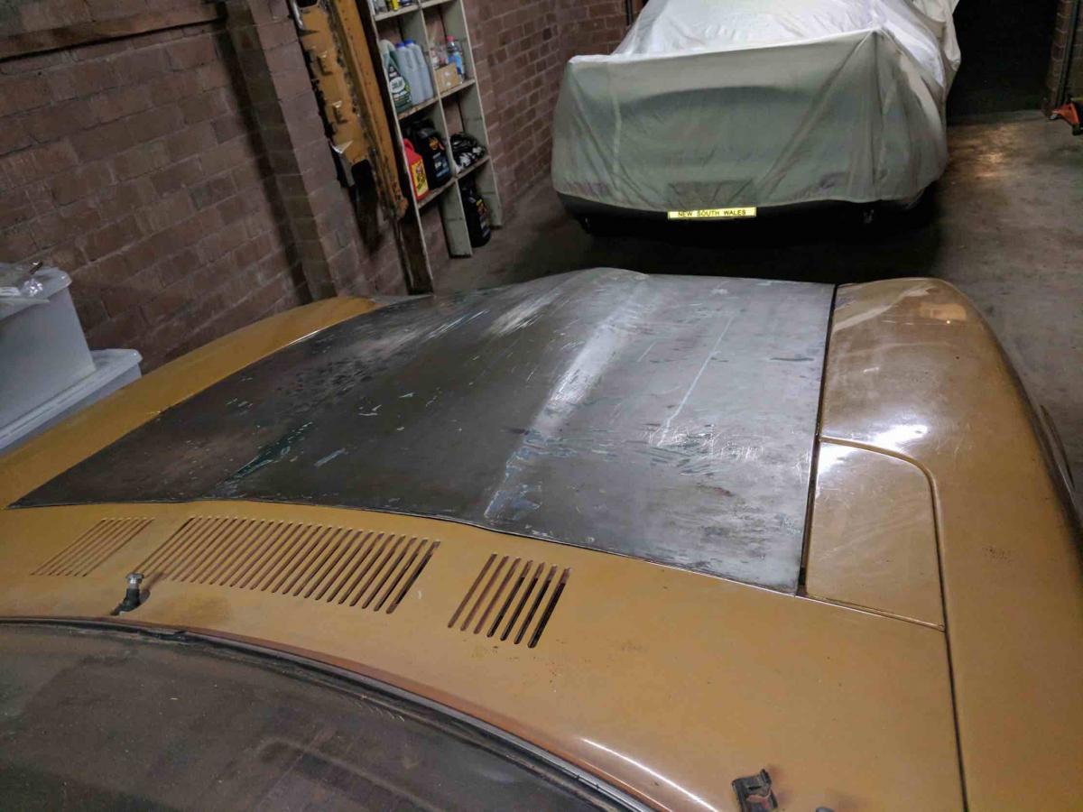

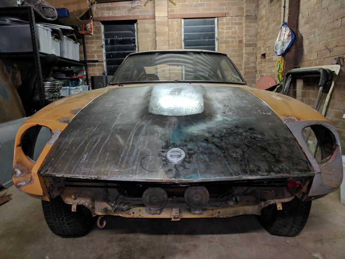

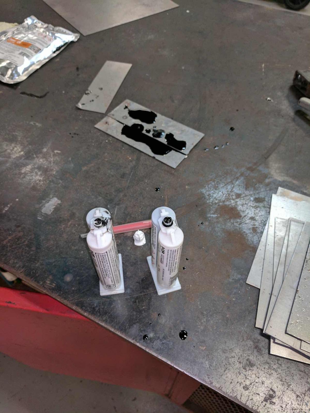

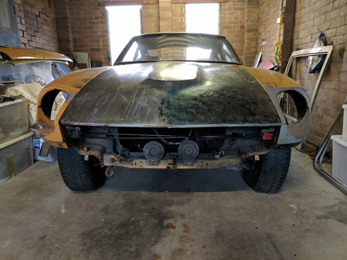

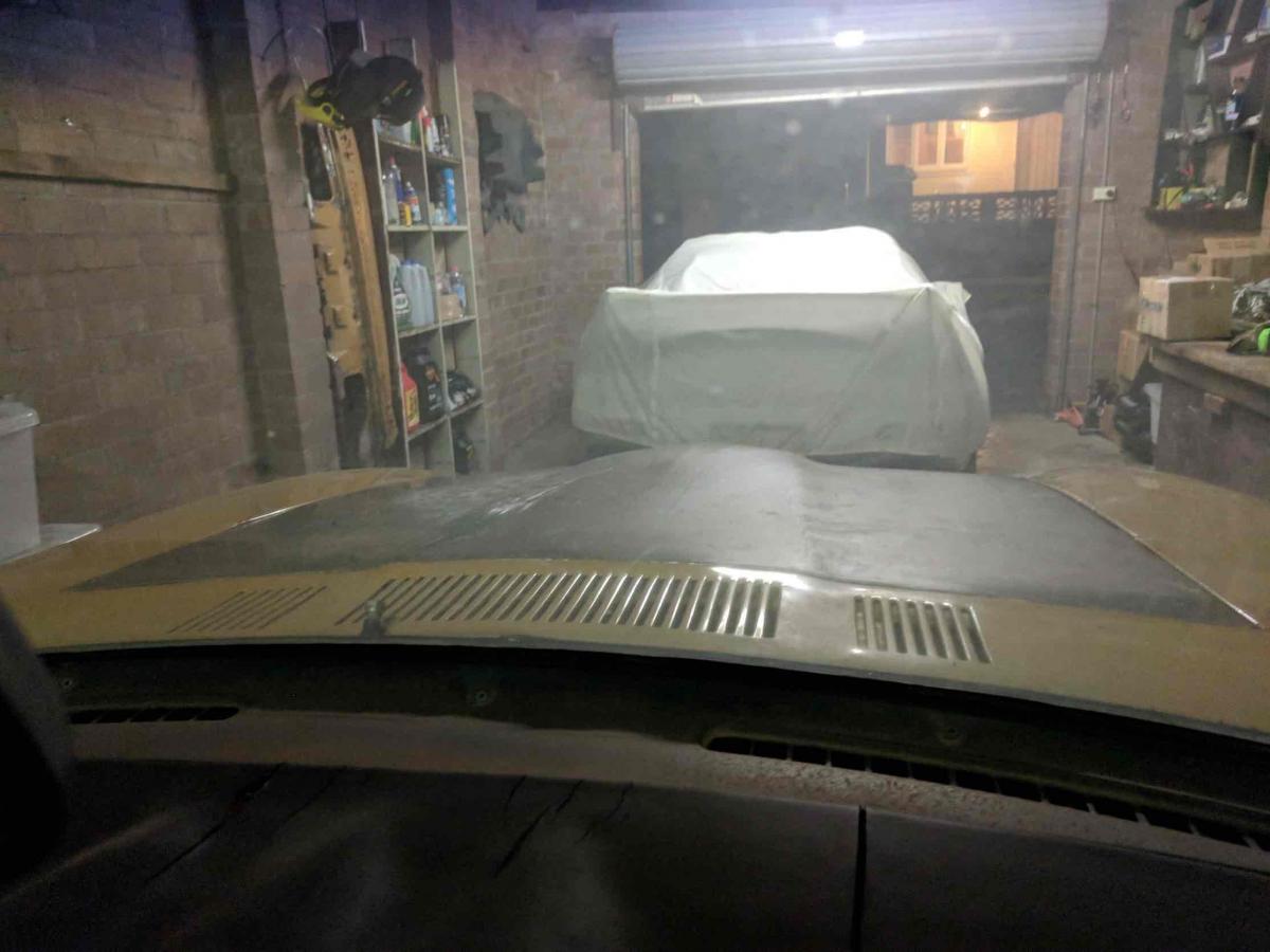

Administrators gav240z Posted September 5, 2017 Author Administrators Share Posted September 5, 2017 So... I had painted the bonnet frame with KBS rust seal. The plan was to use the anti flutter foam adhesive between the frame and skin, but the stuff I bought Monday from Autolac was unfortunately just past it's ideal 24 month use-by and as a result had gone hard. So that was a good waste of money and time... make sure if you buy these products you buy them right when their going to be used as they expire and go hard and then are useless. So plan B was to weld and join bonnet frame and skin together and then add in the adhesive through gaps later. The good news is now the bonnet sits nice and flat. When trying to align it before the fact that the skin wasn't fixed in place just made things harder. Now that the skin was welded in place I could fold the rear lip back over the frame. This allows the bonnet to sit flush all around (rear side also). I realise the photos don't show a huge difference, but trust me each step in the process has been significant but not necessarily easy to convey through a few images. You kind of need to see the panel in person and feel it with your hands to see high / low spots etc.. My favorite new view, looking down the bonnet from the driver seat and no flutes! All the years I've looked down my 72 bonnet at the flutes and wished they were not there. My first car was my 73 240z and I just loved peering down that long smooth bonnet. Some final minor adjustments to the front edge are required and it's not welded to the frame along the front edge yet. I'll be doing that with it on the car to make sure I get it right. Quote Link to comment Share on other sites More sharing options...
