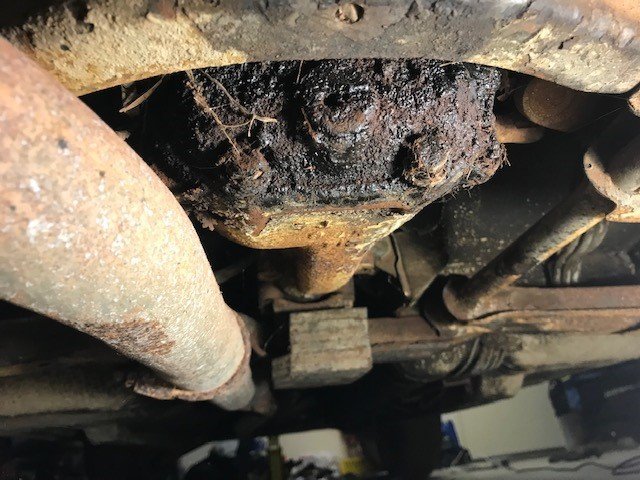

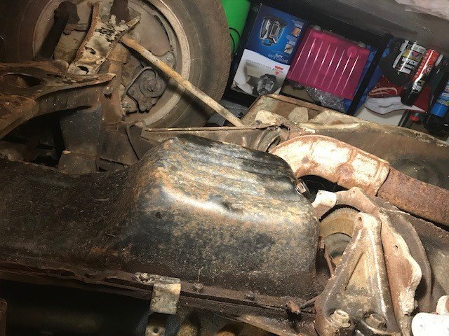

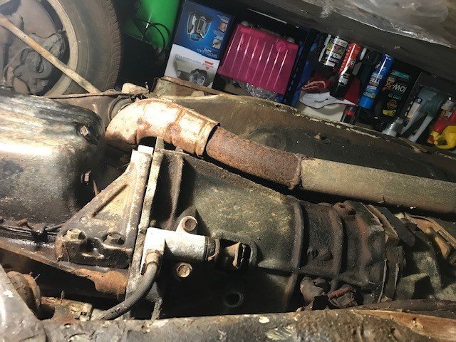

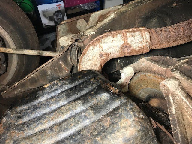

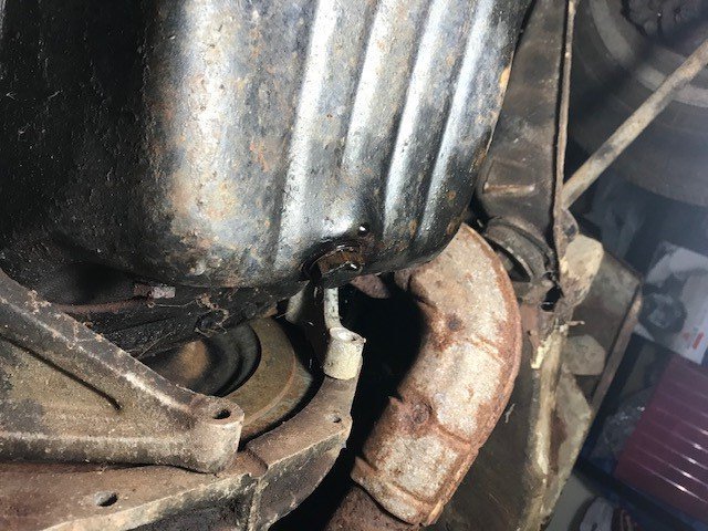

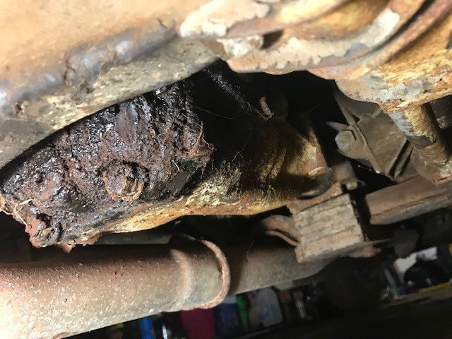

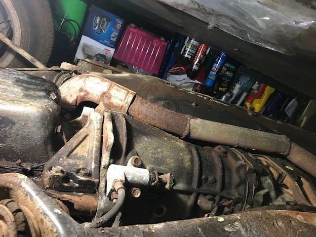

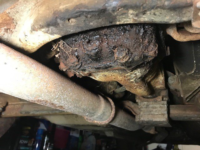

  1. Ok here are pics of the gearbox and diff. Not sure why the photos of the gearbox are appearing upside down because i turned them right way up before uploading too
  2. Nope not sure. I know it’s a 5 speed box. How do I check if it’s a 260Z gearbox or something else? Also is there a way to check what the rear diff type is? I know the L20ET came in the Skyline R30. Maybe the gearbox and diff is from it too?

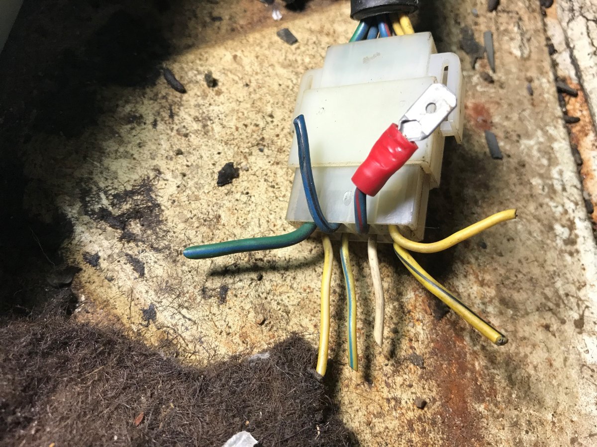

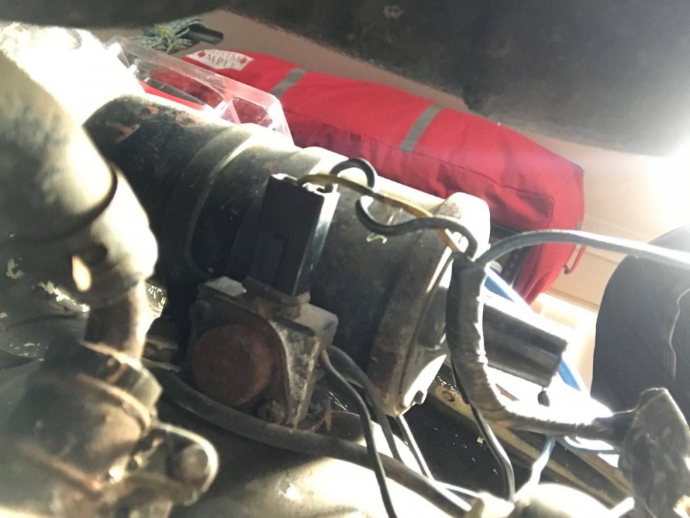

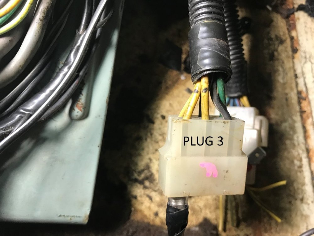

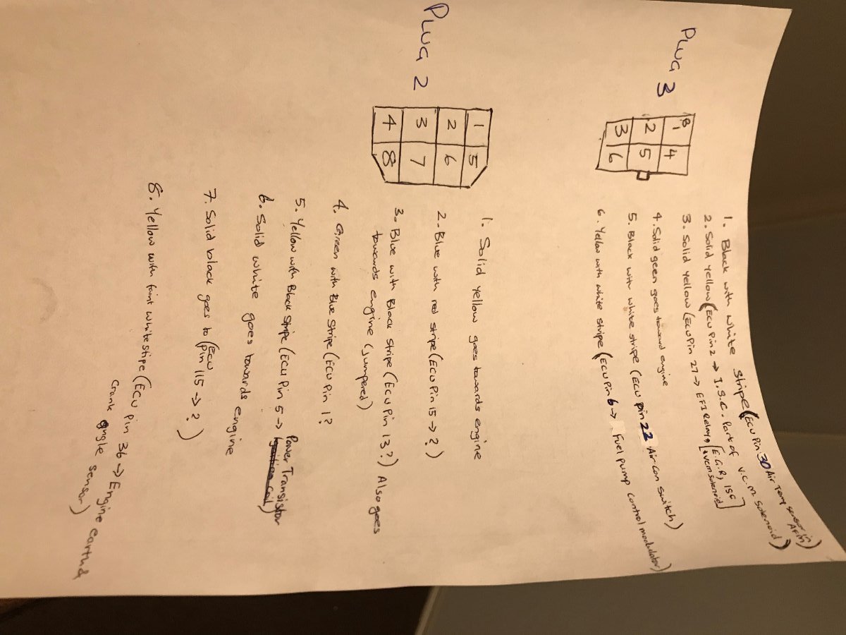

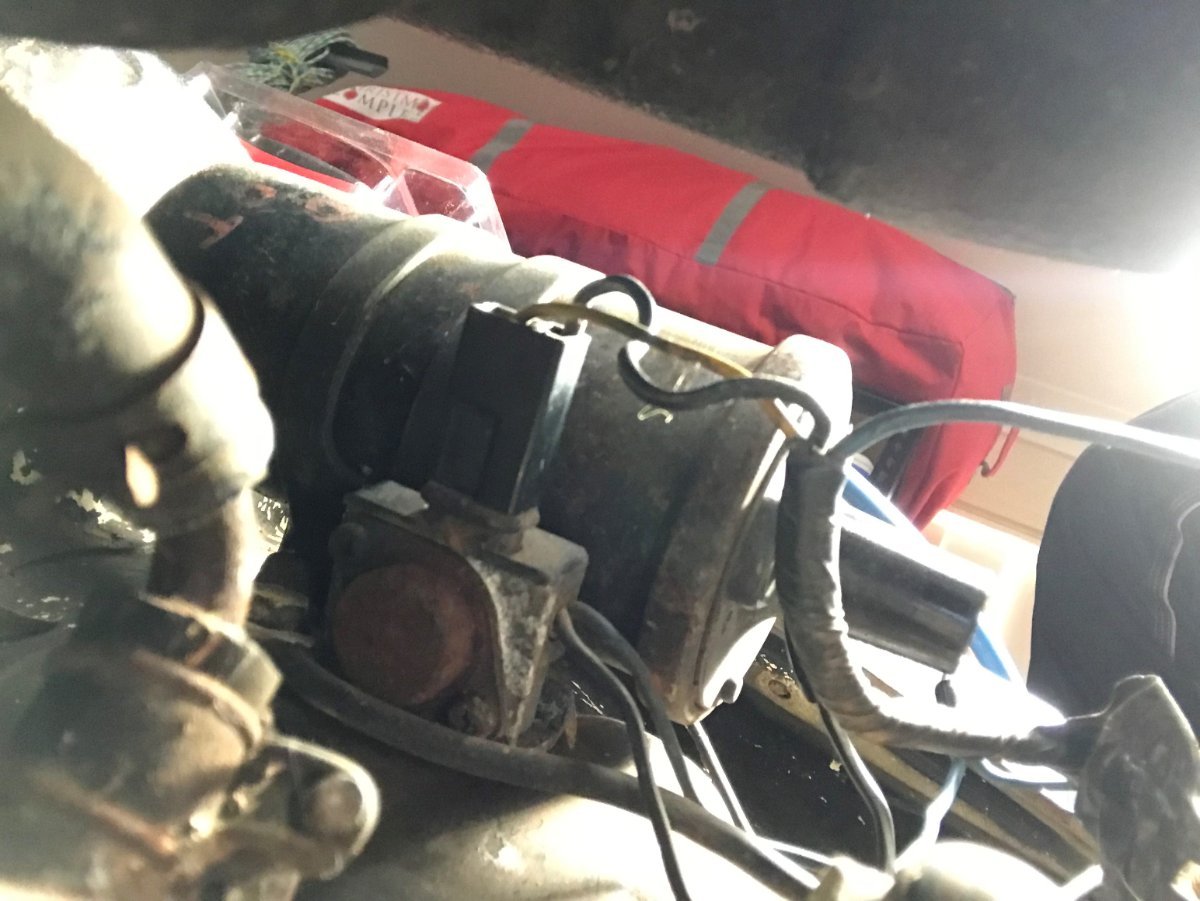

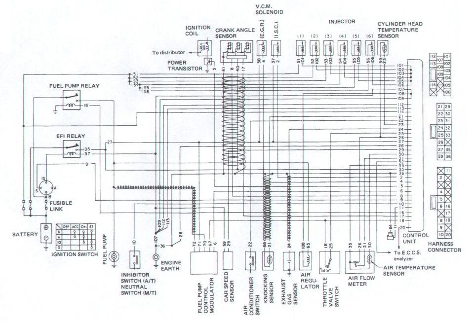

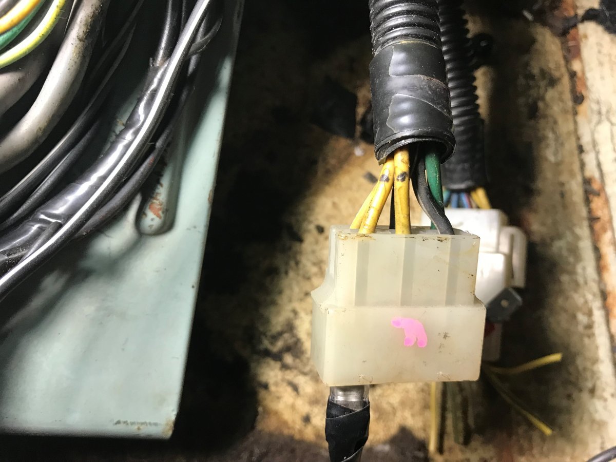

  3. Yea it was always a 260z. I checked the ID plate on it and it says L2605. The original loom is still in tact from what i can see in the engine bay. The loom that comes out from the drivers side firewall goes to fusible links, starter motor, alternator, headlights etc and then wraps around from the drivers side to the passenger side from in front of the radiator. The end of this loom is what I believe is meant to go to the ignition coil. This end has had a few cuts and splices. From what i can gather, the engine has its own loom that runs back to the ECU for fuel injection and all the sensors. I think i need to figure out how to integrate this loom back to the rest of the car and the ignition coil to get it running.
