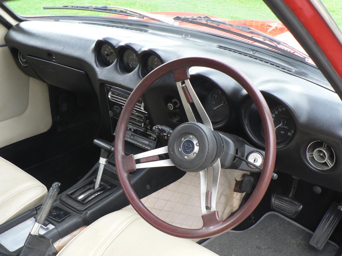

It came installed in the car but I do have the original steering wheel without the horn pad as part of the deal. Anyone have a spare horn pad for sale? Thanks gents

Hi gents, Can someone please identify this steering wheel.? Some said it came from Datsun 240K. If it is.. how rare is this as compare to 240z original which got " Datsun" or "Z" on the horn pad. Cheers
