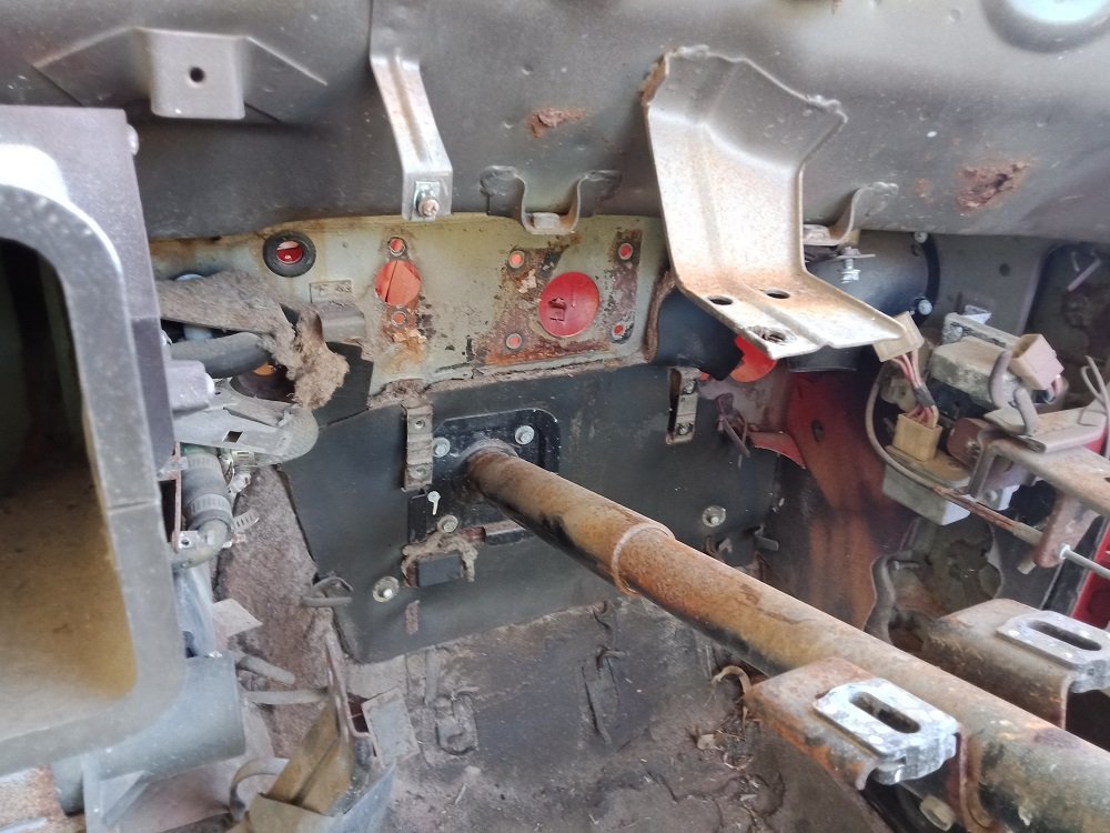

  4. You are right about the dash mounting points. I sat the 240 dash in place on the 260 front cut and some of the lower brackets are different and don't line up. The 240 also has a couple of extra mounting holes along the top section. Easy enough to rectify when your doing a complete bare shell resto.

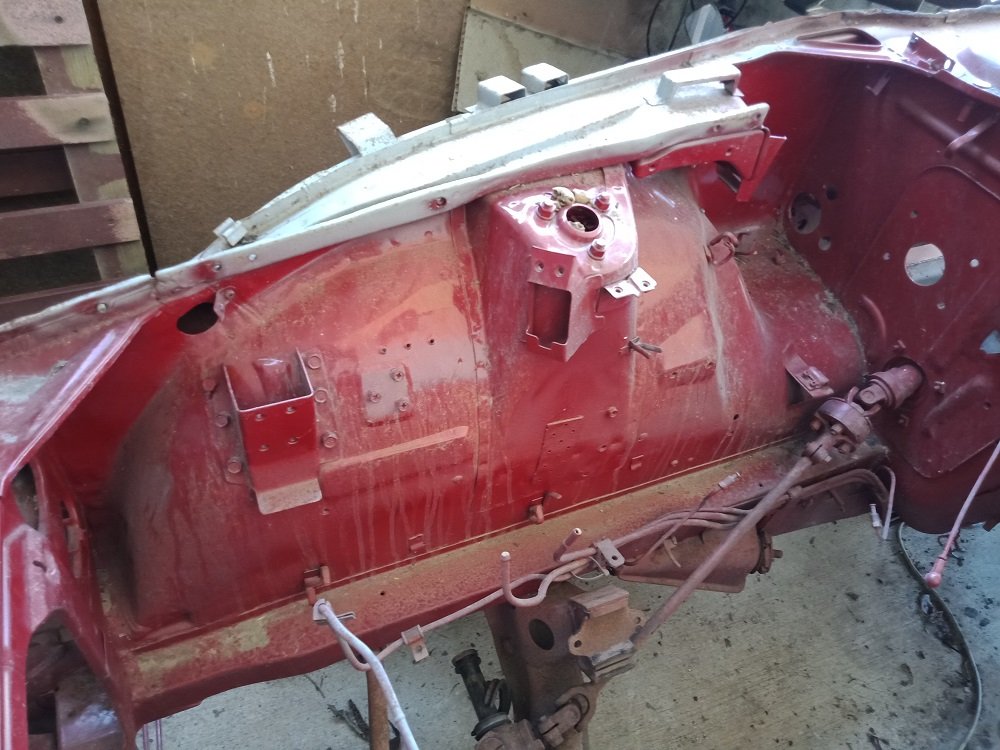

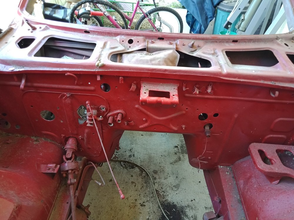

  5. I'm starting to worry after what you've just said, but it's good to know - I want to know. I bought the front cut and roof off a guy in Gold Coast. He drives a bayside blue 260 flared with an RB26. He purchased a whole car and chopped it up cause he needed the rear for his. I think he was kicking himself for chopping it up, as it was in very good shape. So I scored the roof and front, my roof has a sunroof in it. I'm letting my panel beater decide what the best course of action is, but I think we'll use as much of the 260 as possible. (I think it's the only way to save the car) We'll probably attach through the 'A' pillars and half way along the sills. I want to cut out the entire 240 firewall and transfer it over to keep the vin and all the holes correct. My 240 radiator support is in poor shape. I've seen on ebay someone that makes them and a mob in England makes them too. I guess if I changed it, the front would retain its originality and please the purists - arghh it's only money! I'm still learning about the zeds but I was under the impression the 240/260 had the same dimensions, the 260 being a mere facelift at the time, but please correct me if I'm wrong. I'll check the dash mounting points, better to know now then when I'm starting to re-assemble. Thanks again.

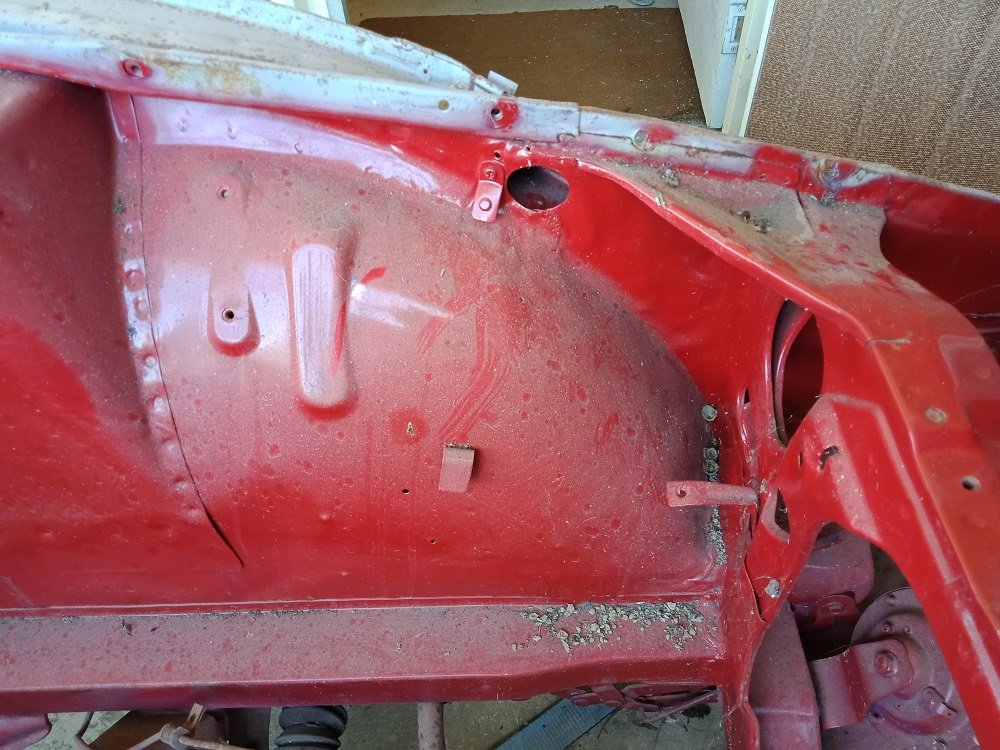

  6. No ID tag just chassis number. Will try and make it look as 240 as possible (removing unnecessary brackets) All the 240 panels will still bolt up right? Guards, grill, bumper brackets etc? Have yet to sit them side by side for comparison analysis.

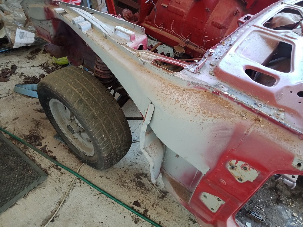

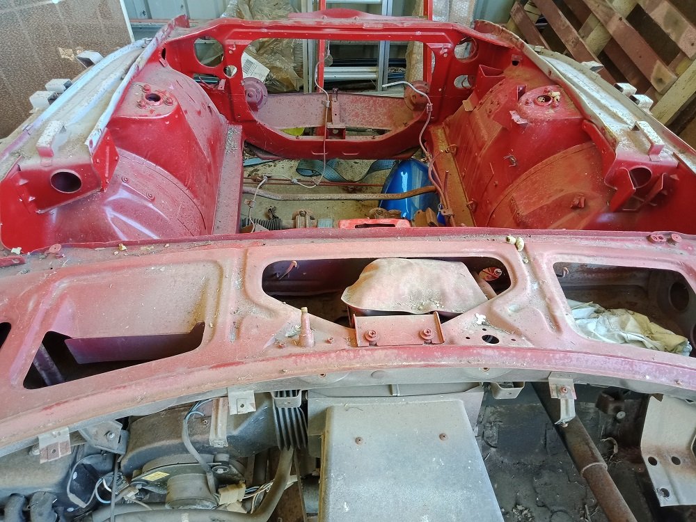

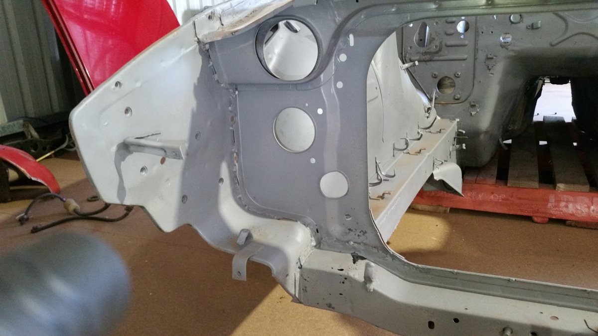

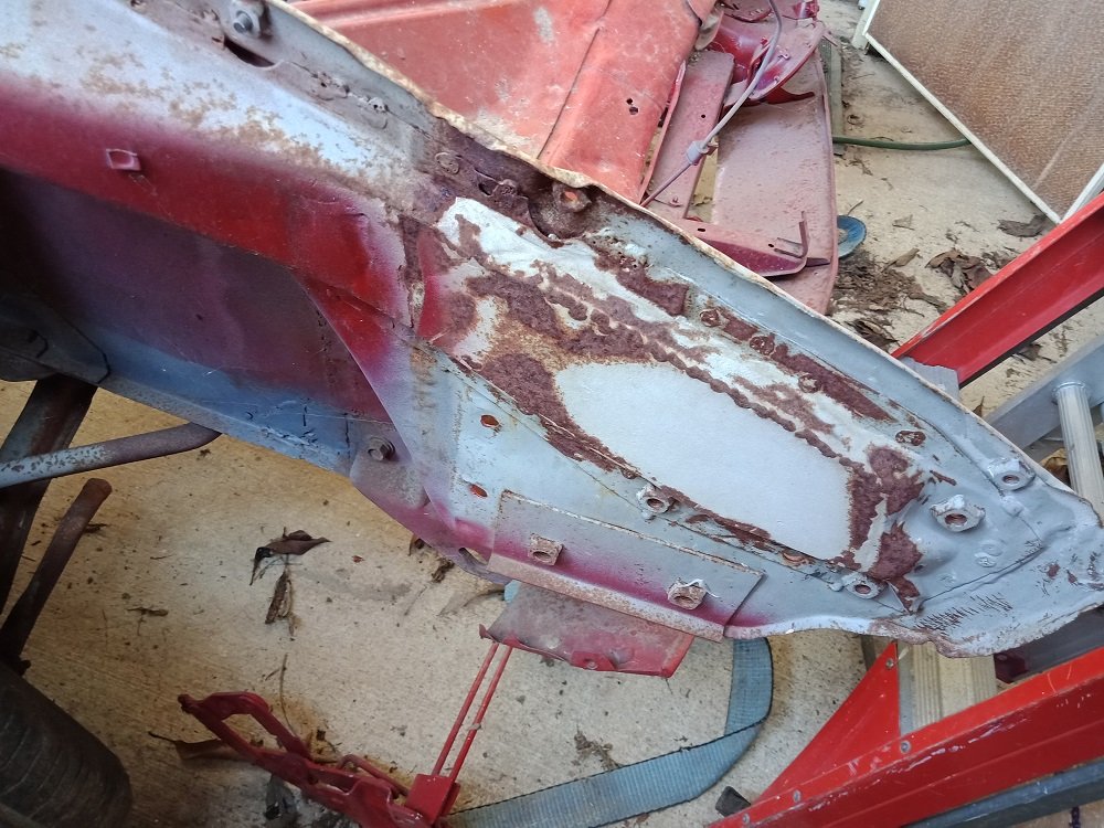

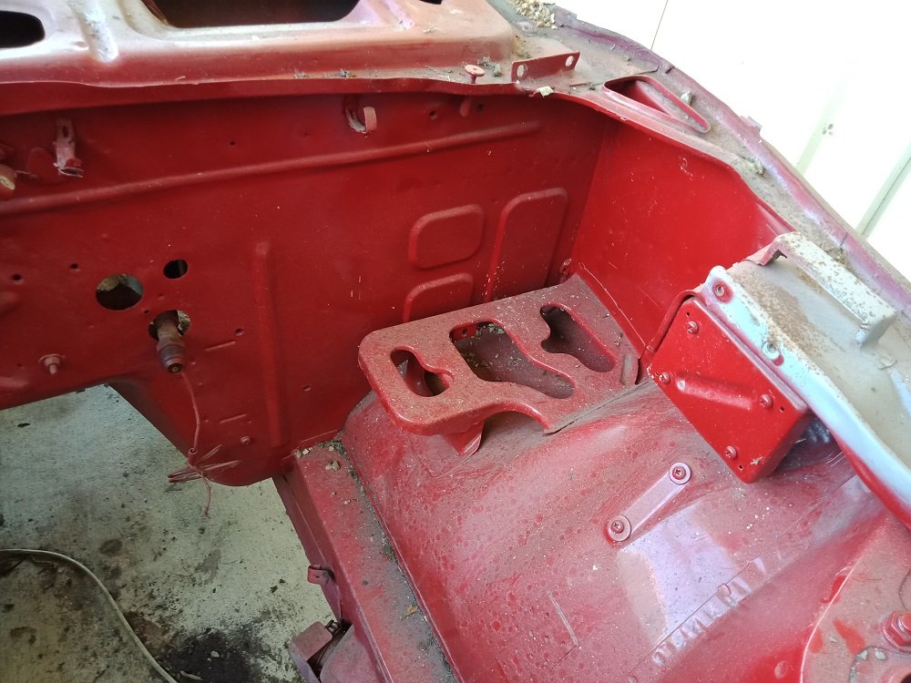

  7. Has taken me awhile to update this post. This is the 260 front cut I bought, very clean virtually rust free, just some mild damage to the RHF section. Heater and air con holes will have to be modified, but please let me know what else you notice that I might have to change.

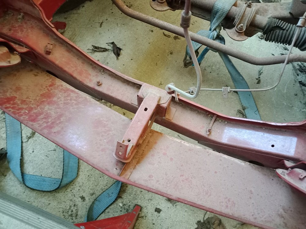

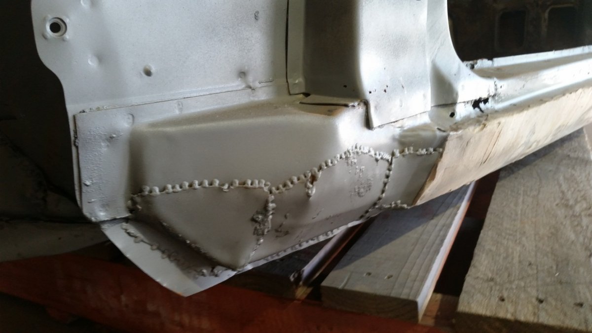

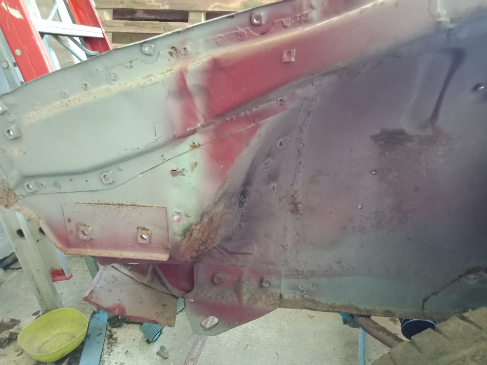

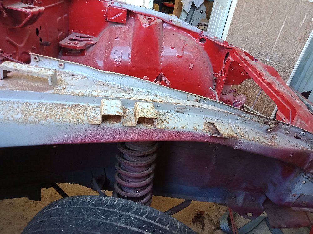

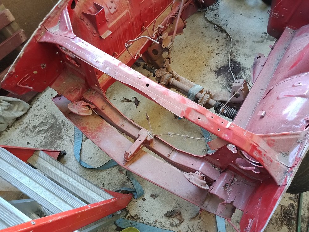

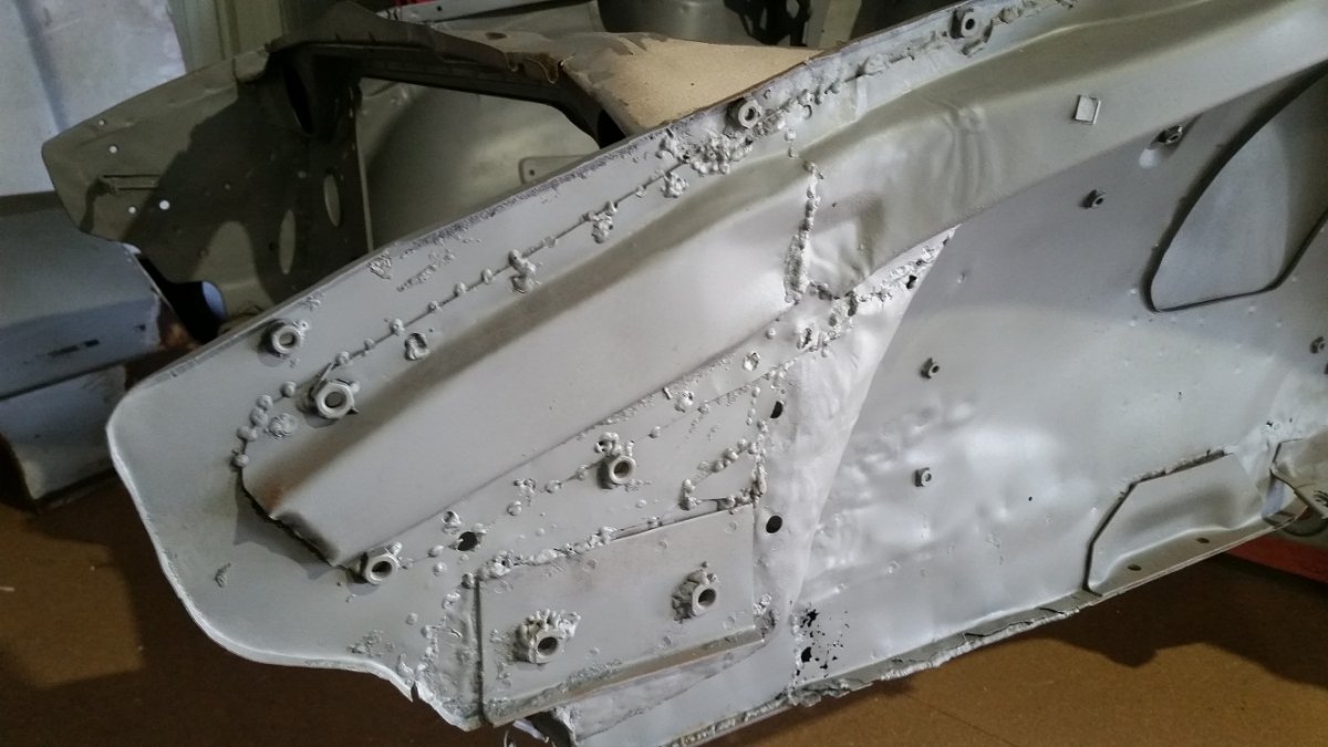

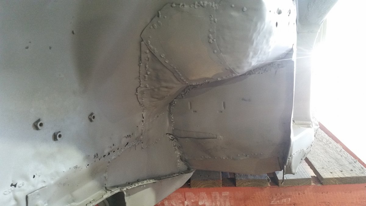

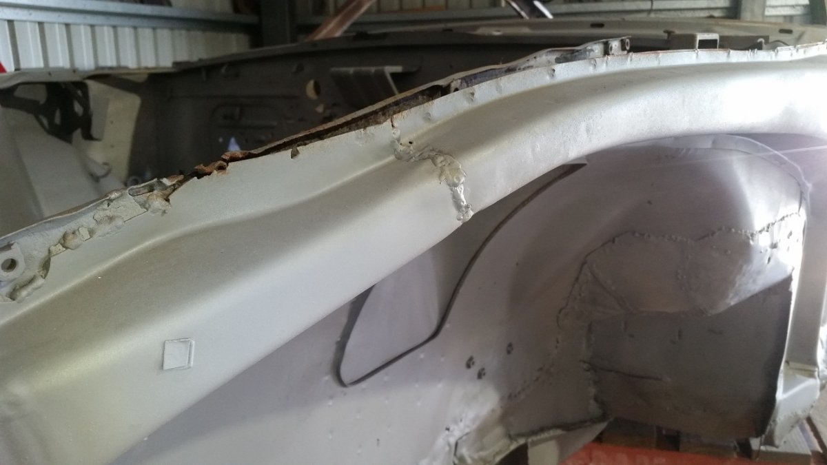

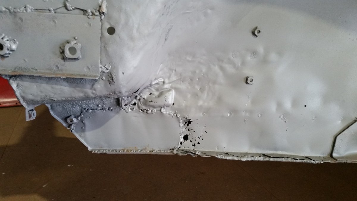

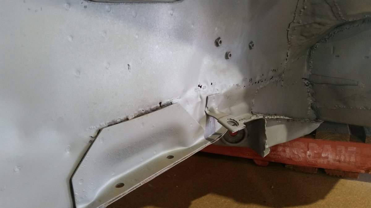

  21. Thanks for your feedback Gilltech. I wouldn't be overly keen to fab on the 260Z front end, I'd rather chop out the bits I need to keep the car as original as possible. The front of my 240 is in very poor shape. Just trying to make my old panel beaters job easier for him, fabricating new panels as you know is time consuming which = more expense. Here's a sample of what we have to tackle..............note the very very poor previous repair work.
  22. Looking at purchasing a 260z front cut as my 240z front end needs a lot of work (bare shell only) Are there any key differences I need to be aware of? Frame rails, mounting points, radiator support are they the same? Should I fabricate the 260Z front on or just chop out all the bits I need? All help appreciated

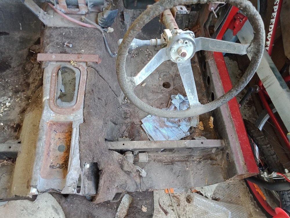

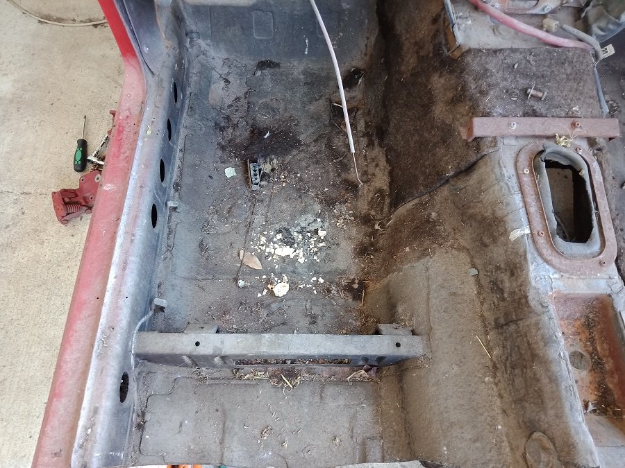

  24. Hey guys Joined the other night after more attempts of fueling my inner fire to start on a well worthwhile project. I bought the car about 5 years ago from a local wrecker. The previous owner of the car was old and gave the car up for retirement instead of trying to sell it. I hassled the owner of the wreckers for months to sell it to me, and eventually he gave in. $1000 changed hands and then it was mine. It's an early vin HS30-00114 with original engine. Unfortunately someone at some stage thought a sunroof was a good idea....not! I stripped it all back to the bare shell and then thought..........what am I getting myself into, the rust! the rust! It then got pushed around my workshop floor for a few months before being hoisted up and hung from the ceiling. Many people walk into my workshop and are fascinated to see it hanging from the roof and always ask if I'm going to restore it. My reply is yes, when I'm old and grey. But now I don't think I can or should wait that long. George's new project inspired me because I saw the rust he had to deal with and I thought, crap, mines not that bad. I just bought the book 'how to restore your Z car', thought it maybe worth a read. (more inspiration) In order for me to get started the car needs to be sandblasted and I need to source rust repair panels. Floors, front chassis rails, sills, dog legs, etc. It seems like the USA is the go to place for panels. I would rather support Aussie business but I don't know where to start looking. I've got over 20 years experience as a motor mechanic and 0 years experience as a panel beater.......no harm in trying.
