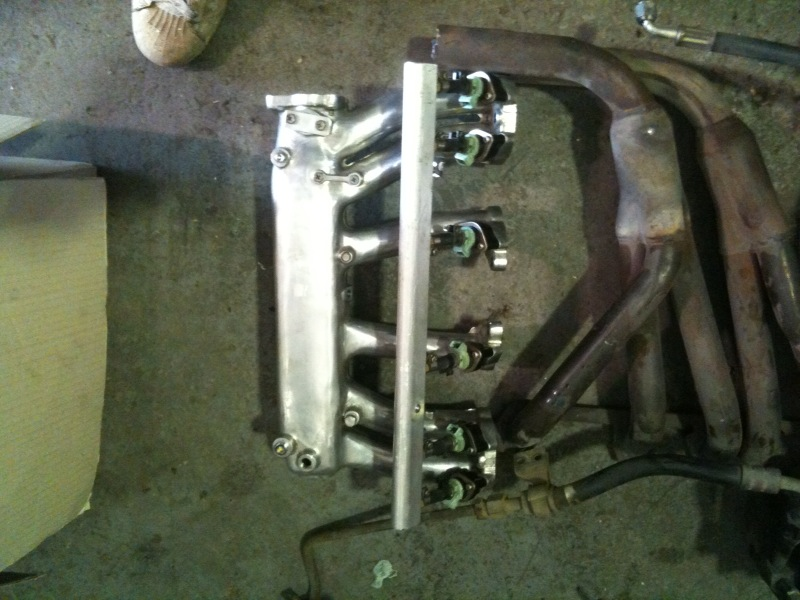

I think he is after something like the unit I have. Looks a like this after a polish and a nice fuel rail....much tidier than std with all the pollution rubbish on it.
