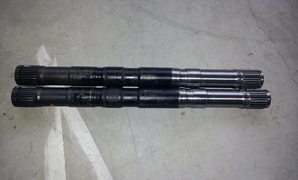

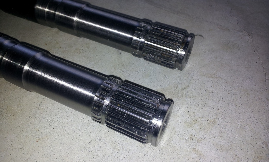

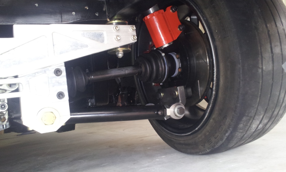

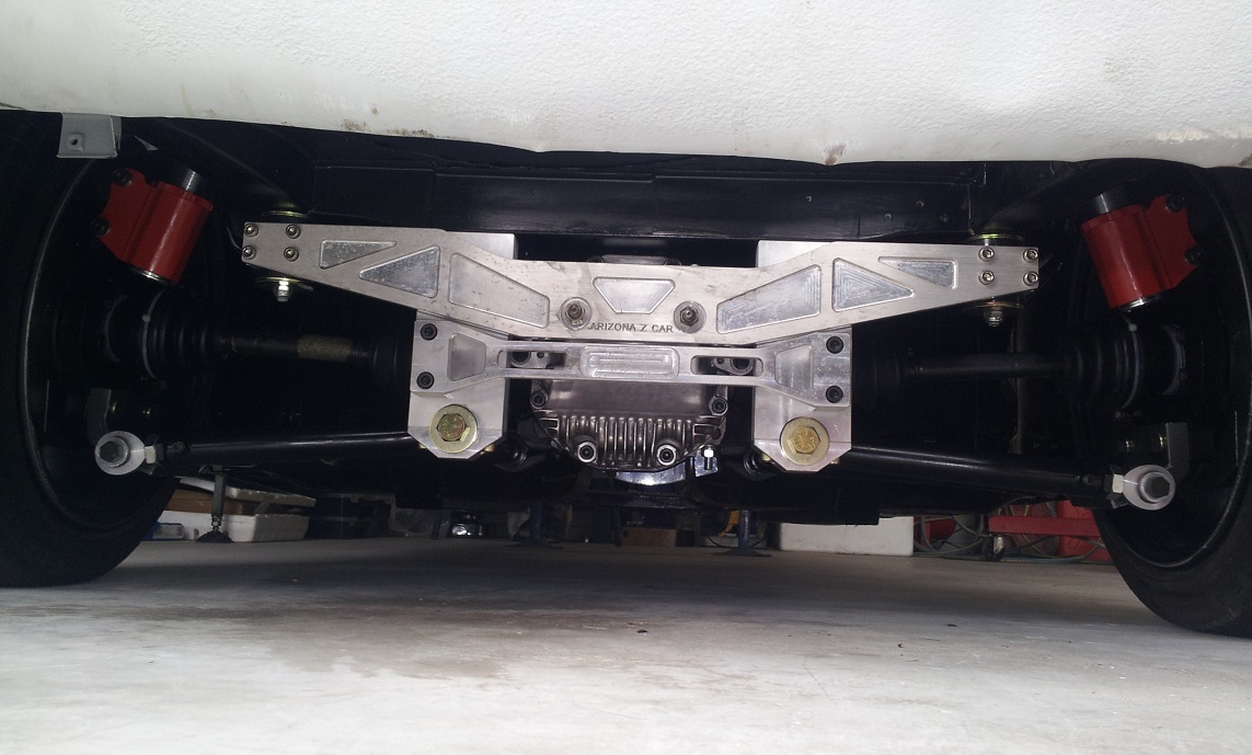

  7. I have a pair of shortened r200 axles for sale. They are r200 axles from 32/33/34 skylines, z32 300zx n/a, s13/14/15 etc. They suit any of the 27 spline CV's from these models and z31 300zx turbo or dr30 turbo etc They will suit an r200 conversion into a Z with companion flanges or aftermarket stub axles etc like thoses from Modern Motorsports etc Please do your research to ensure these will suit your specific conversion. Sizes as follows: 357mm and 367mm long (14 1/16" and 14 3/8" long) approx 35mm shorter than z31 turbo axles 27 spline 30mm diameter Axle shafts only, no cv's. Reason for sale, I decided to go another route. $400 plus shipping, will ship worldwide. Pickup is ok. Location Redbank Plains, QLD, 1/2 hour out of Brisbane PM or call/text me on 0401598047 First 2 pics are of the axles, 2nd 2 are the reason they are for sale.
