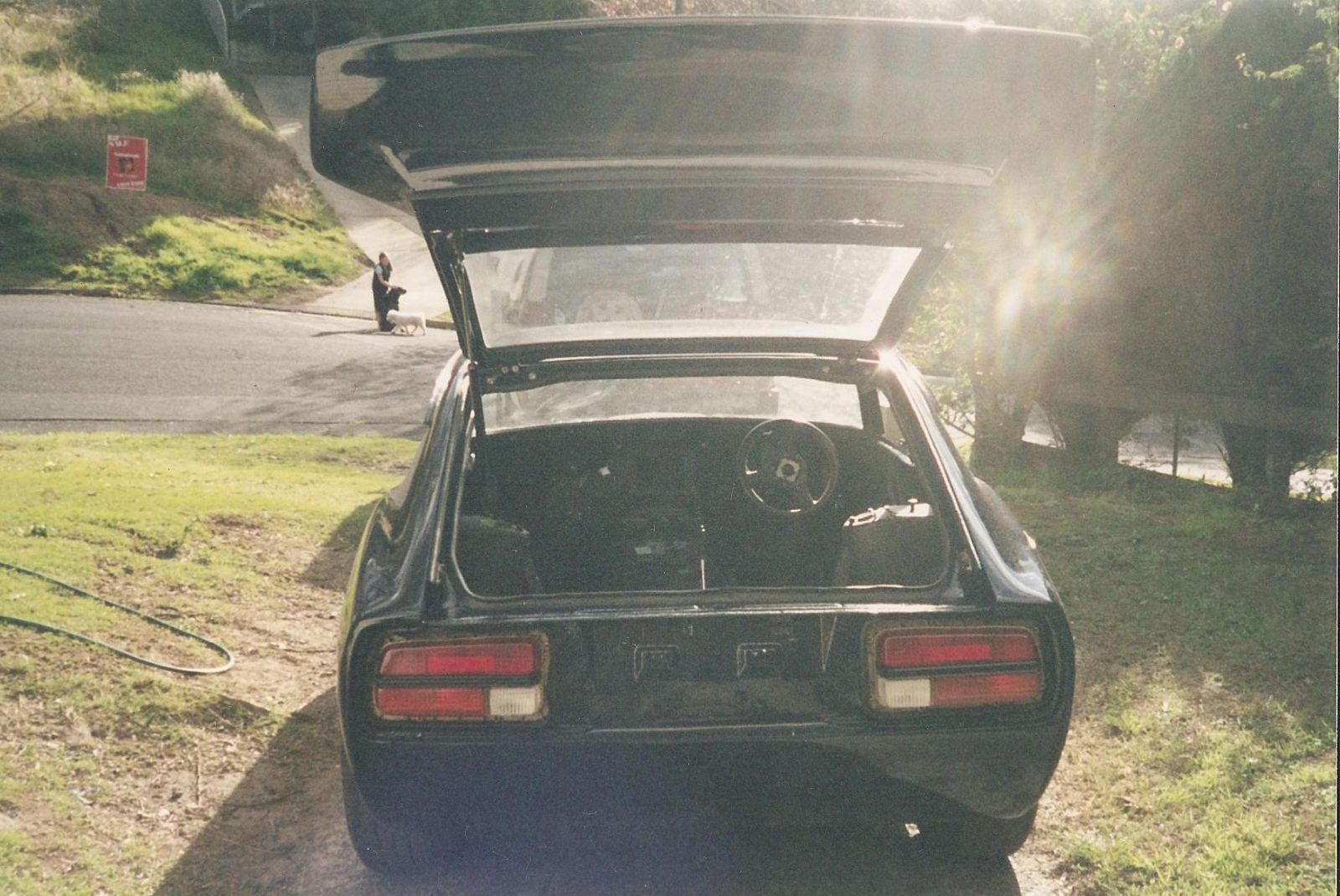

It's important that the back of a Z looks good as this is what most people will be looking at whilst driving. Tail lights were restored very vary carefully. It took some effort to get them apart, cleaned and sprayed white inside so they look brighter when lit. The lenses were very carefully cleaned and dyed with red and yellow clear dye which negates the fading. It took two tubes of tooth paste to buff thoses lenses. At least 2 solid days effort in those tail lights and I got new seals as well.

Did your lenses have hairline cracks? Mine do and I need to repair them. Tail lights are worth spending time on though as after 30 + years they have carbon build up and other gunk. Great tail lights look clean :)
