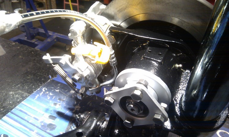

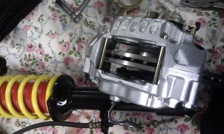

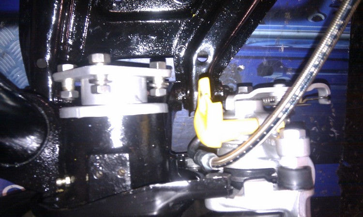

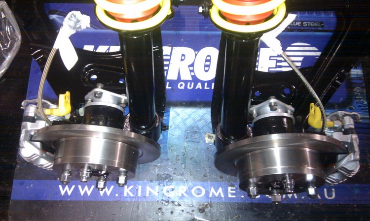

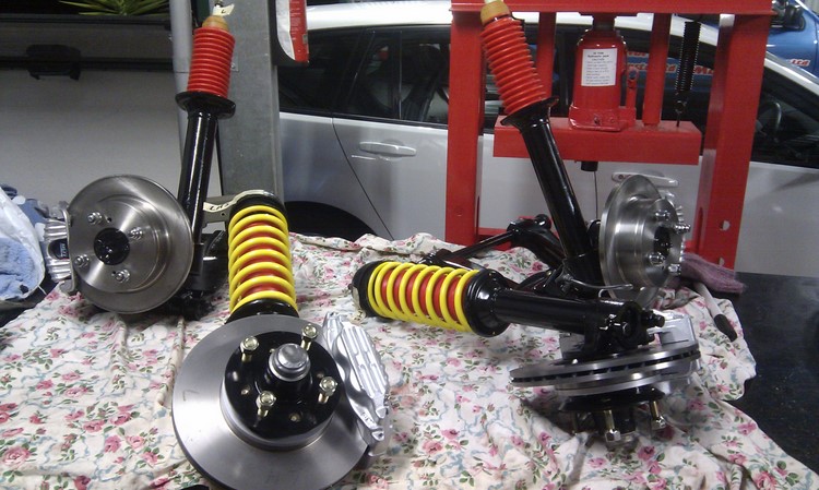

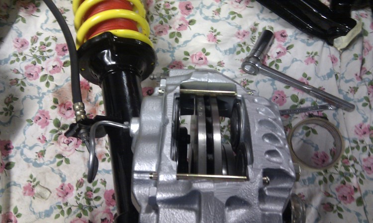

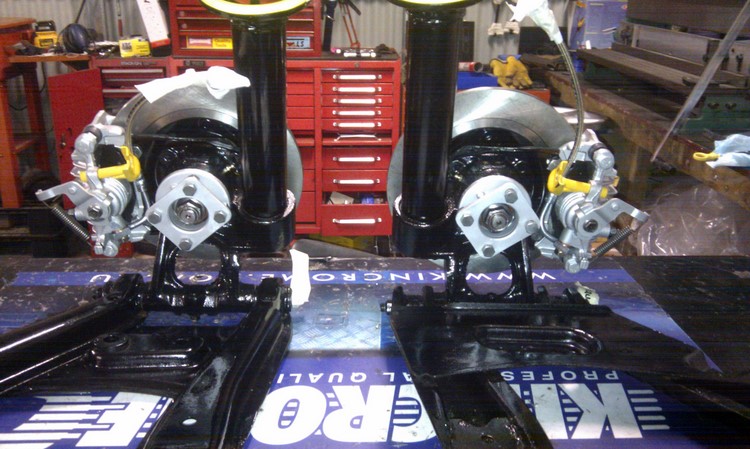

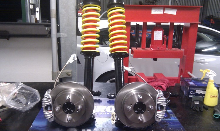

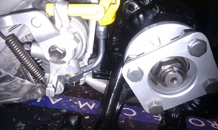

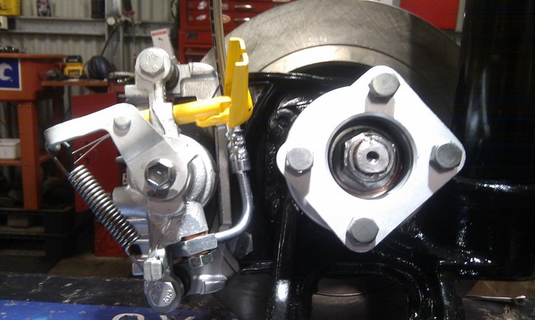

Here are a few pictures of the rear calipers from the R31 grafted on to the 260z 2+2 rear struts.
New parts include
Wheel bearings and seal
R31 disc rotor
Modified caliper bracket
R31 disc pads
Braided lines (custom made) ADR approved with 90deg bend on the caliper
Grease nipple fitted to the hub
shock boots and bump stop
R31 seal kit
paint
and a fair bit of time.
