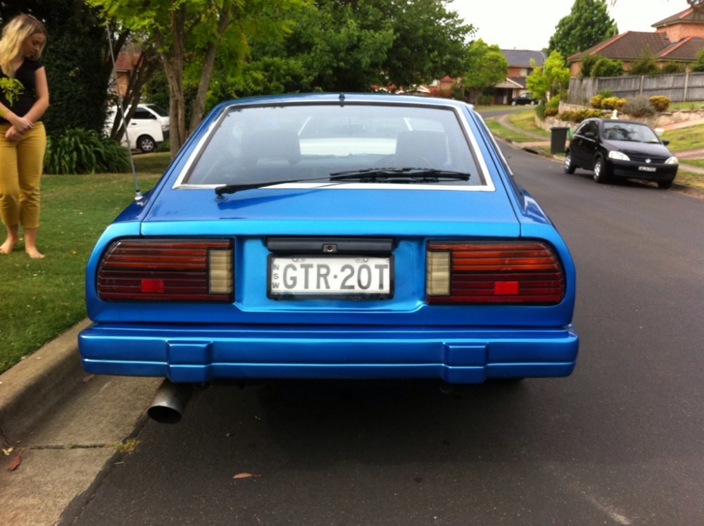

First few little things Ive done to tidy up the car a bit.

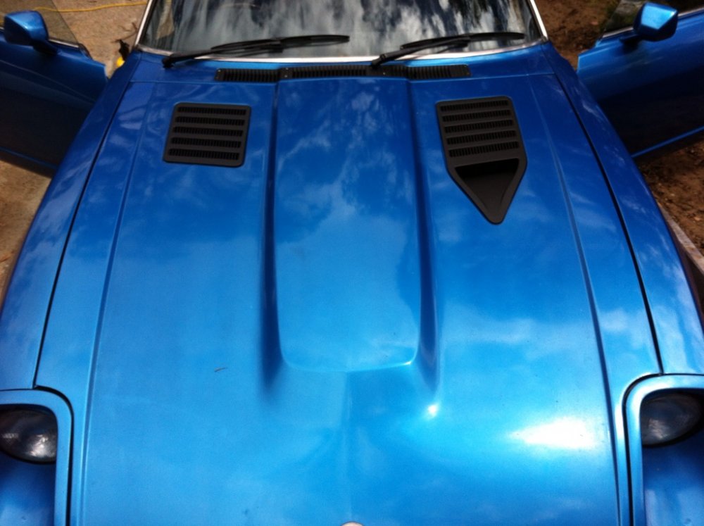

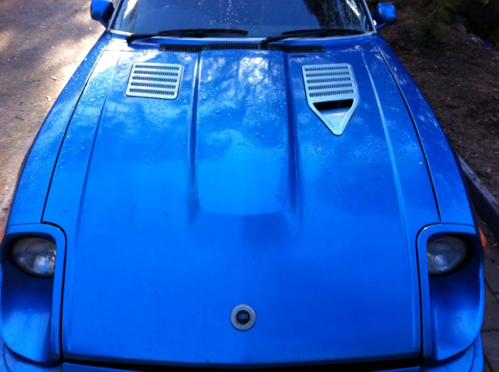

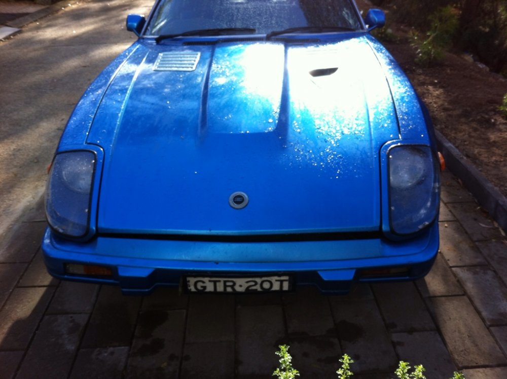

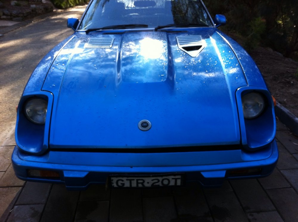

I took off the head light covers, just a personal preference thing:

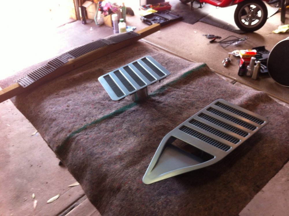

Painted the bonnet vents black instead of super sparkly baby blue:

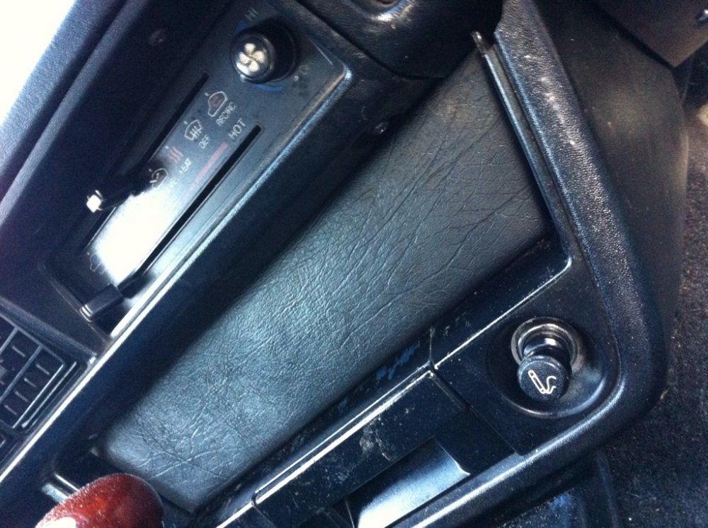

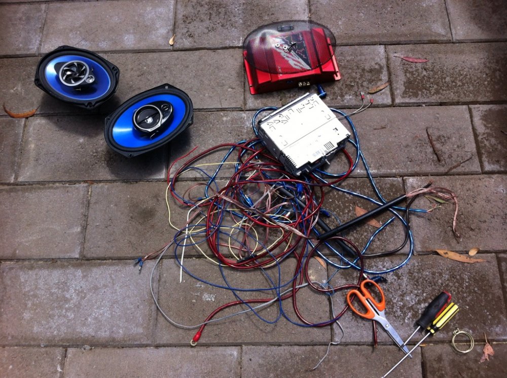

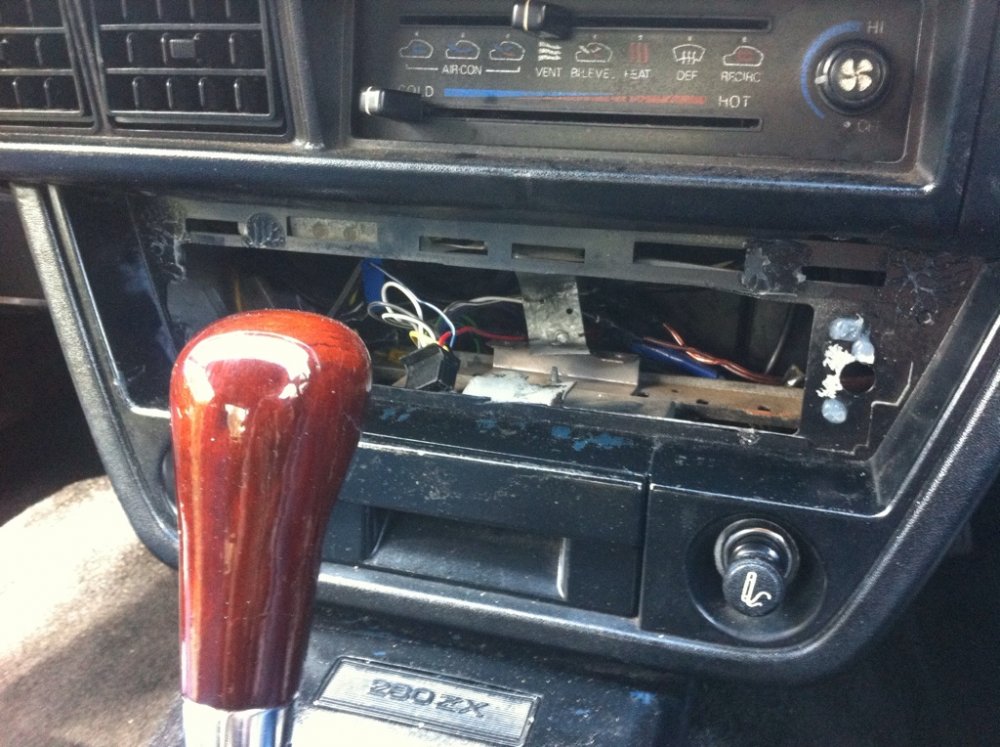

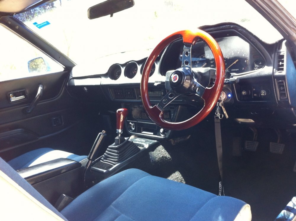

Removed the sound system and all the wiring from the car:

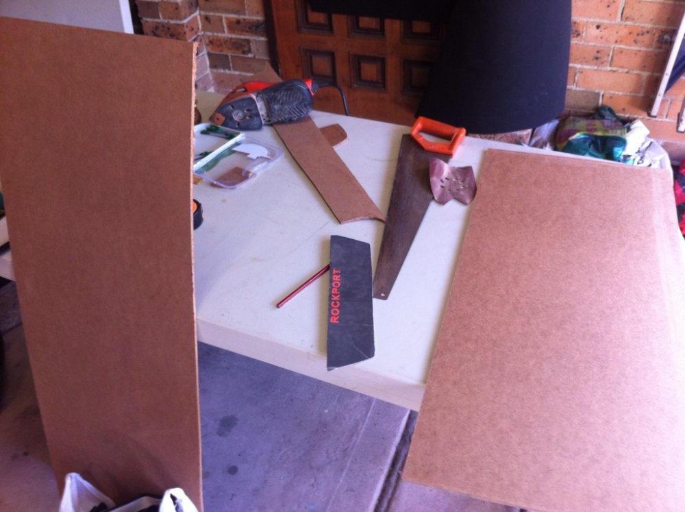

Made up a dash insert to cover up where it had been chopped up for the head unit out of some wood and leather:

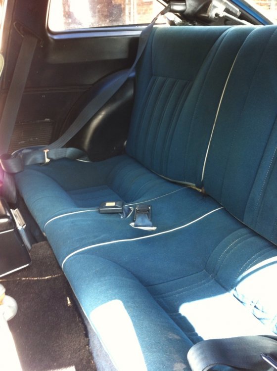

And then cleaned up and detailed the interior:
New wheels are arriving tomorrow, so that should be awesome!

And its nice to see someone REMOVING the stereo!
Aww come on Simon, don't hate on us youngin's, we just wanna feel 'fully sick' while cruising around listening to our whippersnapper beats!
But no in all seriousness, I deleted my sound system too, ZX's can do with all the weight reduction they can get, plus looks more period correct.

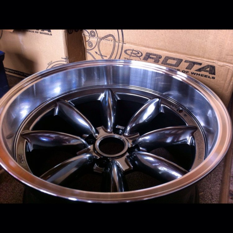

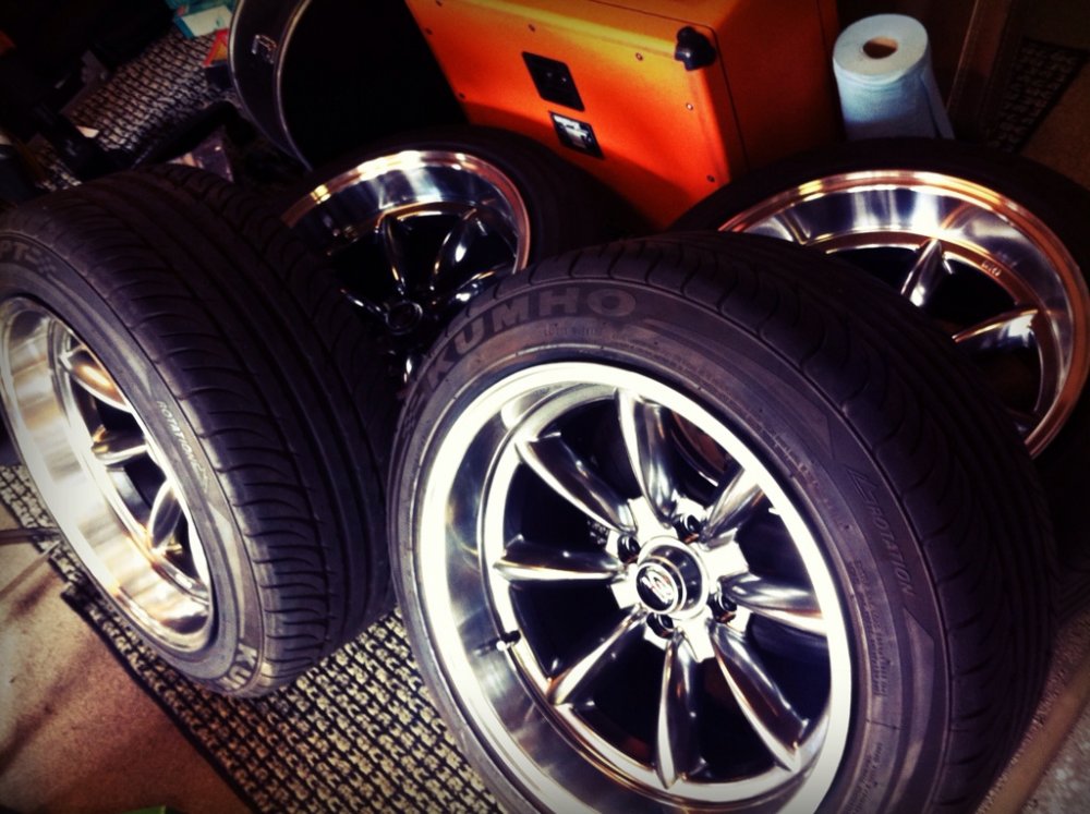

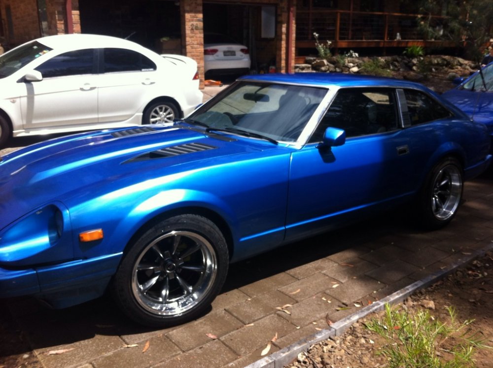

My wheels arrived this morning, nothing original to the z just some rotas but will be better than the positive offset wheels with 20mm spacers currently on the car haha
Ill try and get them on tomorrow and post up a few pictures
The Six Section Mechanical Orchestra!
What Rotas? RB-X's?
haha for sure!
yeah just the usual 9 -13 and 9.5 -19, ive got 225 50 r17 on them for now coz i had a set of KU31s lying around, any idea if ill need flares?
couple of pics
doesnt bother me that a lot of z's run these, i like the look of them haha and i had trouble finding anything else with decent offset
Nah you won't need flares at all. I run 15x9 -14 and 15x9.5 -27 SSR Mesh on my Z, sits perfectly inside the guards at my height. I usually run them with 30mm spacers for shakotan styling but you'll be alright.

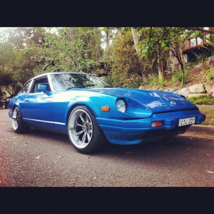

This is a picture of mine before I got defected. Neale Rakers 15x7.5 -41 (5 inch dish) and 15x8 -57 (6.25 inch dish)
You'll be running 5 inch dish and 5.5 inch dish.

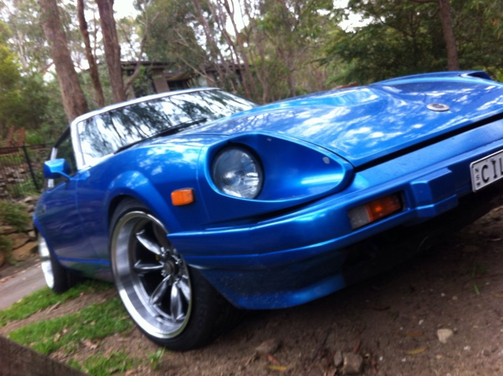

damn your car looks awesome man! ok thats good news otherwise ill just head to parramatta and buy some haha going to fit them tomorrow morning, in terms of lug nut torque setting im going to go for 90nm, this sound right?
Cheers dude, and yeah I go 90nm, although a lot of the time I'm lazy and just go with whatever I weight on the end of my breaker bar (bad practice I know).
I've had a look at fitting S30 flares on the 280 and it doesn't quite follow the arch line as well as desired. Also if you're going with flares only because there's a little bit of poke, I'd suggest putting 30mm spacers behind the wheels to fill out said flares.
This is how much I can get my SSR's to poke with 30mm's, they'd probably just fill a flare.

Ive got the car just sitting on the new wheels at the moment, heres a quick picture.

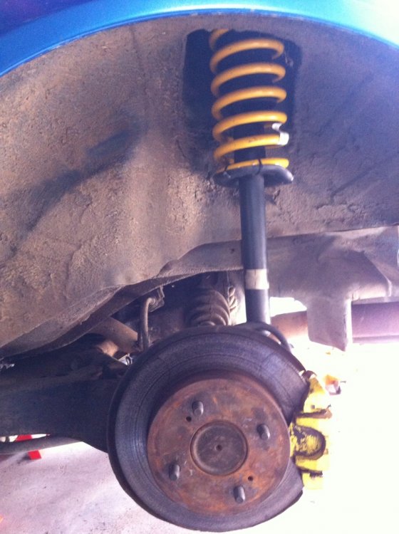

Did a bit more just tidying up today, installed a battery clamp etc just simple safety stuff haha
Picking up new KYB shocks and Aurora springs (30mm drop) tomorrow and Ive also got new studs on the way.
Also going to order all new bushes, so suspension will get a complete overhaul.
