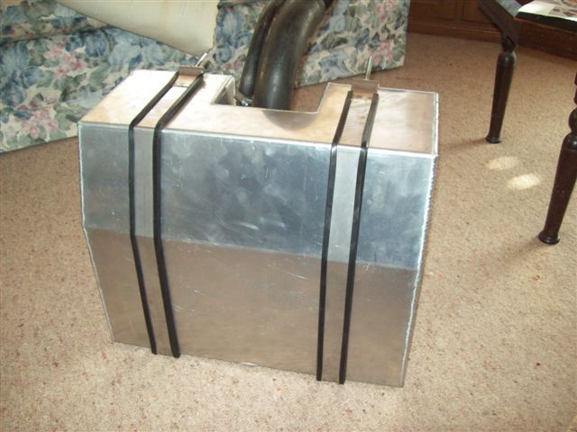

PeterAllen Posted August 26, 2012 Posted August 26, 2012 The chap who made my fuel tank made up a set for me - cheap as chips... $10 I think. Try to find someone on the marine side of things who makes fuel tanks for boats. Depending on the end fittings you may have to reuse what you have. The rubber is available from any rubber supplier in a range of widths. Quote
Whittie Posted August 26, 2012 Author Posted August 26, 2012 Ooh, now they look fancy. I think I'll get the panel beater on to it if it's that easy!! Thanks for the tip Pete, huge help! Quote

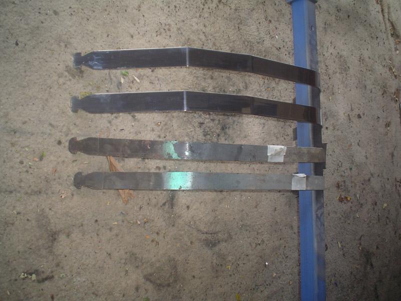

handsandwhich Posted August 26, 2012 Posted August 26, 2012 I made some up using some 40x3 stainless flat bar and bent to the same shape as the originals. Went to clark rubber and cut some rubber strips around 45mm wide and glued them on the inside of the straps. Polished the flat bar to mirror finish and they came up a treat. Not sure about the 'cheap as chips' part as the stainless costs more that $10 just to buy but I guess it's cheaper for a place that just has sheet off cuts 'laying' around. Quote
