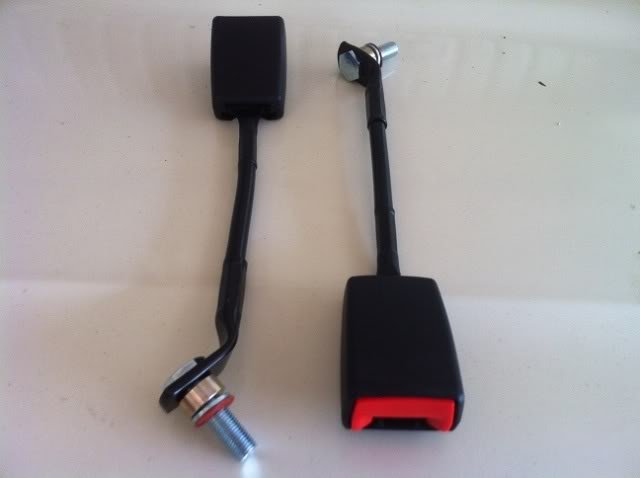

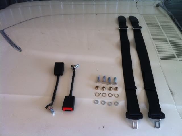

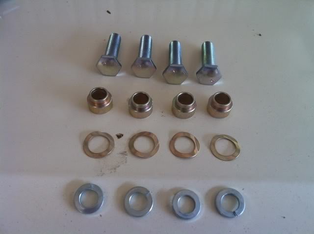

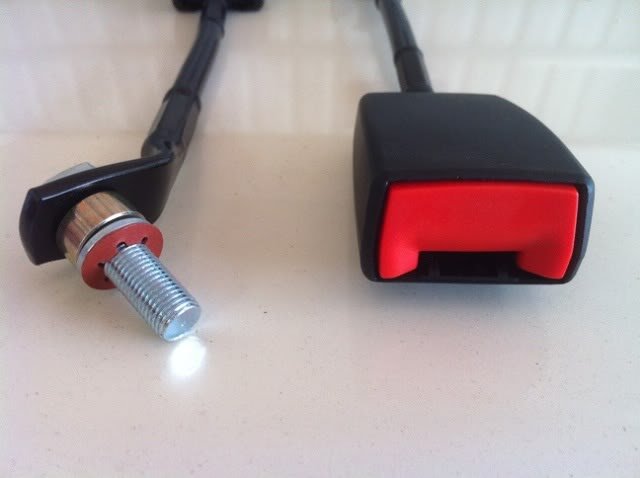

luke240ZED Posted August 31, 2012 Author Posted August 31, 2012 Well I've gone with the HEMCO lap/sash static belt and they have installed perfectly. Both buckle stems are made for left and right specific so they fit spot on. I spoke to Wayne at the shop and he knew just the items I was after for my 71 Zed. Here's some snaps of all the products I received and a scan of the codes for anyone interested. Cheers Luke Quote
